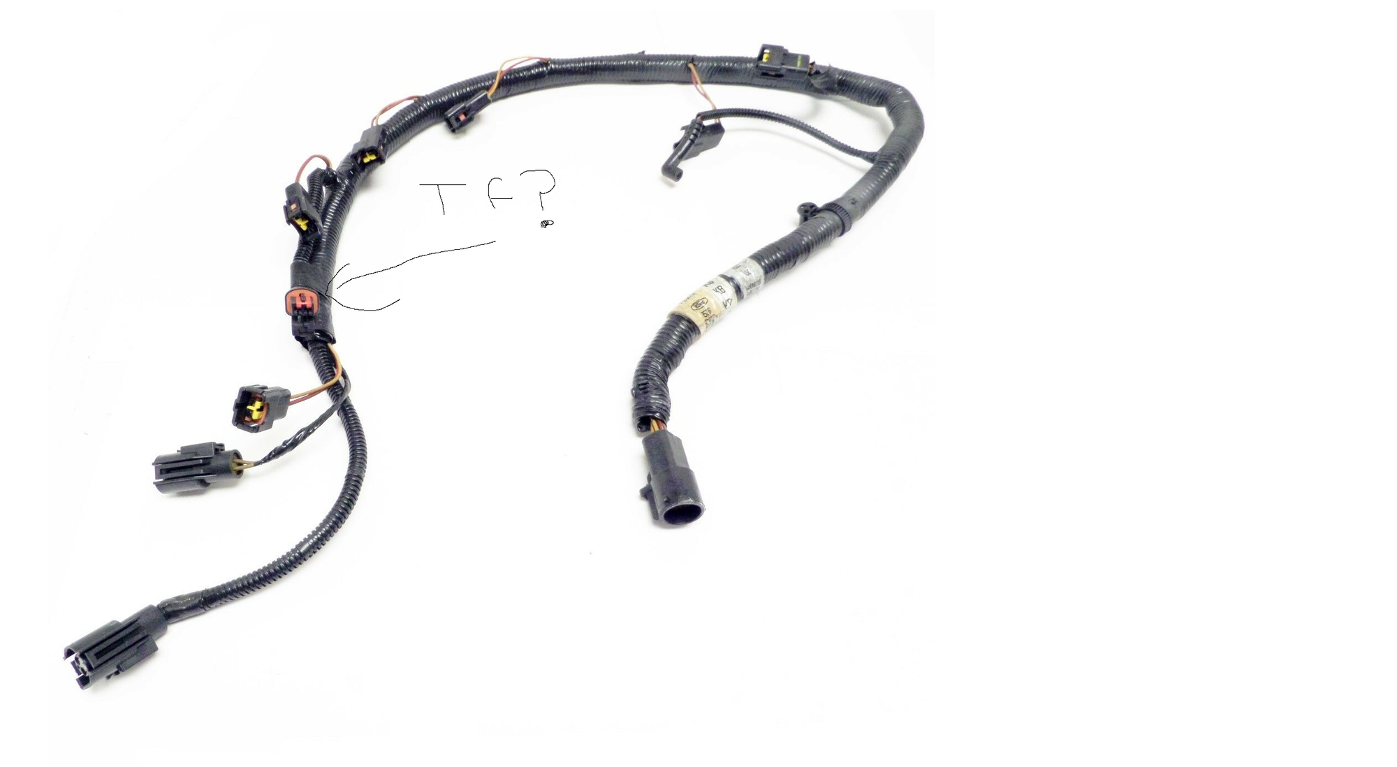

What does this plug go to?
1994 f-150 i6 on injector harness/wire not sure what correct term would be their is an extra wire I cannot figure out where it goes to if anyone has the same truck and could send a pic or just lmk where it is

It looks like the connector for the sensor that crosses over the intake and connects up to the throttle (forks into 2 vacuum lines on the throttle assembly). I could be wrong, I'll look at the truck a little later today.

Canp valve(for charcoal canister).

so I went to the junkyard found said sensor do you have a model # for it the one I found didn't have a number and I think its toast

fyi, it can be off any ford truck, with gas motor
no guarantees, but maybe, one of these #'s
