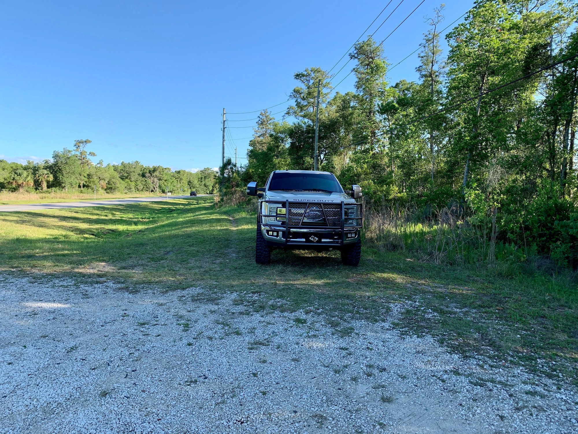

Old Sep 16, 2020 | 04:56 PM
h20camper's Avatar
h20camper
Joined: Apr 2017
Posts: 3,917
Likes: 319
From: Lost in the Ozone....
Originally Posted by lakemarykid
-Curtis-
Thank you for the pictures. Truck looks awesome in the first one. What size tires you running there?
