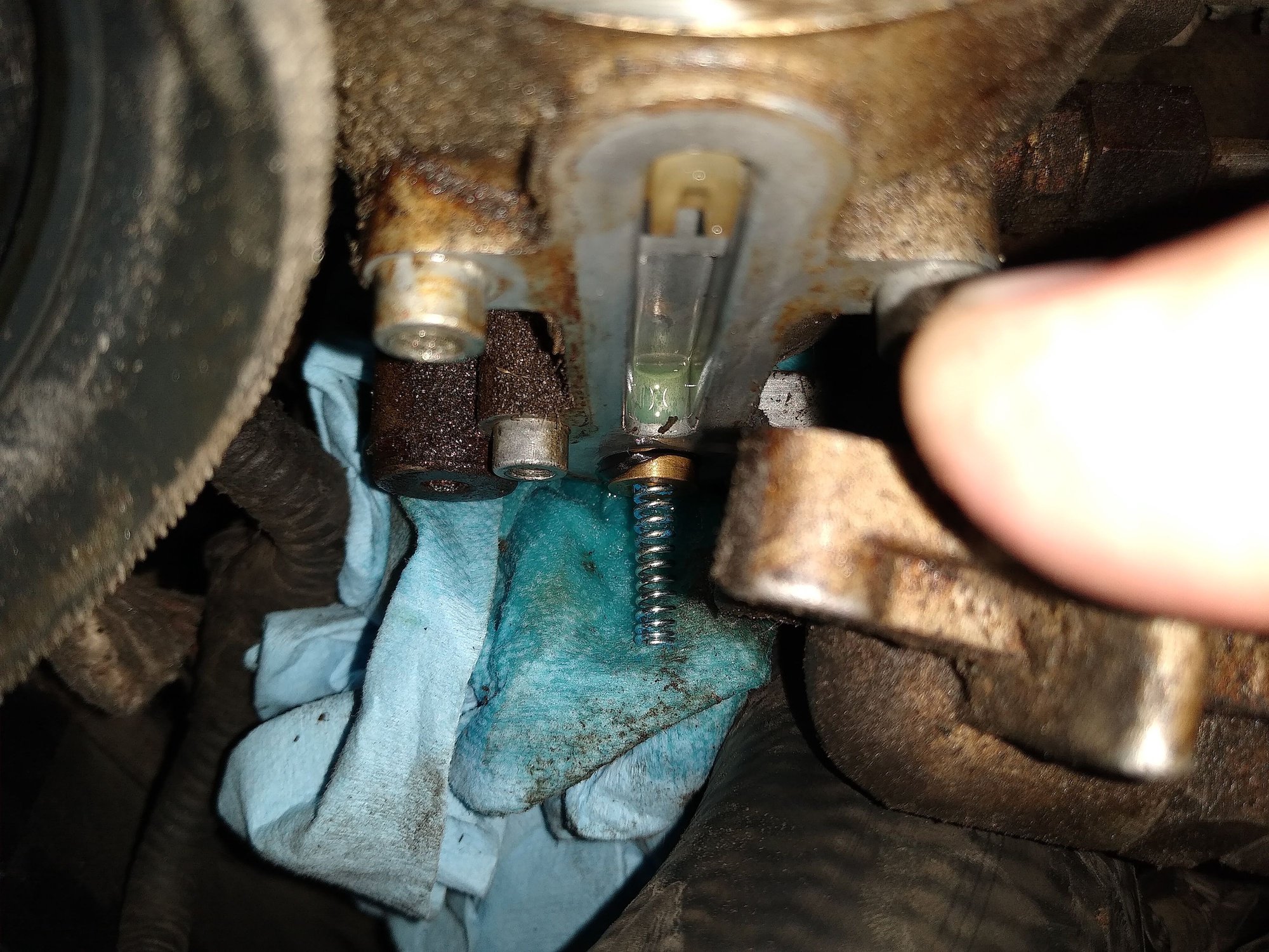

It was on Tow 65HP with an SCT X3. It stays here pretty much all the time except winter to help keep my wife from getting sideways in the snow as much.
Which harness?
Battery light never has come on while I am driving it.... not sure about my wife.
Can you clarify on the plunger? The brass piece that the "blue spring" rides in?

So the RAM code could have been due to the programming rather than PCM voltage ...... maybe.
The injector harness, FICM to injectors.
The "battery light", poorly named, tells if the alternator output is lower then the battery voltage, or if there is excessive AC in the output from bad diodes. You can still have low output from the alternator, which can be due to the voltage regulator, poor brush contact, a poor connection at the three-pin connector on the "sense" circuit, or any continuity issue in the "sense" circuit. Any of the battery connections or ground connections can do that too. Most people post in the thread what the terminals look like so we can assess if there are hidden issues there.
Most of the time the low pressure is not the filters or the HFCM itself, even though everyone not familiar tends to jump on the filters, the least complicated items. The regulator plunger seal that is pushed by the blue or any other colored spring seems to get distorted on the newer production from Motorcraft or any other supplier, most other suppliers. With its history, its where I would go first.

Hey Jack thanks for jumping in, I learned something about checking for the plunger.

Wow thanks for the tip @TooManyToys. Anyone have the seal number?

Probably will have to buy whole spring kit. I would anyway if possible.

I reinstalled the damaged one after fixing the gasket and pressure readings were constant 68-72psi as I was not sure how soon I could get a new one. I found one in a town 30 minutes away and picked it up the next day. After installing the new assembly the pressure readings are maxing my 120psi gauge out (not sure if the pressure sensor is 120psi or not). Hopefully tonight I will have time to make sure the spring is seated in the pocket. If it is..... any ideas on what else could be causing such high pressures?
