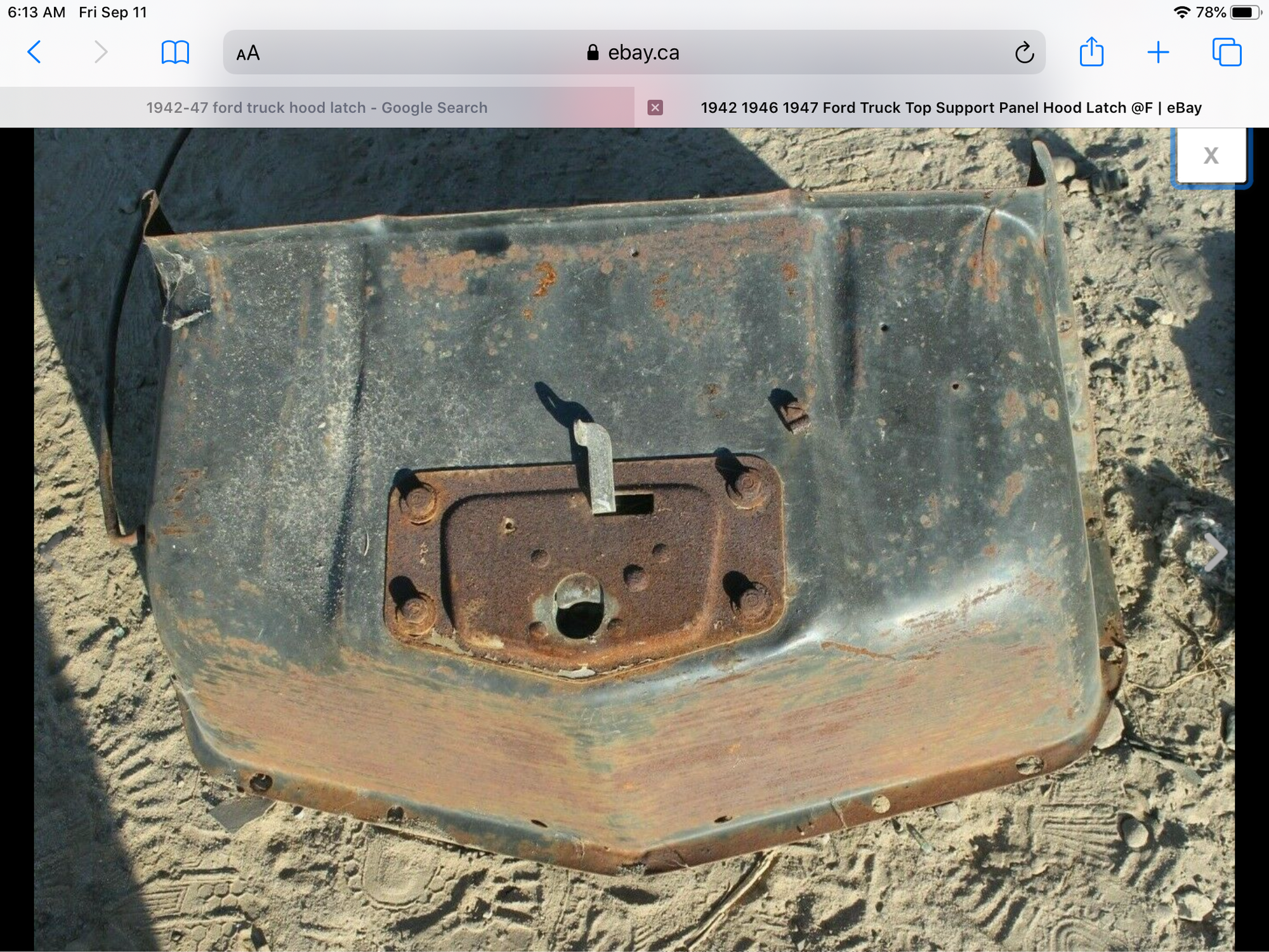

I just bought a 1947 Mercury 1/2 ton truck and it’s missing a few parts. I am wondering if the hood latch panel is a different size in the 1 - 2 ton trucks? I have a few 48-52 trucks. This is my first pre 48 truck. Doug.

hi ! i would think the latch is the same from 1/2 ton up to 3 ton. the picture you have is not a 42 to 47 model latch.

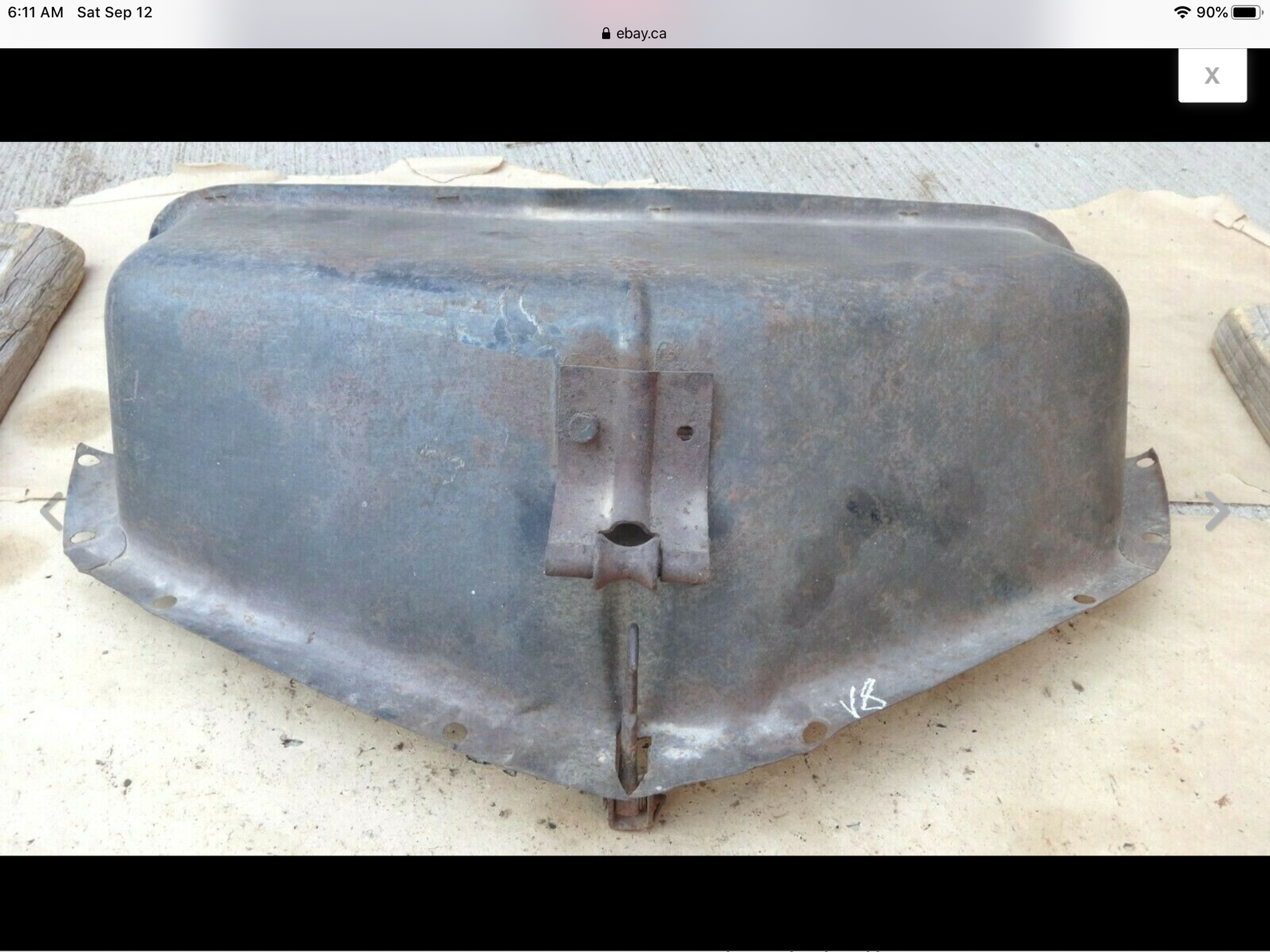

Thanks, the picture I got off of eBay. So it should look like this then? Doug.

yup thats the right one

Also, be aware that there were 2 types. There is a shallow one used on 6 cylinders, and a deeper one used for 8s. I believe all Mercs were 8s. The one pictured is for an 8.

Thanks. Definitely an 8 as ford never sold any 6cylinder Flathead’s in Canada. ,Doug.
