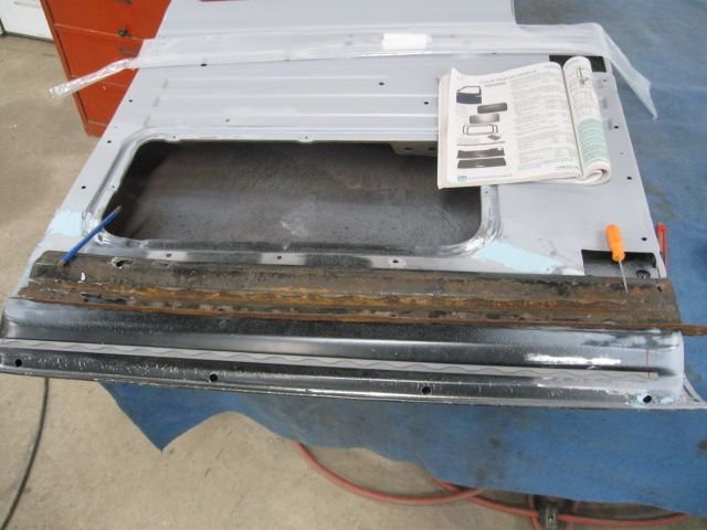

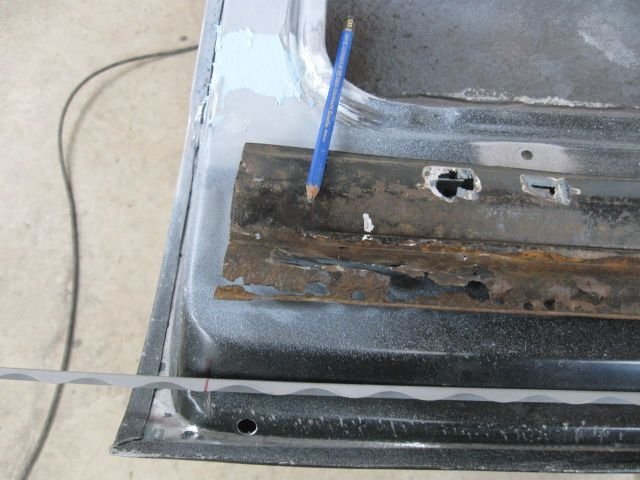

These were taken last year. I'll try to remember. That rusty piece is off the old part of the door. You can get the instructions from Mid Fifty (PDF) which tells the measurements. Seem like I marked it with the red marks. I also put the orange handled ***** punch and blue pencil i think...
You should be able to see better and read what I did I can't really remember. Check out the below basket case build.
Hope this helps.

At the factory, these strips were spotwelded to the door without the benefit of primer or paint in the joint...bad place for rust to take hold. Personally, every door I reworked got these strips removed and replaced...inexpensive insurance for the future. Here is what my doors looked like before installing the painted strips...
