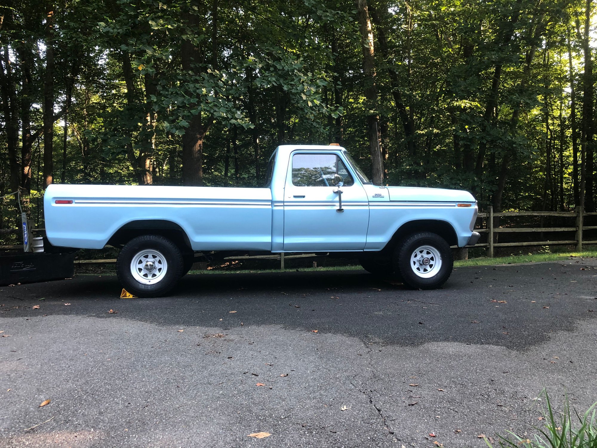

I plan to do some body work on this truck and put a nice, two-toned paint job in it, however, there is a slight misalignment between the bed and cab on one side (see photo)
this new paint job will split at the “dent” and will accentuate the most-alignment
any suggestions include how to fix
Notice cab slightly lower than bed

Are your rubber body mounts shot?

yes the mounts are in bad shape

Yep I had this issue on a 1970 f250, and new cab mounts cured it.

cab mounts it is then. I had that on my list to replace anyway - was thinking the frame might be racked and causing the problem

After your cab mount replacement often the bed will be too low. if this occurs you can shim the bed up with washers just like the factory did.

Anyway, if you haven't crawled under your bed and closely looked if your bed has spacers (large washers) between the bed cross member bolt holes and frame, as my 77 F-150 has, in case you maybe able to remove some to improve your contour lines alignment. This might be a possible interim solution until you can replace your cab mounts.
