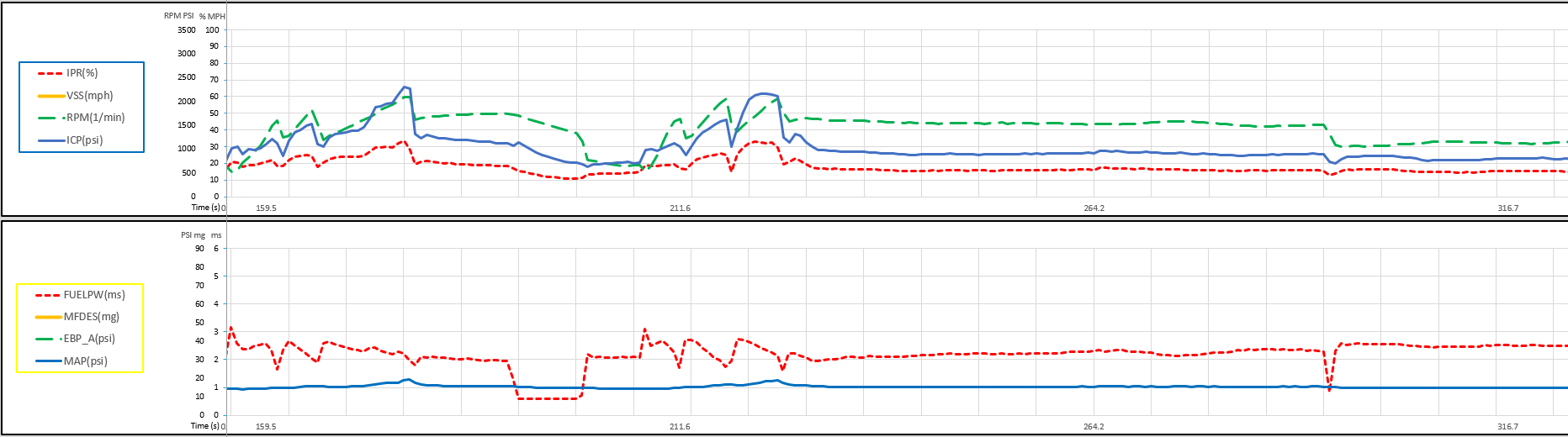

I asked him to send me a PID data log file so I could chart it and post it here for the community to pitch ideas out.
When the ICP was plugged in, he would receive an intermittent surge condition. When the ICP was unplugged, he did not receive the surge condition, I think...

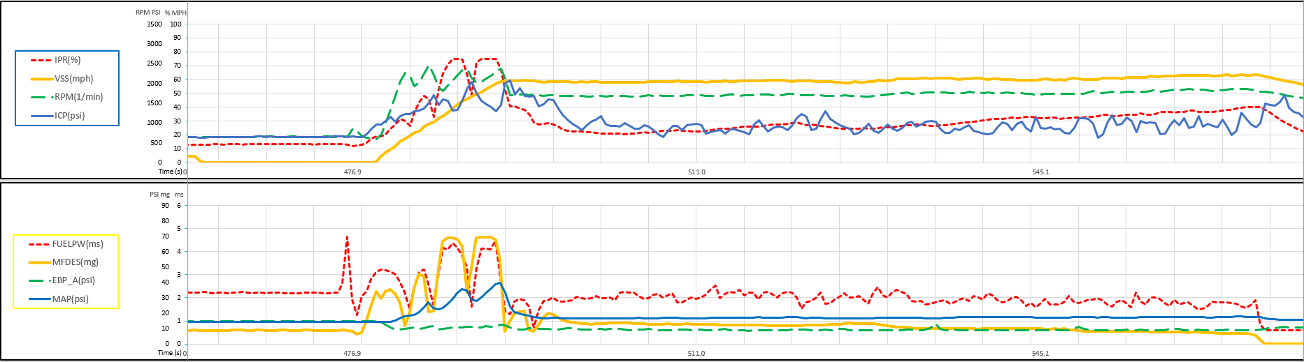

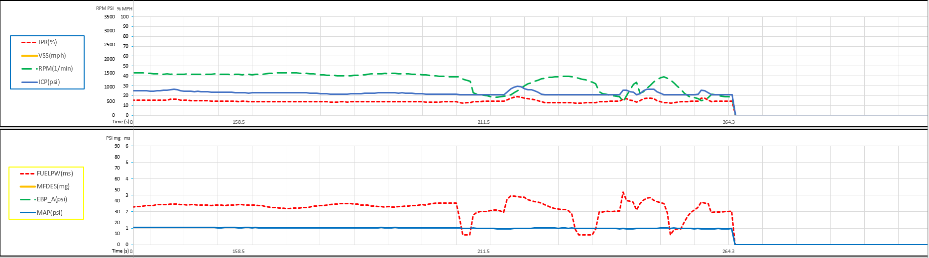

I have attached two PID Charting Tool data files with the charts completed. Their titles are named appropriately for the condition observed by Wesley.
In addition, I have taken some screen snips for those that are interested in seeing the PID Charting Tool in action, but do not have MS Excel or access to Google Docs, Open Office or another xlsx file viewer.
Surge condition chart...
No surge condition chart...

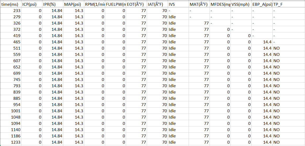

@Wes444 sent me an email this morning with another FORScan data log and a comment, which I have pasted below.
Originally Posted by Wes444 via email
Lot of surging and nearly bucking around 507-697 seconds. Everything looked good but ICP jumping all over the place
Below is the portion of the raw data log including the time stamp Wesley specifically identified.
Based on the raw data log, I suspect Wesley misidentified the time stamp of 507-697 having an issue, but I will let him expand on that further.

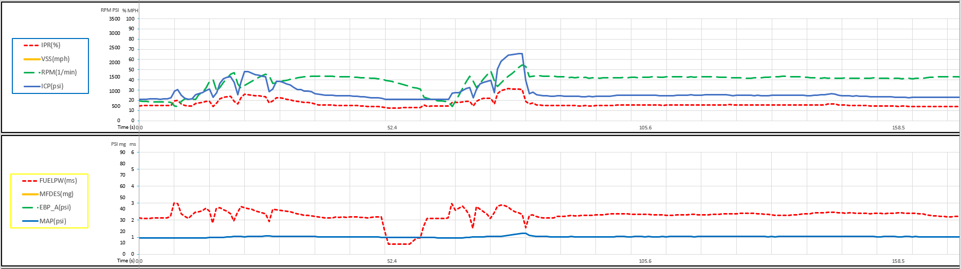

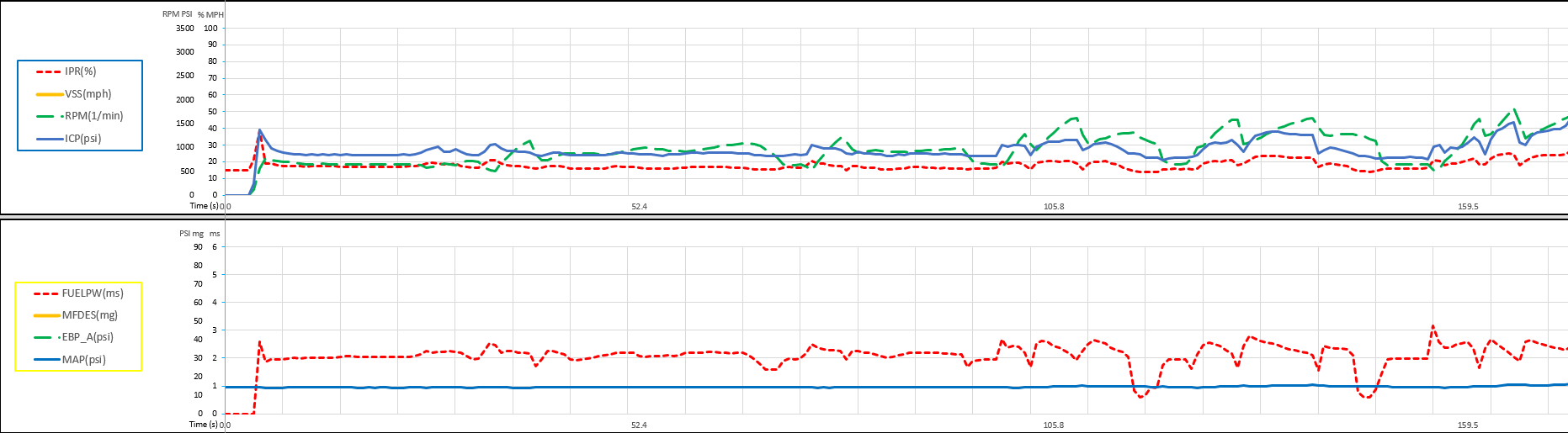

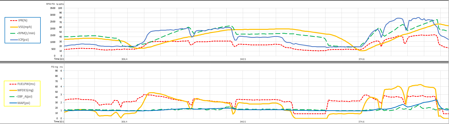

I have attached the new PID Charting Tool output for anyone wishing to take a look at it.
Below, I have also provided some snipping tool images from the chart. Upon immediately opening the populated chart, I saw the ICP is all over the place. I mentioned to Wesley last night via text that he needed to use the first ICP PID in FORScan, and I thought perhaps he selected the wrong ICP PID, but upon further inspection the ICP is steady in some places. So, I will post up a few snips of the chart where the ICP is out of whack a bit and let people see it for themselves and Wesley can go from there.
Notice the FUELPW is erratic as well, as you can see below.
Smooth running...
Not so smooth running...
More not so smooth running...
The FUELPW and ICP continue on like this until toward the end of the data log session, where it smooths out a bit to normal. This is viewable in the attached chart.

That looks like an ICP sensor failure to me as well. It was not jumping out to me on the "Surge Felt" log, but clear as day in this one.
