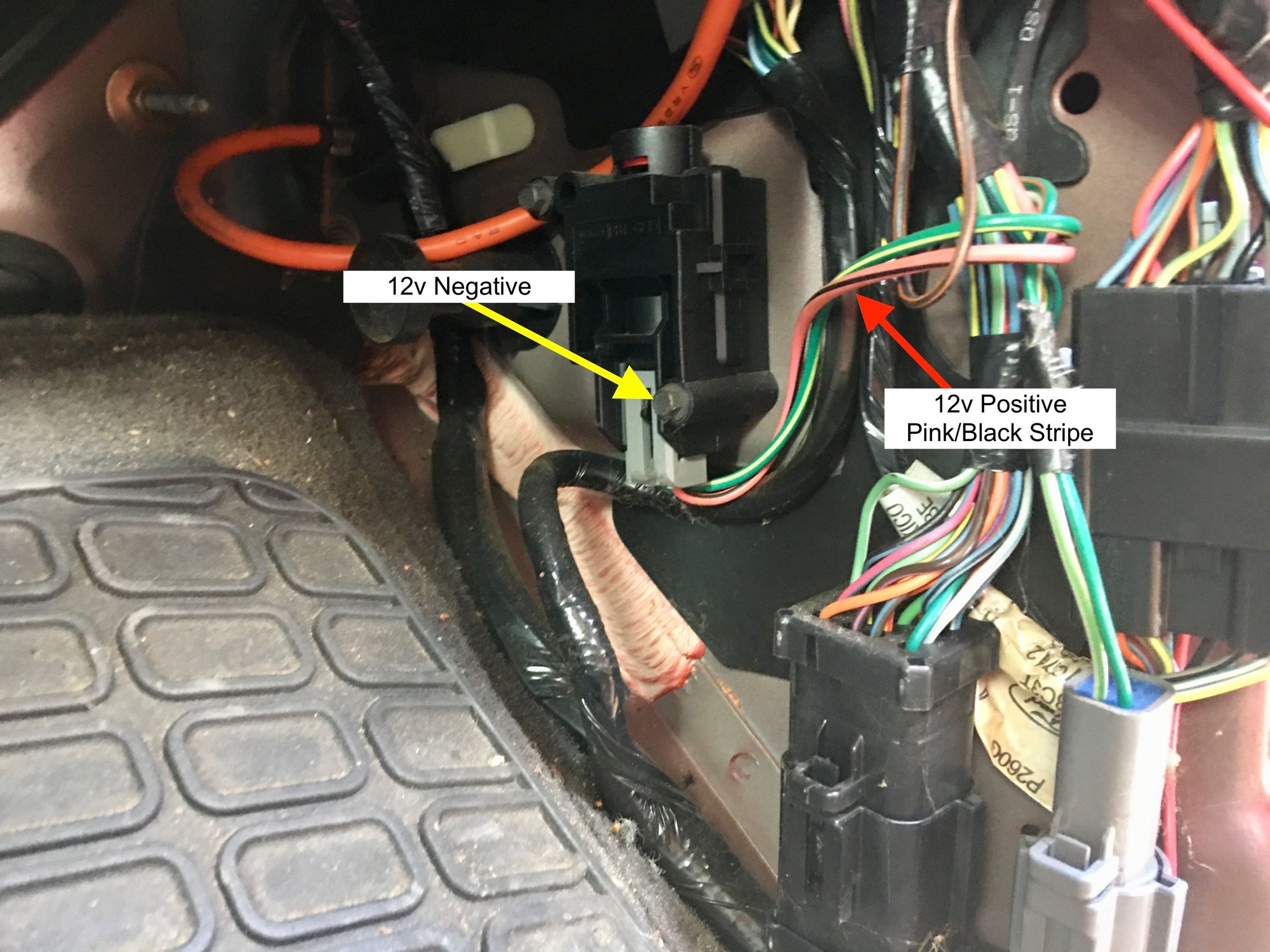

If you have resistance at the relay, taking a reading without any load may show full voltage giving you a false sense everything is working fine. The better approach is to take a voltage reading at the inertia switch at the passenger foot area with the pump connected. You can back probe both sides of the connector to confirm the switch is not triggered and is working properly.

I took a couple short lengths of wire and pushed one into the back side of the connector to make contact with the wire/connector and plugged it back it.
Set my voltmeter to 20 and my wife turn the key to "ON" while I checked each wire independently.
The voltmeter read ~7.1 volts on both wires. I'm not sure what the voltage should be here but it isn't zero so there is continuity.
The red "button" on the top of that inertia switch looked like the one in your picture and didn't feel like it could be pressed in - so that plus the fact that I saw the same voltage on both wires leads me to say that the switch is working. I would also say that the relay is working since there wouldn't be a circuit if the relay wasn't closed.
