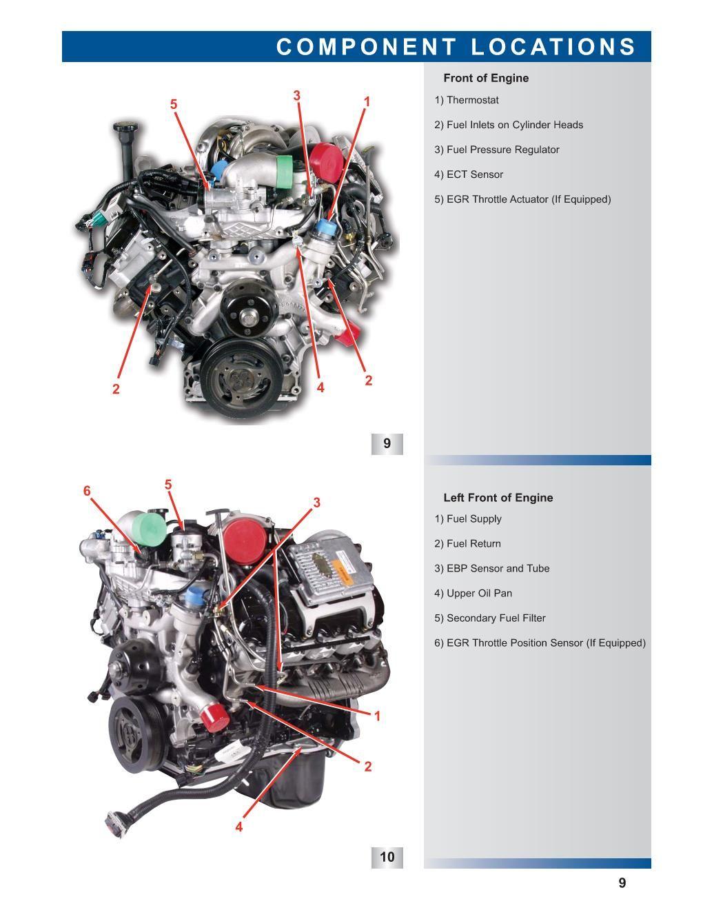

Looking at the diagrams & pictures it sure looks like the ECT is seeing the coolant temp off the block before it's mixed in the thermostat?

The oil cooler and the engine block are fed the coolest temperature of the coolant. The ECT measures the temperature out of those. When the T/S opens fully, the recirculation of warmed coolant to the water pump is closed. The ECT sensor is positioned to always read the hotter EC, we have no idea once the T/S is in fully open position what the colder coolant temperature is in my understanding.

I agree, I was off on the ECT position - thanks FiveOJester! The coolant discharged from the water pump will be a blend of cooler coolant from the radiator and the recycled warmer water. That said, the "cooled and circulated" coolant (at some temperature below the measured ECT temp) is fed directly to the oil cooler (ie it is the coldest point of the circulated coolant) - which was my main point.
