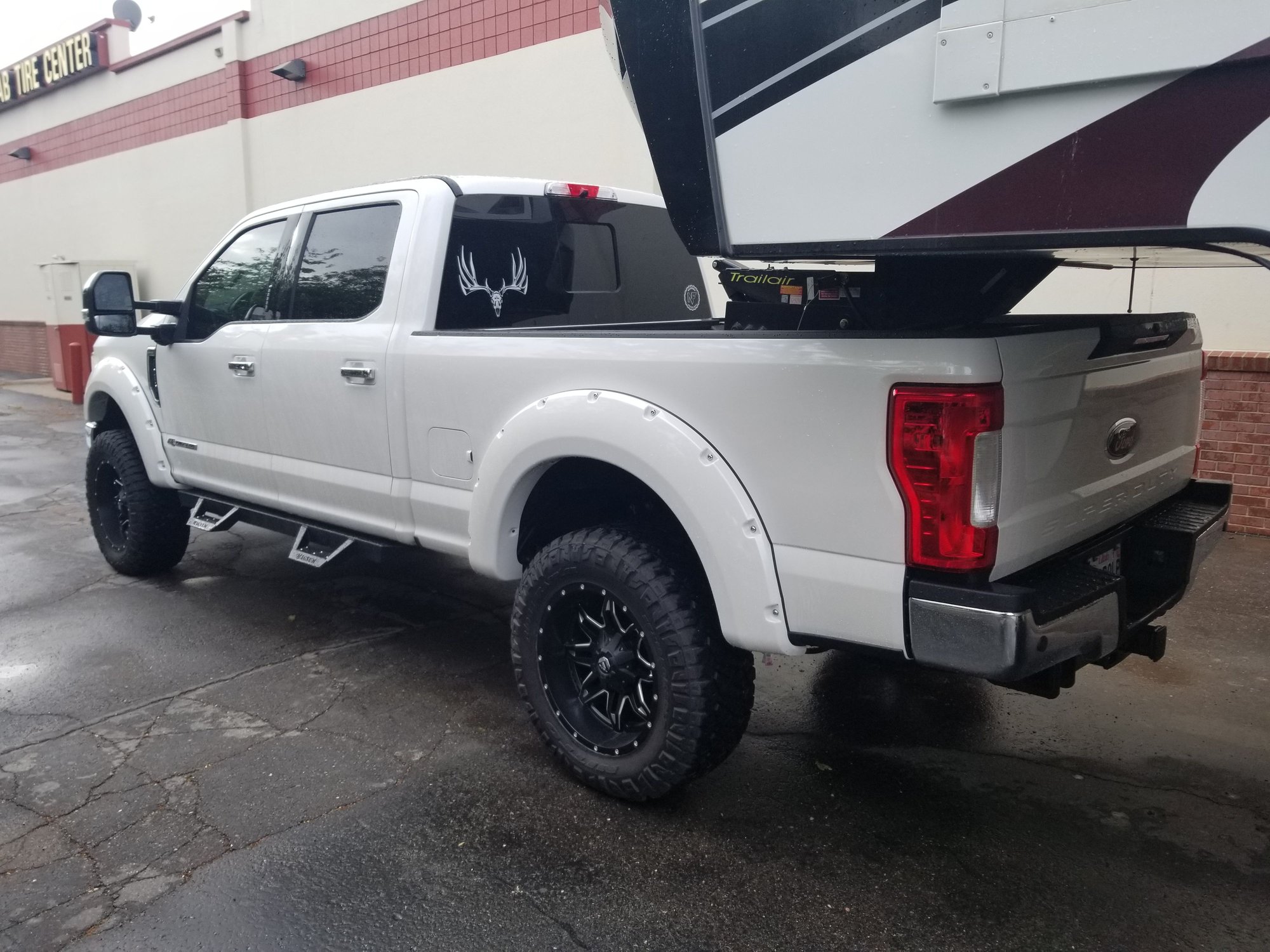

For book: It was a long chase of which I spent a LOT of coin going after a truck to my comfort zone of safety and performance.
The saga started when I was led astray by a dealer only buy of an Arctic Fox 1150 which hit the scales at 5770 lbs and the said: No you don't no dually and F 350 will do: so before I bought I had to go find a F 350 and I did, max out with heavy duty everything but a dually. So I had to replace tires then add stableloafds and the chase began.
After 4 more F 350's I kept doing the same thing expecting different (better) results...Stableloads, Big Wig sway bars, better tires, I even tried air bags once (KNOWING the only thing they do is level and at least I had that requirement to fill).
So how did I make the jump to a F 450: Talking with several guys on here (thanks Y2KW57 and a couple of others) that I could tell knew there stuff. They allayed my thoughts on the sometimes lower payload rating of the F 450 Vs F 350. Fact is the F 450 weighs more because you get more, but there is an artificial ceiling at the 14,000 lb Govt drawn line in the sand where you cross over into another level of truck that may turn into a commercial vehicle with its CDL, Insurance requirement, taxes etc. Bottom line is when you run the numbers and subtract the weight of a heavier truck vs lighter you reduce payload, even tho reality is you have more capability in the heavier.
In the final analysis I have more truck in spite of the paper numbers and so far I have not had to add any stableloafds or better tires and sway bars.
It takes me back to the day I swung my leg over my first Harley after Yamaha/Honda (great bikes) but by the time I rolled into the street I understood why Harley.
The take away for me is if I had ONLY known then what I know now I would have never bought a F 350! If you are going to play in a world where anything that you set in the bed of your truck is going to cost more than 4000 lb or a big 5'ver the F 450 will save you money and mods.

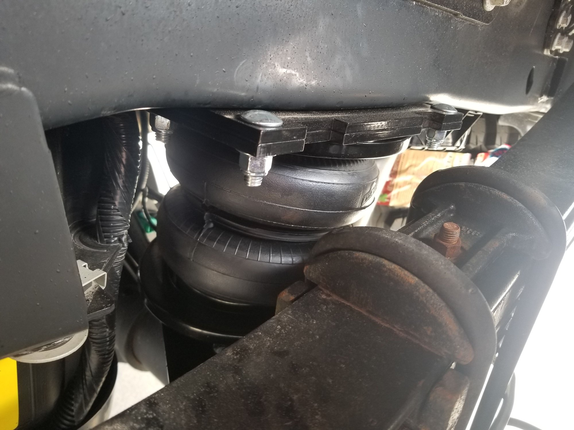

Air Bags all day long. What is your measurement between your bed and the bottom of the fifth wheel? Looks way too close.
I'm 2" leveled with 7,500 lb Automatic Air Bags and a 20K lb 5th Wheel. No squat whatsoever. 6.5" clearance as well.

My personal favorite system.

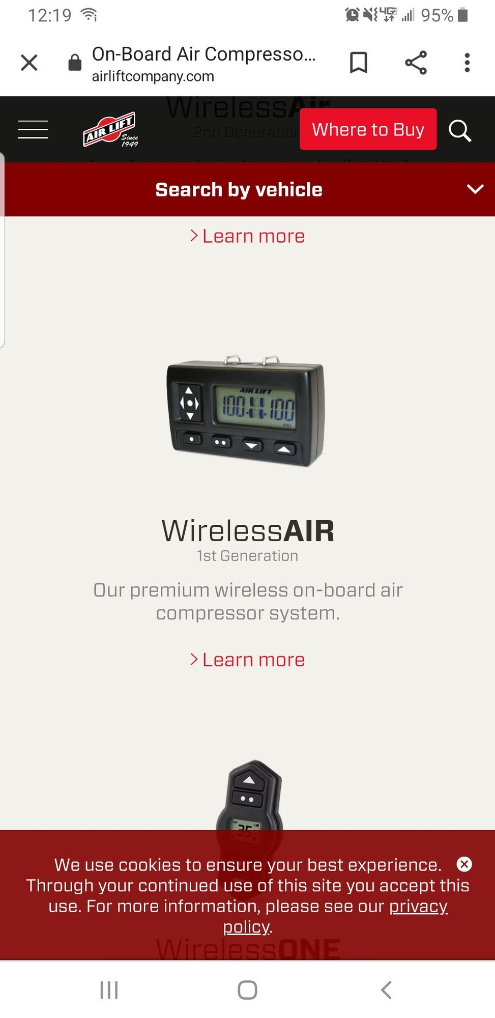

OP airbags are the answer. I've got a 14k 5'er that squats mine just enough to raise my headlights. I haven't measured it but it can't be more than a couple of inches at most if I had to guess. Ride is fine as is stability.
I'm still trying to build out my system to include oba, bags and the controls in the cab. When I have spec'd them out its not much more money to go oba instead of just bags/compressor. That is my line of thinking especially when you remove the need of a portable compressor you can add that back into the cost of the oba.
