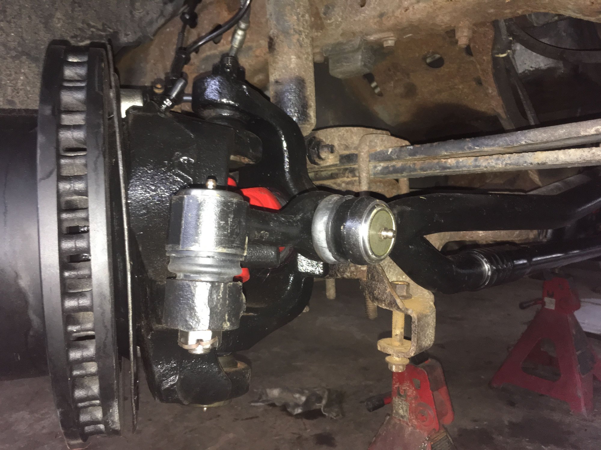

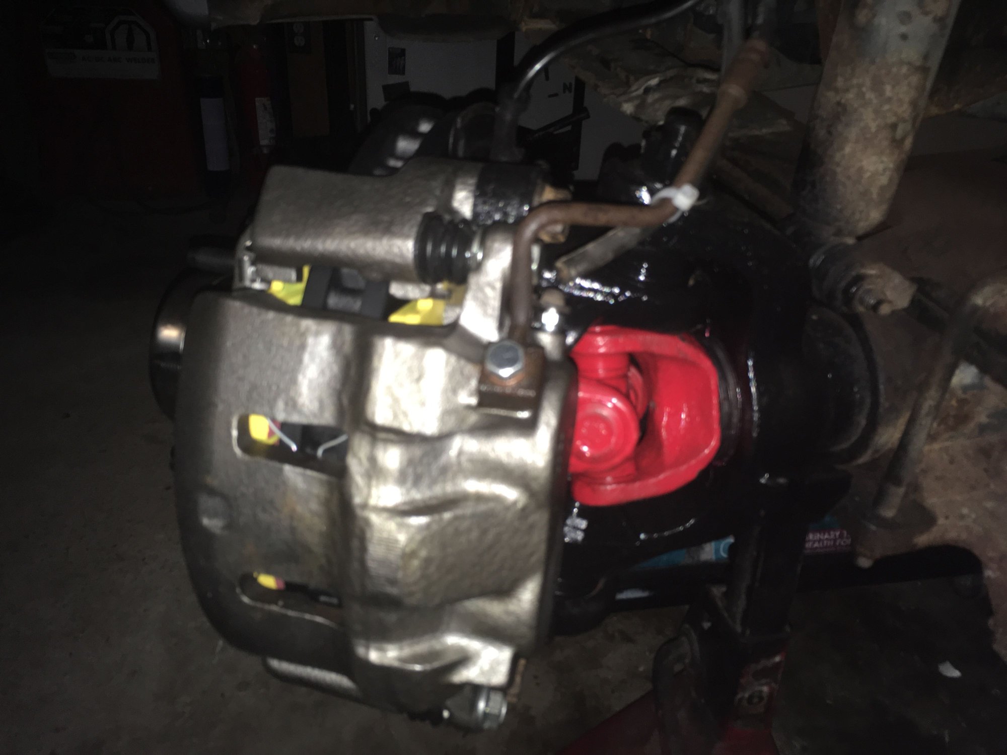

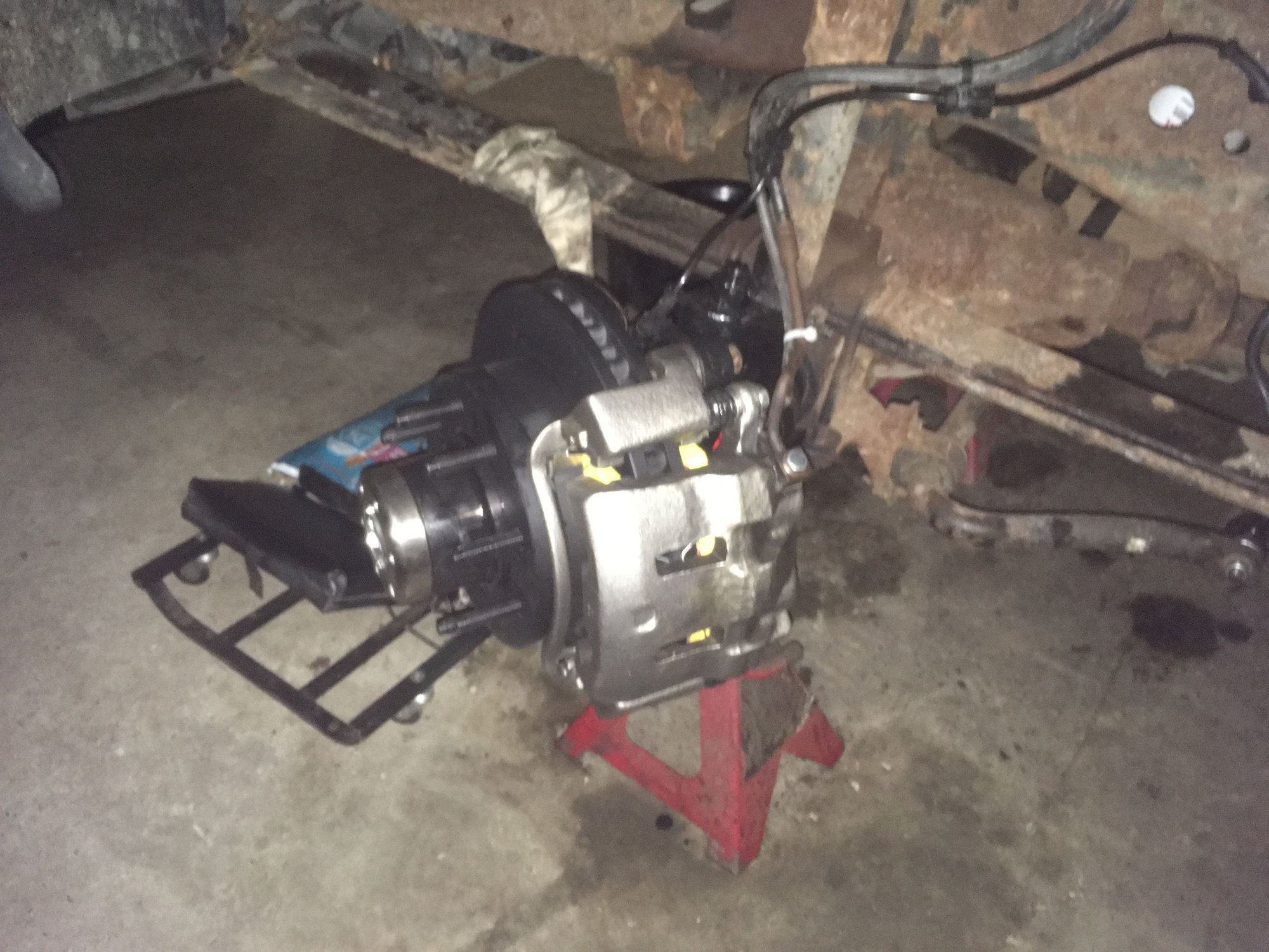

I like XRF Ball joints and steering stuff. These are Detroit Axle unit bearings (filled with grease via the ABS sensor hole). These calipers and rotors are autozone, but I’d recommend ‘lifetime warranty’ rotors from NAPA. The EBC Yellowstuff pads are the best stopping power you can get.
