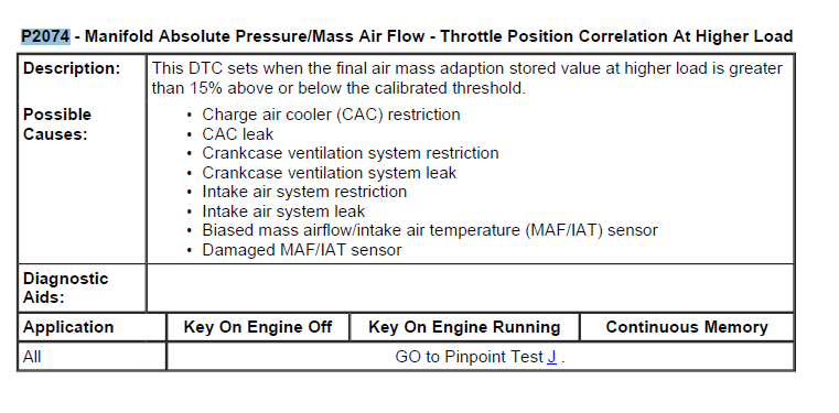

My code was P2074. I now have changed the NOx sensor, MAF sensor and EGR valve and CEL came back on again after driving 15 miles. This is exhausting? Anya one out here having similar issues?

I don't have anything helpful to add about what the issue could be so here is what the 2016 Factory Service Manual has to say about that code. Hopefully somebody will come along with some help or this info will point you in the direction of the problem.
Is your intake stock or aftermarket?

There is a recall on the Crank case ventilation system. You need to take your vin to the dealer and see if your truck is effected. It looks like there may be a leak in the intake somewhere. Is your CAC pipe still stock? How is your boost? Is your air filter clean?

Stock intake
