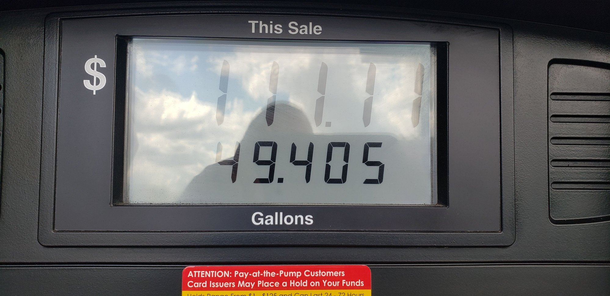

almost went too far
on our trip home from Missouri on the I44 toll road when I passed the last gas station I had 30 miles DTE more than Oklahoma city so I didn't fuel on the toll road. truck decides to regen, then get some strong head winds, then the 50 miles to empty, then 25 miles to empty then 10 miles to empty, google shows closest station at 10 miles.
S&B investment looking real good right now.
Either ford lied about fuel capacity or the pump is metering wrong. book says 48 gallons.

Miles to Empty is a computed value that is constantly being updated within the PCM. Most times it is a best guess as there is no flow meter in the fuel line to show gallons used.
