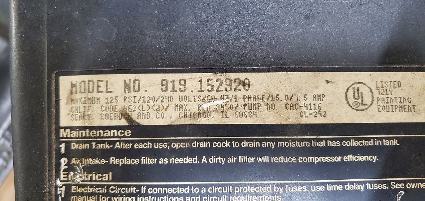

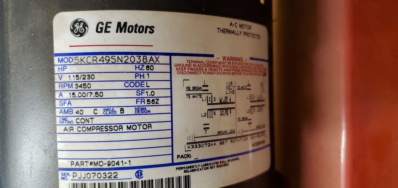

Grainger has Dayton 2MDU5 that meets spec, but is too fat & $35 locally + would have to be strapped to the motor.
Original is 4-1/2 (4-3/8 seems common) x 1.42 (common what I've found is 1-13/16)
Haven't started trying to chase down the run, but should be more common, but I think it's probably the start.
The whole motor is odd-ball in that it seems most suppliers go from 3-1/2 to 5 hp (this is a 4) & 230vlt while this is an either/or 110/230 for the listed RPM.
I think the frame is a 6 inch (end case bolt across to end case bolt) or "56Z"
Sears Model for giggles

Thats a 1hp motor for reference. Supplyhouse.com
