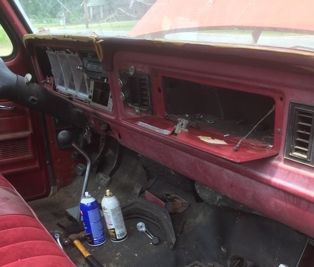

I have a FORD power steering box already in my truck. The steering COLUMN ASSEMBLY is for an automatic transmission shifter.
The stupid previous owner pulled the shift handle off WHEN HE PUT IN A STUPID FLOOR SHIFTER and a 3 speed manual transmission.
I want to put my 3 speed column shifter in (from my parts truck) and use the 3 speed in the way IT IS SUPPOSED TO BE DONE..... (3 on the tree).
My 3 speed shift tube and all internals came from a column assembly that had a MANUAL STEERING BOX. SO, I know that the steering shaft is too long to sub in the whole column assembly.
Here is my question......
Will I be able to use the column assembly tube with the "3 on the tree" shift tube..... and just put in my SHORTER STEERING SHAFT in order to get the column assembly I need so I can use the power steering box already in my truck?
I guess it boils down to the length of the "3 on the tree" steering column tube length....right?
What do y'all think?
