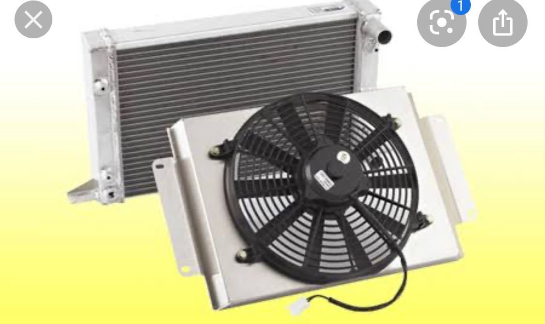

You said there is a fan on the back side of the radiator, so you should be looking for a shroud like the photo below. Might be worth confirming that the fan does indeed pull and not push. I don’t have a lot of experience with electric fans but I’m sure a shroud would improve cooling as it helps a lot with a mechanical fan.

Shroud between radiator and fan.
I get the measurements when I get the truck back and look for something like that that will fit.. seems like a good idea.. haha
This image shows better what I tried to explain. The shroud seals around radiator so all the air the fan moves is drawn through the radiator. Air is fluid and will go around the condenser in front. Sometimes even better. A friend mounted a spare tire on front bumper and his truck ran cooler.
