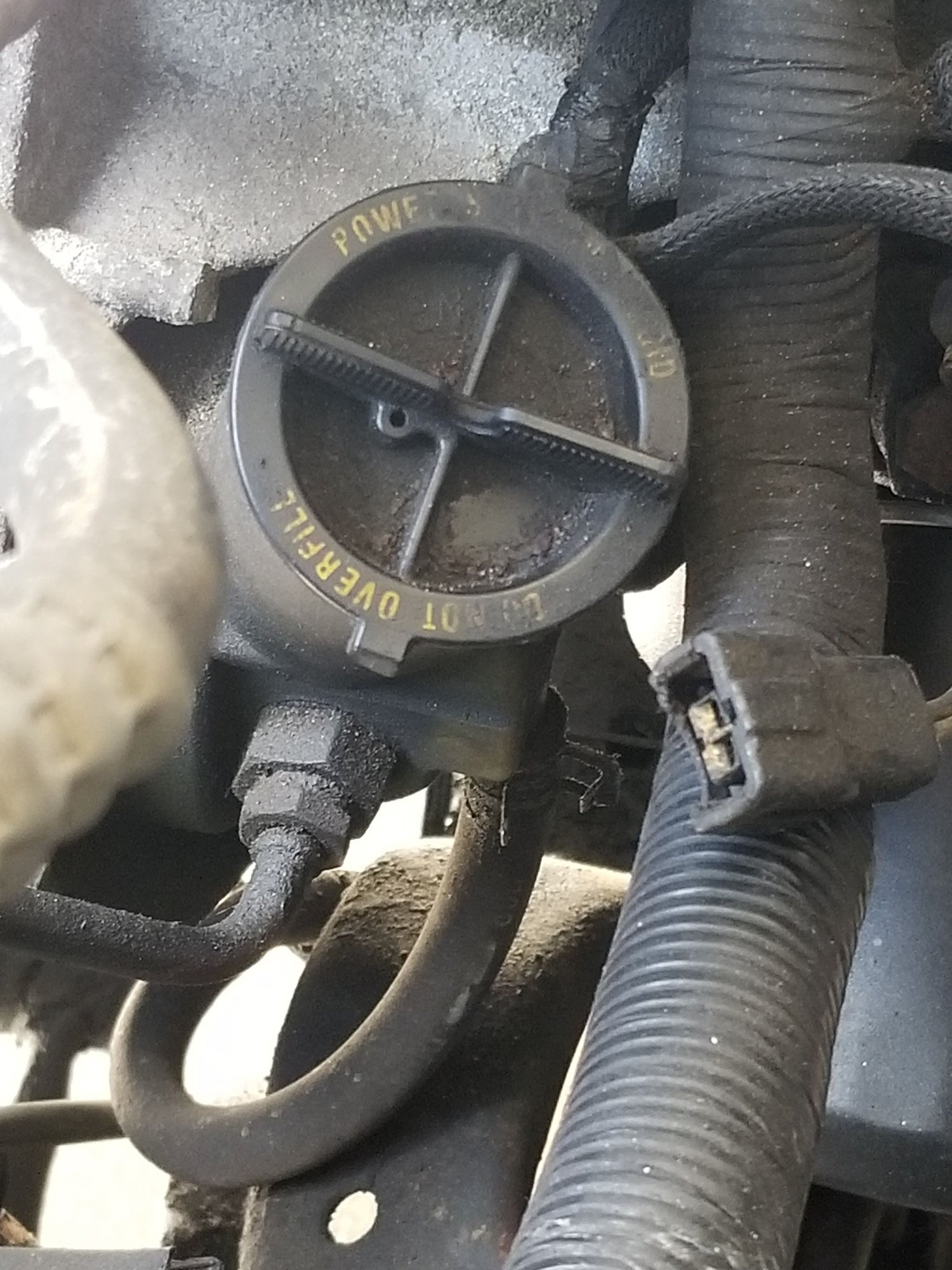

what is this connector?
Looks like a two pin connector I just noticed the other day. Also looks like it hasn't been touched in a while. I can't see anywhere it's supposed to connect to on around the power steering pump. Anyone know?

It was supposed to connect to a switch in the PS pressure line to let the ECU know when you were at full lock and thus loading the engine, but Ford deleted the switch in the late 80s I believe.

The Power Steering Pressure switch was used on the 5L F-series trucks until 1995. Looks like it was not used on the 1996 model year trucks.
The power steering pressure switch was relocated to the high pressure line. The location is under the truck mounted to front cross member. It is in the U-turn the line makes.

Neither my 95 F150 or current 94 F150 both 5.0 have that pressure switch.
E4OD trucks dont have the switch
if you dont have E4OD then you may not have the OEM pressure line

These are both 4R70W. I've never seen one of these trucks that had it.
are they MAF by chance? It may have something to do with 4x4 (Bigger tires, more weight, small engine ?) or you just simply dont have the OEM lines with the sensor on it, which I think you can buy them still if you have the connector it could be used. but it may have been a manual trans/C6 stuff only too hard to say. what I said about e4OD was about 96 service data, I guess it could vary lol
