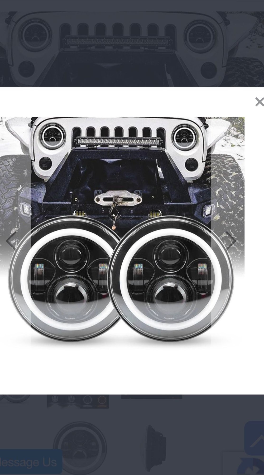

I have a 1977 Ford F-250 and I have the factory headlights so I want to get a aftermarket headlights but I don’t know what will fit? I have heard some jeeps headlights will work

I’m sorry if my sentence didn’t make sense I was in a rush typing that out but I have seen these style headlights on a lot of older trucks so I was wondering which halo headlights will fit in my 77 ford truck

Yeah, any of the 7" round headlights, like Jeep or Harley Davidson, will work. I've got projectors on mine and love them. Get one of the upgraded headlight wiring harnesses from LMC or other supplier. Your old wiring is most likely impeding power. Those harnesses are vehicle specific, cheap, and they're plug & play. The harness is a must imo.

You will want to make sure they are DOT approved or you can receive a ticket. Even worse, you could be lumped in with the mall crawler jeeps that blind people with cheap headlights that do not light up the road well but do blind oncoming traffic...

The Morimoto 2.0 led lights are some of the nicest in the category and have a very defined cut off and DOT approval. I have them on my 68.
