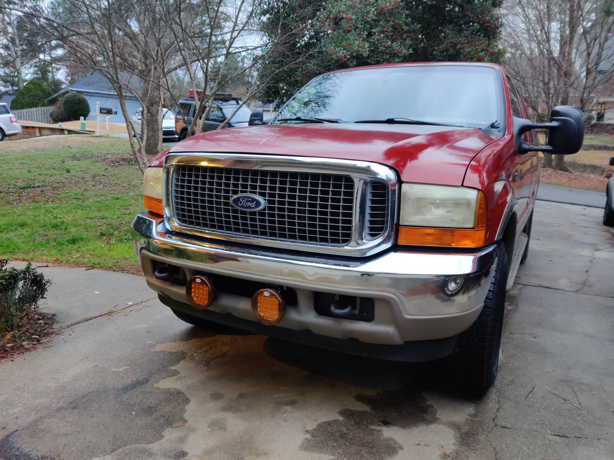

I am running Hella FF500 LED's with amber covers, they have smaller cube lights that would likely fit where you are talking about in their valuefit line.

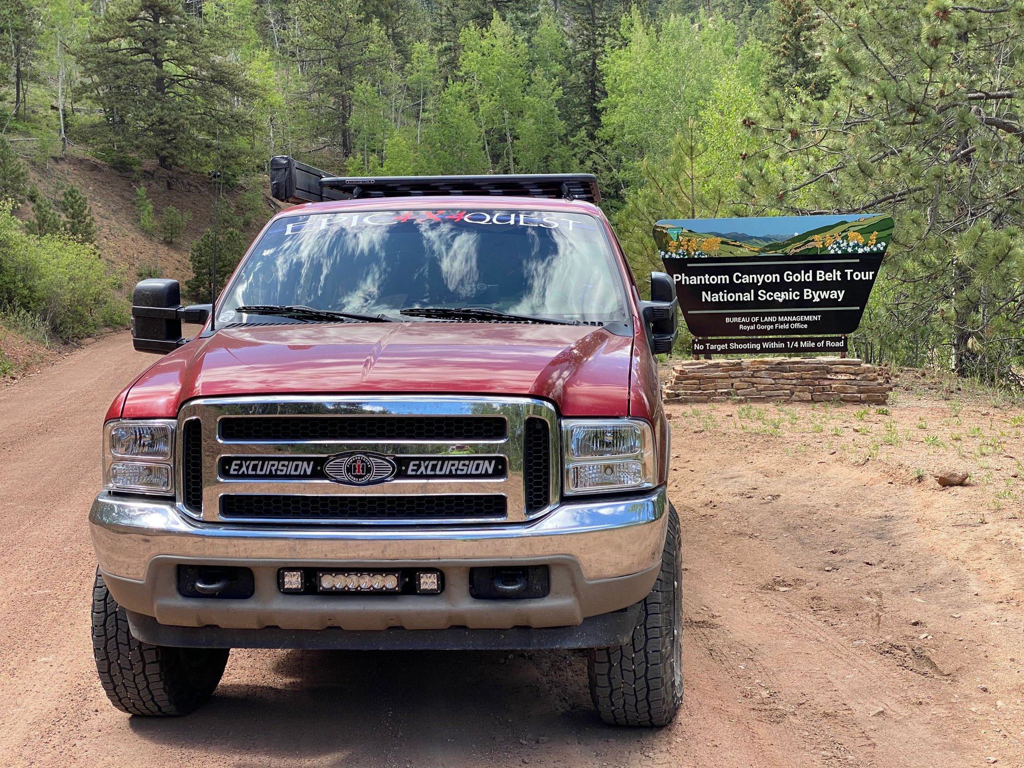

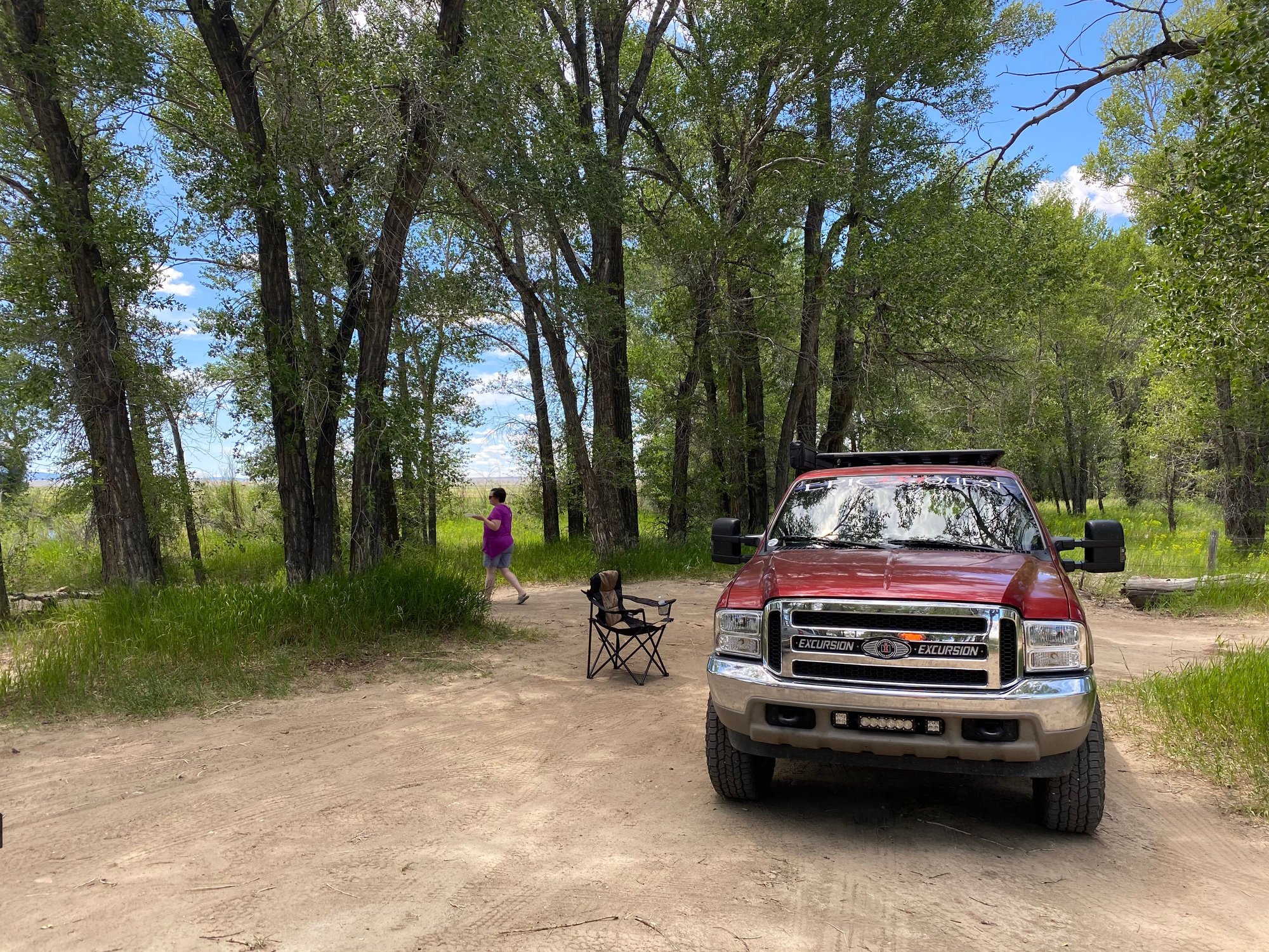

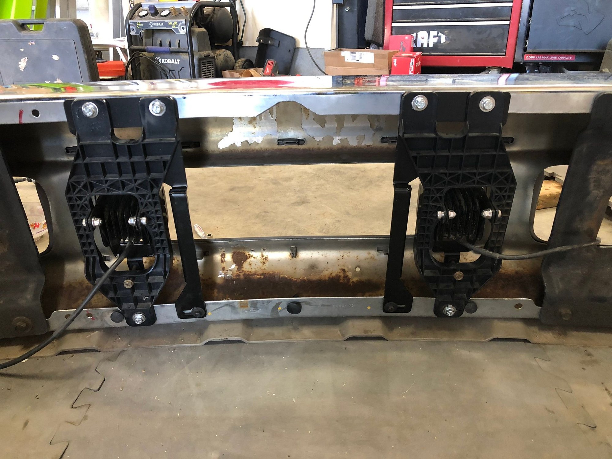

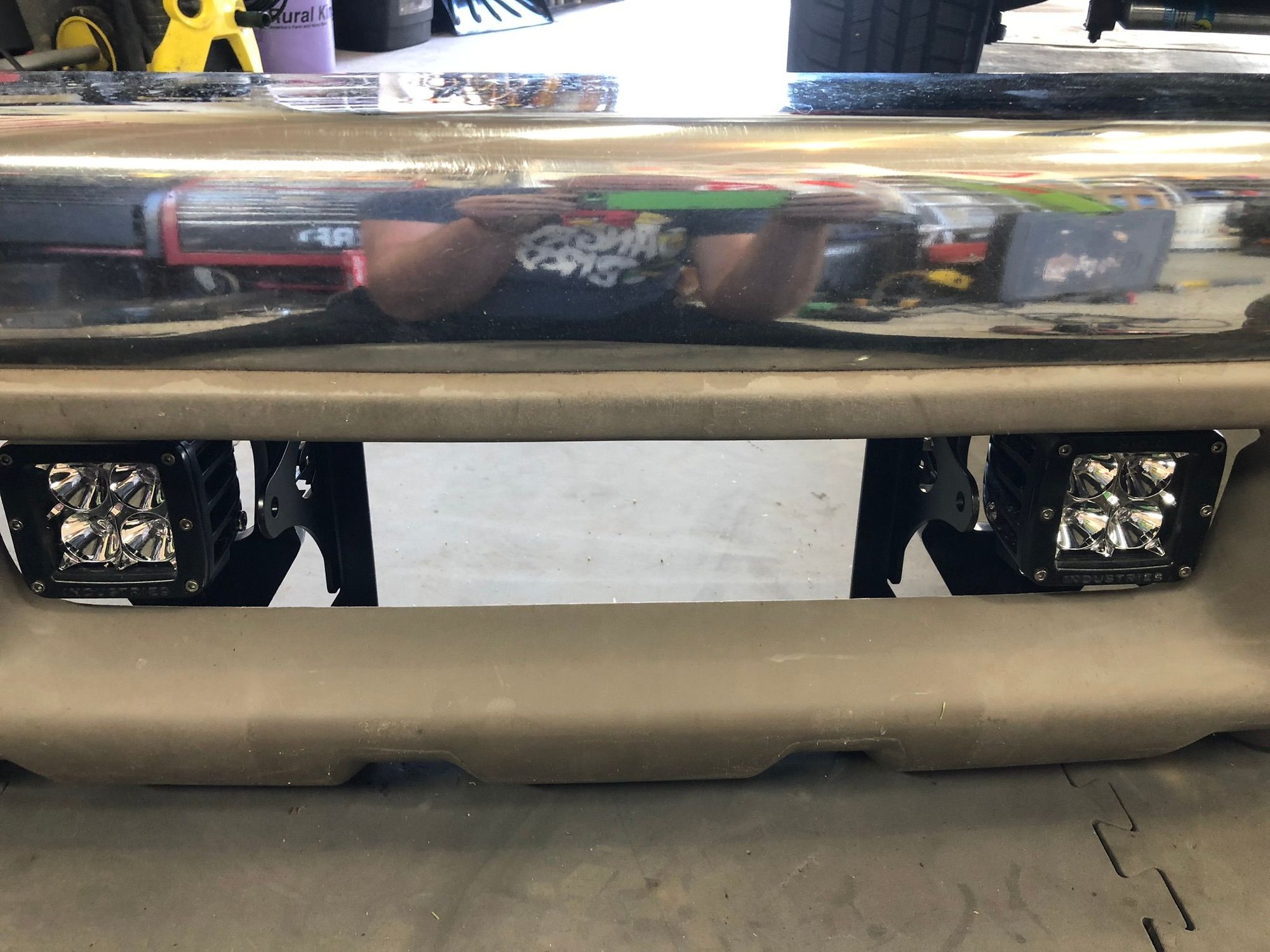

Rigid cubes baja designs light bar

Now that is what I'm looking for. Great pictures, thanks!
Here's what I came up with; Rigid D Series Pro w/ spot pattern Heavy Duty 222213, and their brackets 46503.
Are they very bright? Do you get a lot of clean distance light? What beam pattern did you get?

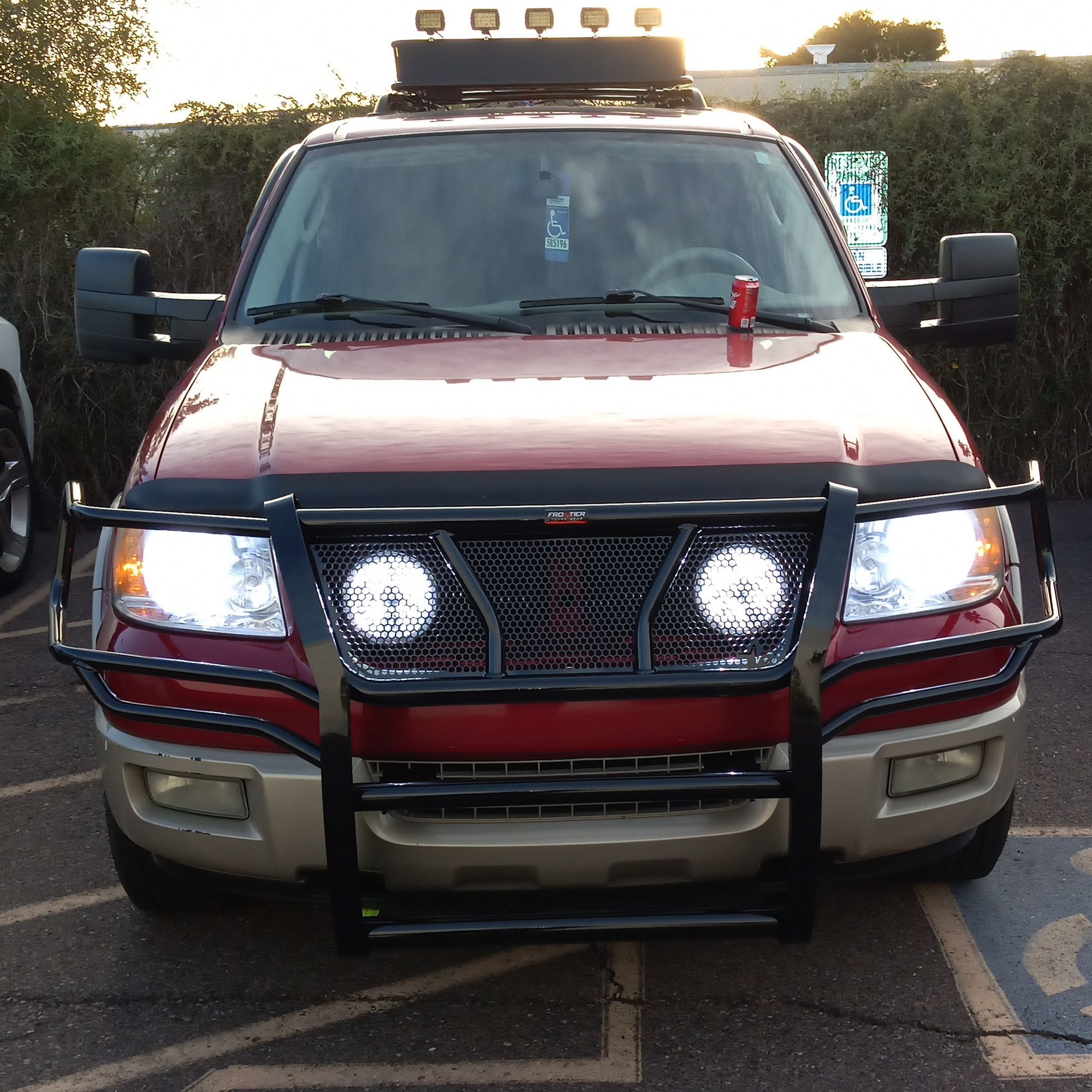

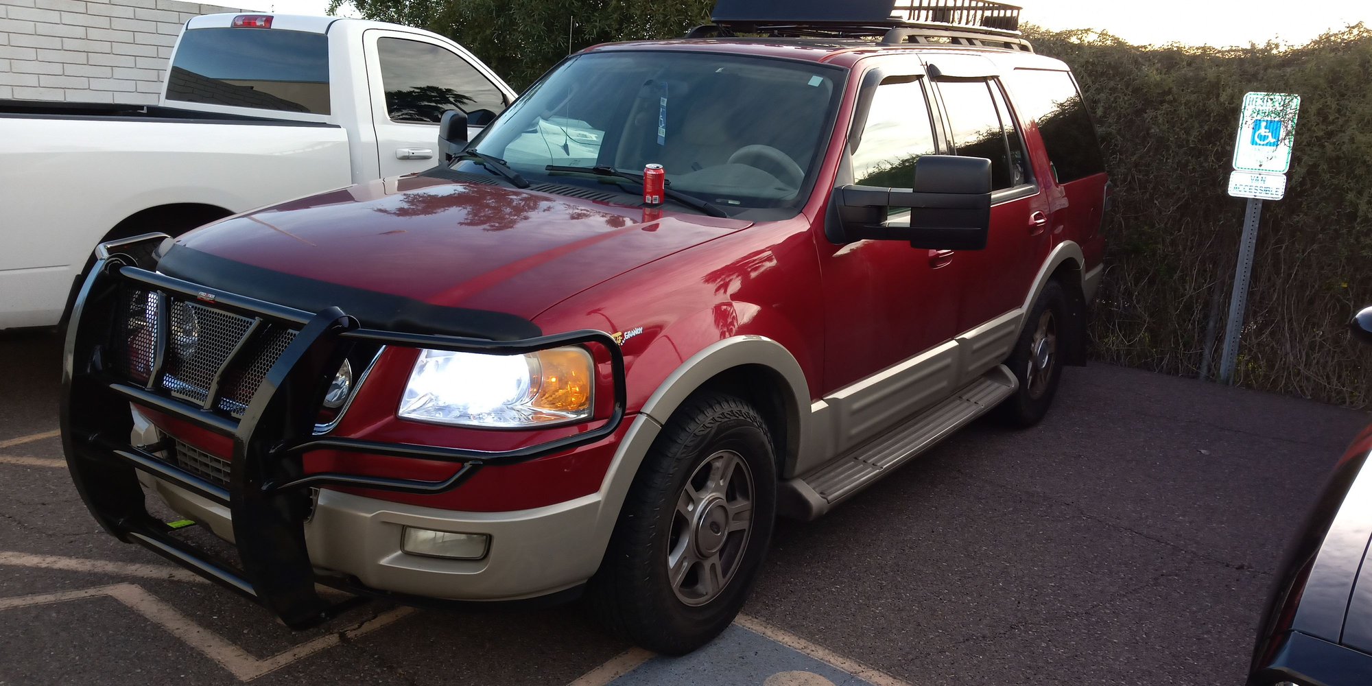

Im planning to setup my Excursion simular to my Expedition, which looks like this
Roof Rack with 5 x Forward and 2 x Rear LED Pods, and 2 x 7 inch enclosures in the grille with LED Bulbs

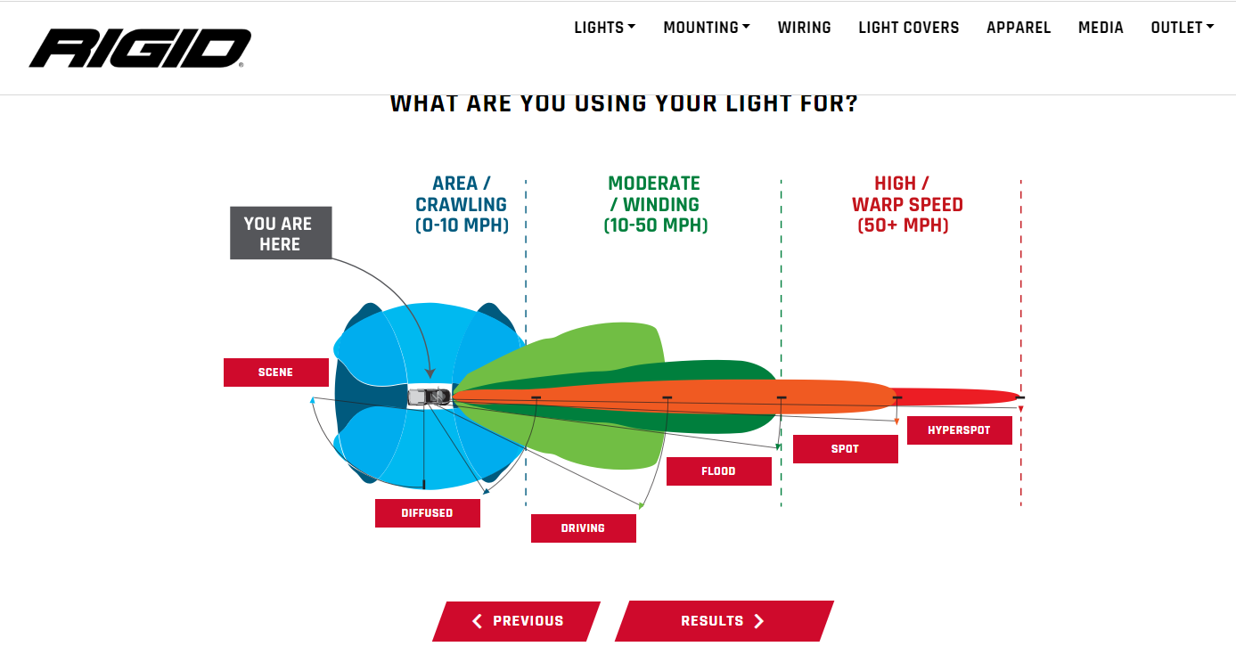

The cubes are a sort of driving/flood pattern. I wanted them for dust fog and snow to light up the low foreground in front of the truck. The Baja light bar is for a ton of light thrown way out front.
The spot wont have a very wide spread. Id look into a driving pattern. As for output they produce a ton of light. They are NOT DOT approved as they will blind oncoming traffic. I use them on the winding roads out here in CO. I am going to add a a pair of Diode Dynamics SS3 Pro SAE DOT approved fogs https://www.diodedynamics.com/stage-...-pod-pair.html

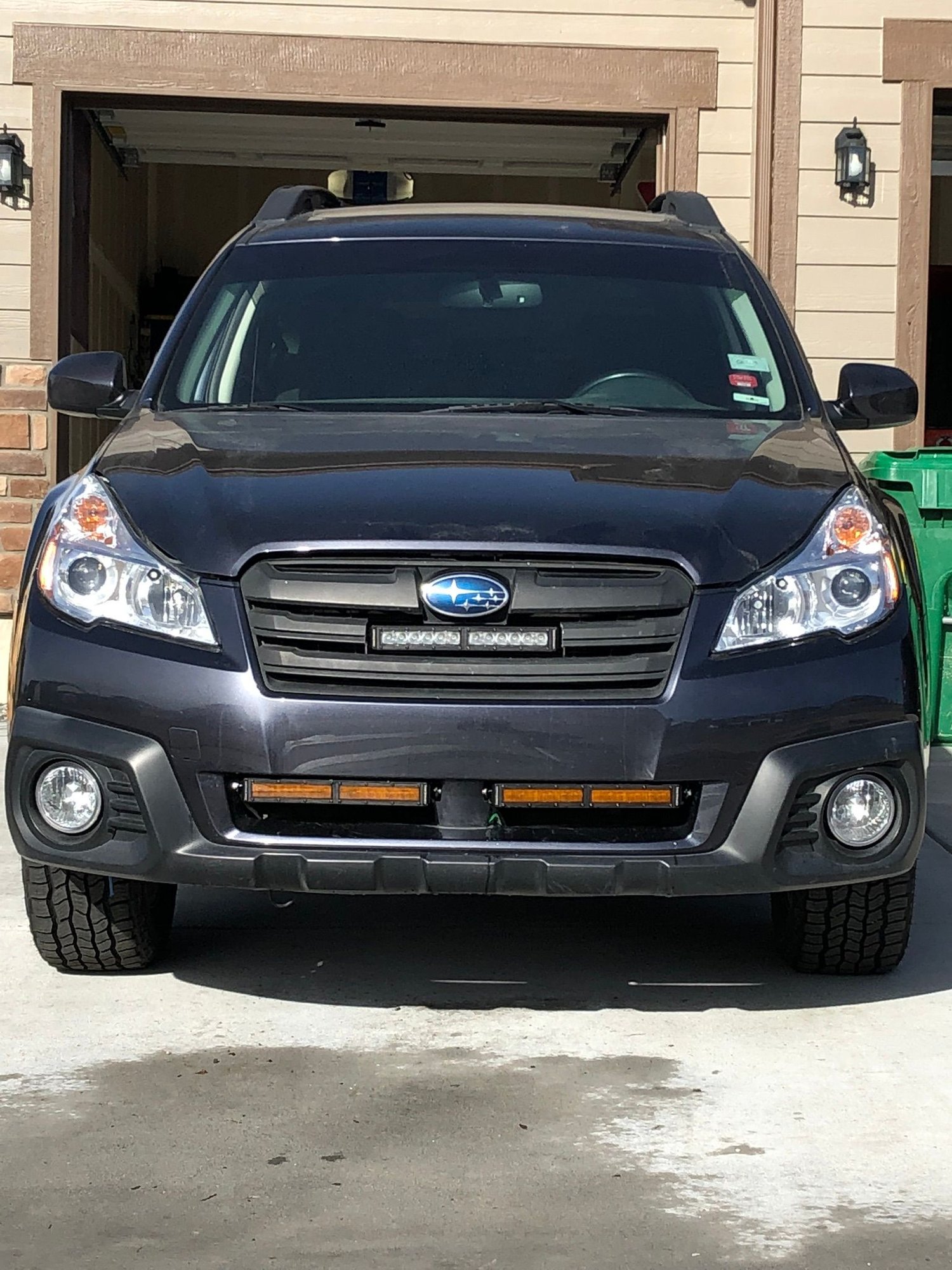

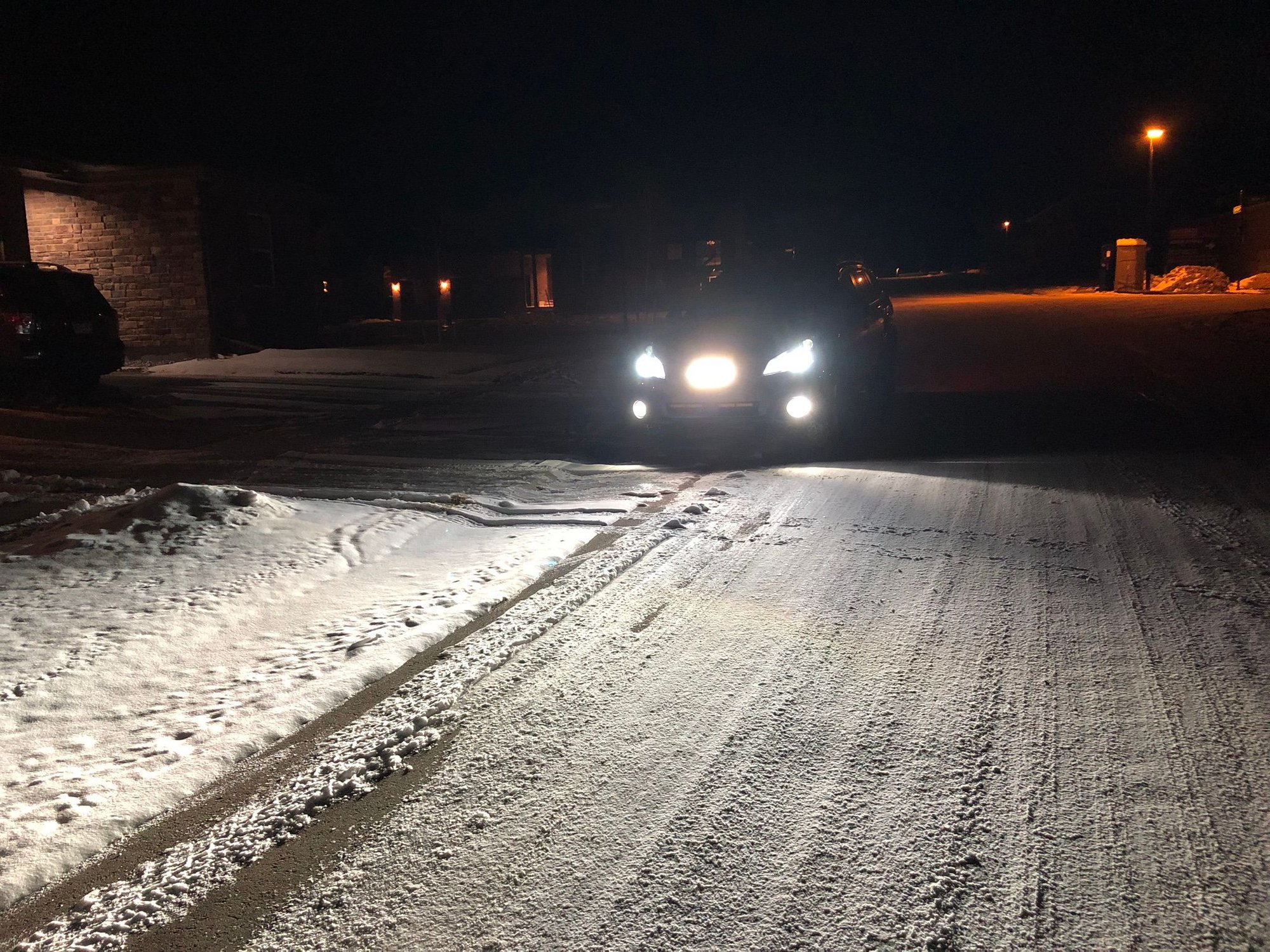

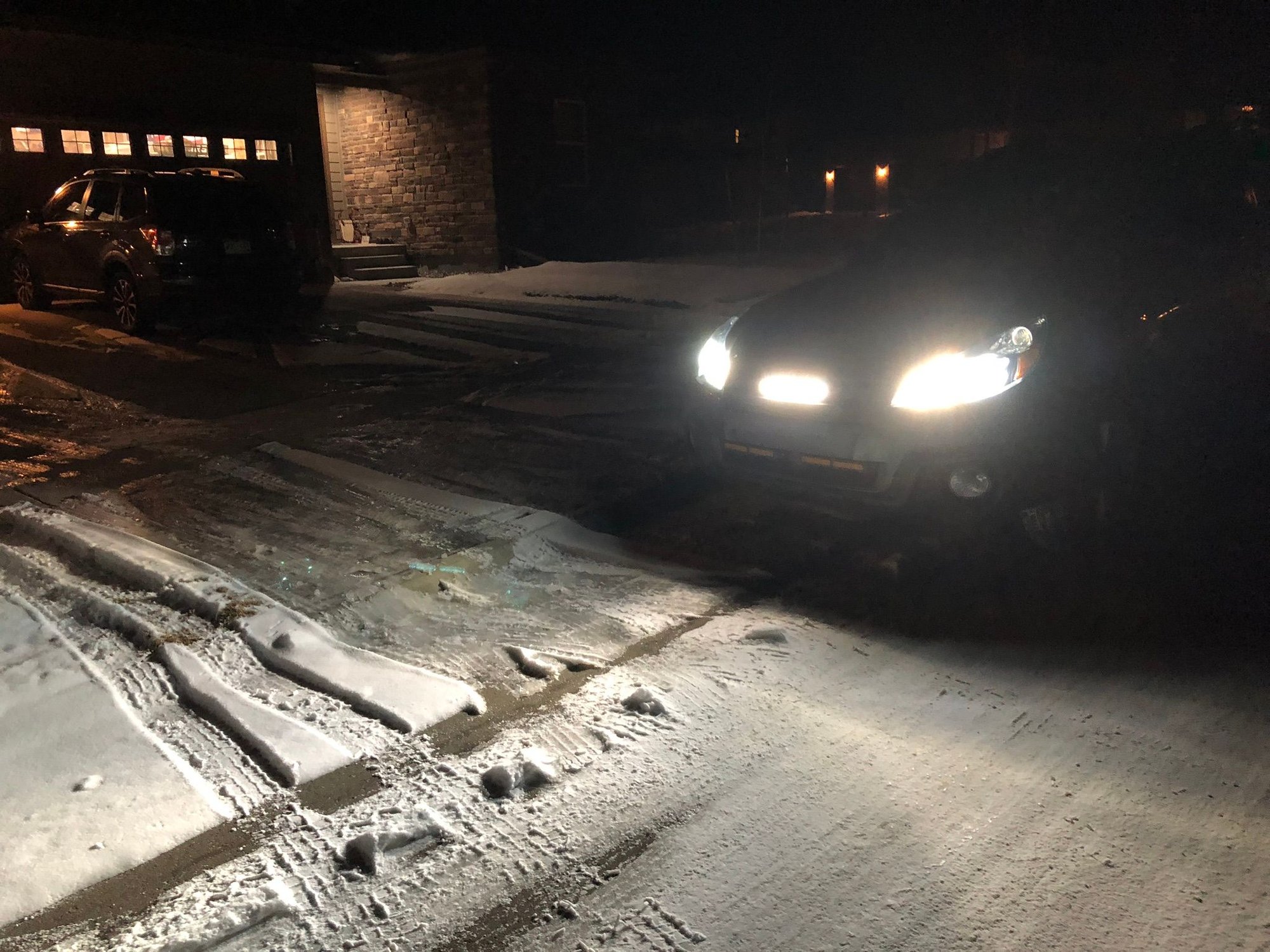

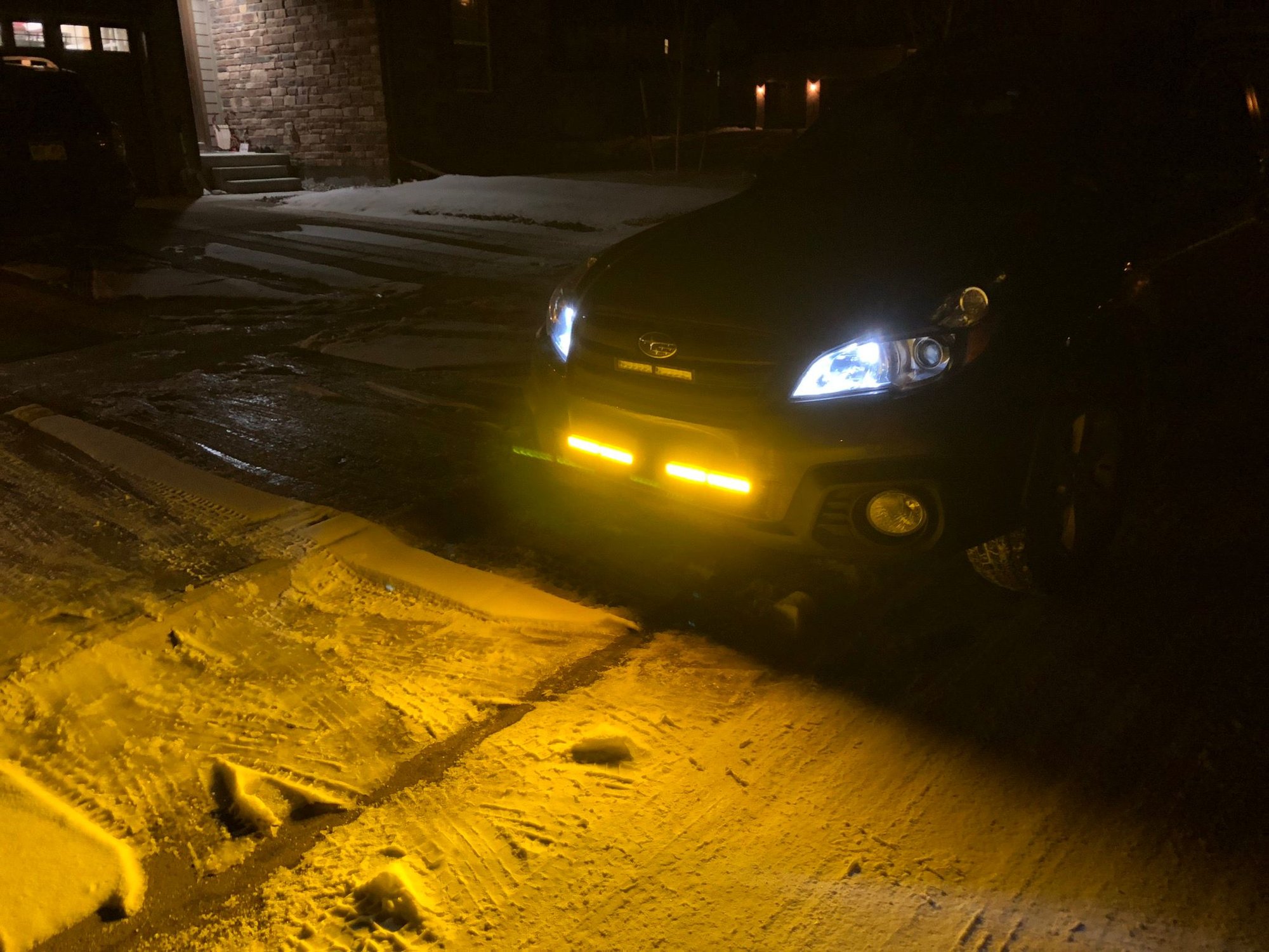

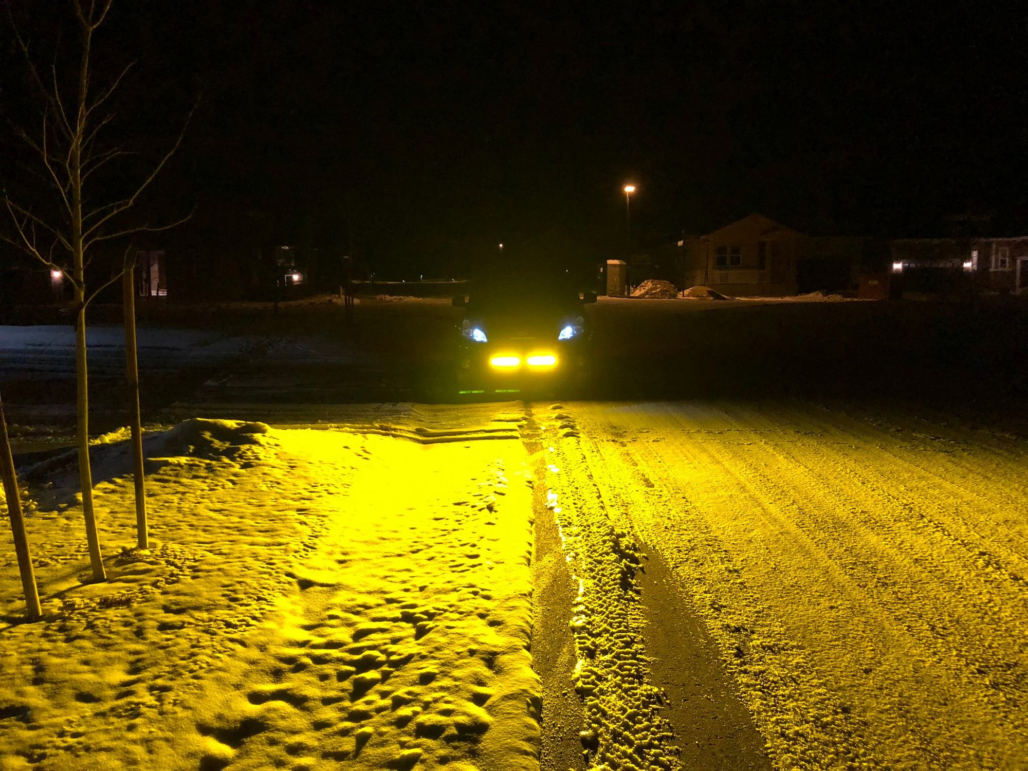

I used Diode Dynamics Stage series light bars on my Subaru. As you can see they throw a ton of light.

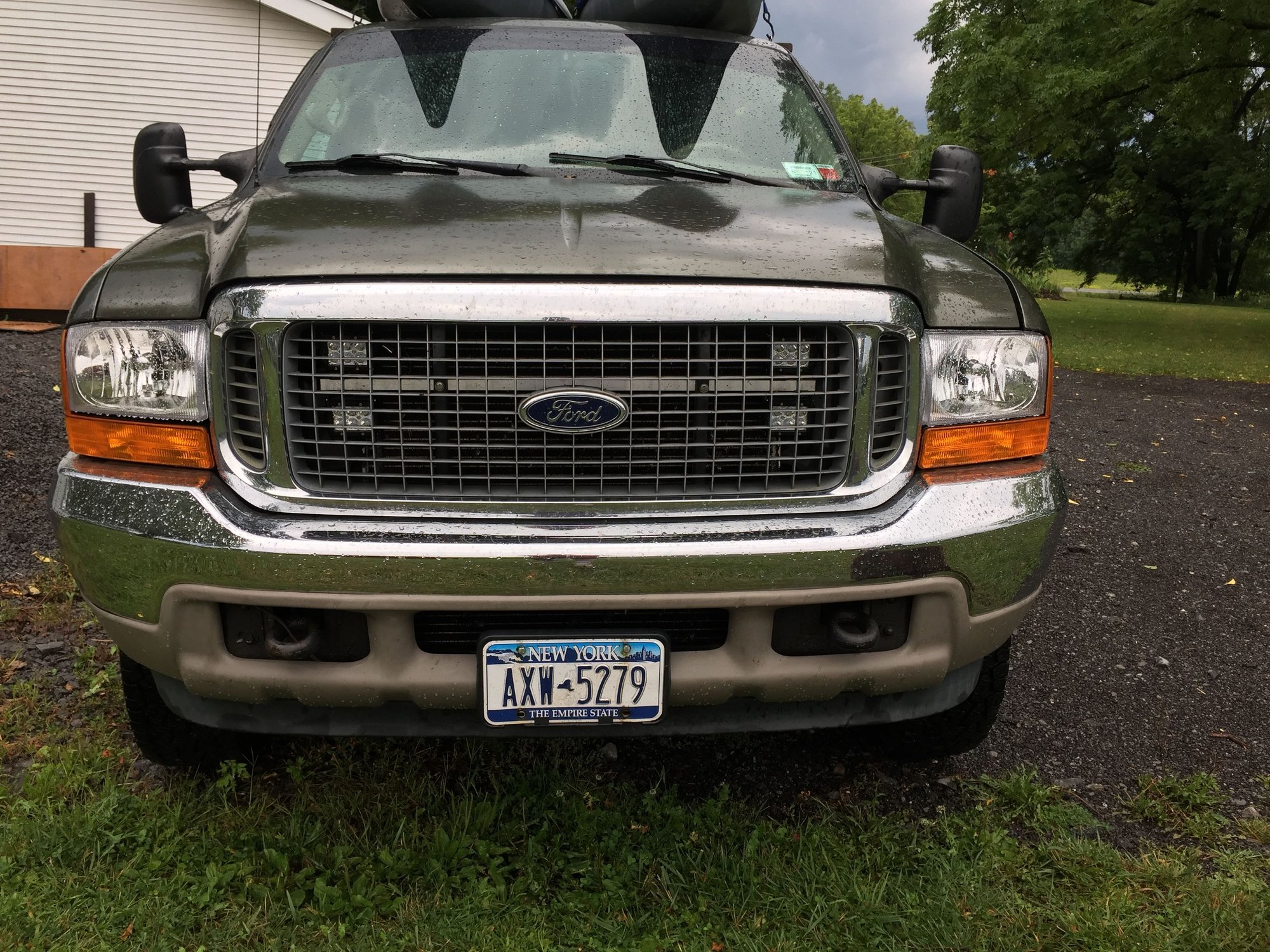

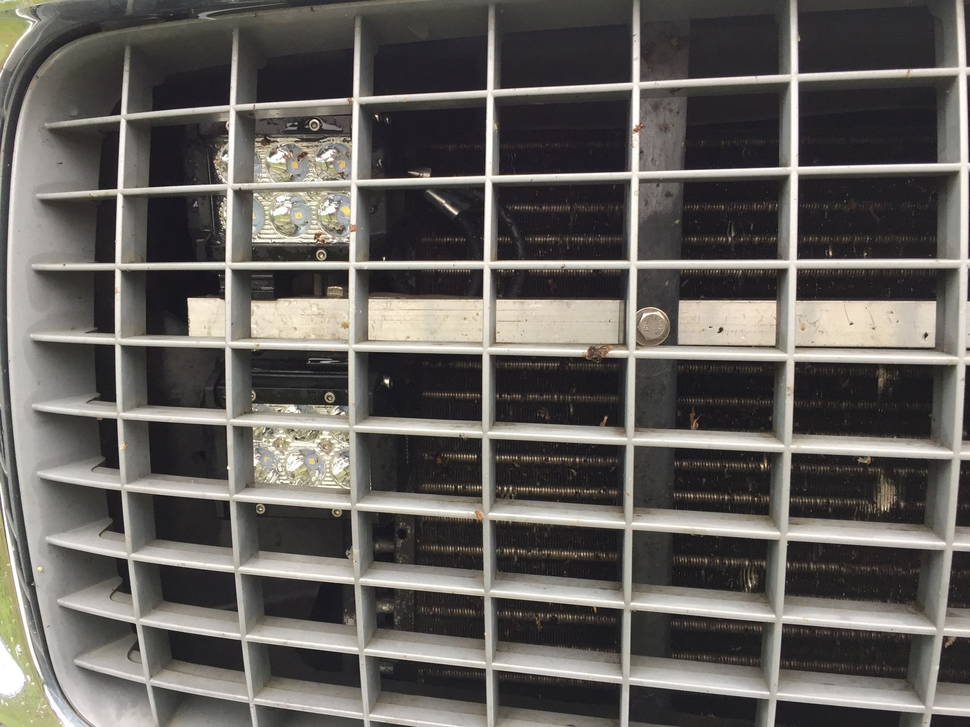

this is is what I did. 3/4” aluminum sq tube crosswise on the verticals you can see behind the grill.
i did it when it was cold and should have painted the aluminum before install but I am really not that bothered by it.

Hit that alu cross bar with some black rattle can and it disappears
