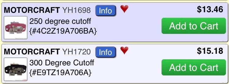

Blower speed resistor problems
94 F350 CCLB 4X4, 7.3 IDI Turbo
I'm having problems diagnosing an issue with the blower speed resistor. I've searched and read through the forums and have a good understanding of how the resistor works, effectively dampening the amount of current that flows through to the fan motor to regulate speed and output. My resistor had failed last fall so I replaced it with one from the local Autozone (only parts house in the small town I was staying in). I've since replaced it twice more, with the most recent swap to the heavy duty one matching the original (had to argue with the parts guy that there was a difference). Now that one has also failed. Can anyone inform me to the root cause of these failures? Poor parts selection, a different ground I'm not checking, an upstream short...?

You could try a Motorcraft part to see if you still have that problem.
