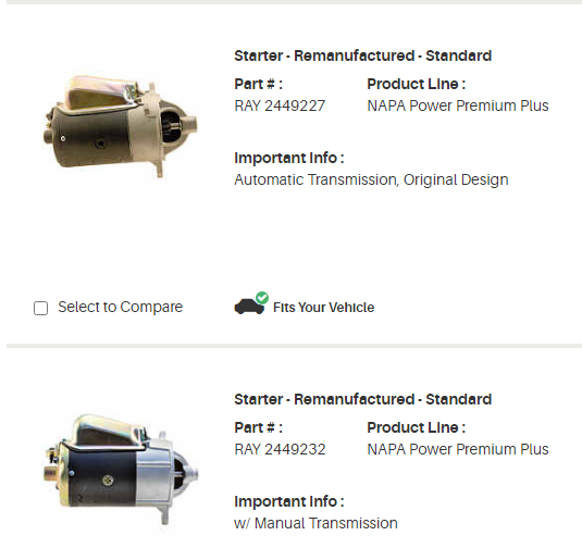

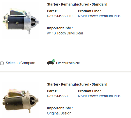

examples below, using their 'NAPA reman' on both vehicles, only the automatic has same part # RAY 2449227 which is the wrong starter, for your 5-speed
the manual starter for your truck is different #RAY 2449232, and this is the starter you need.
90 Truck starters, you need the Manual one
mustang is wrong one
