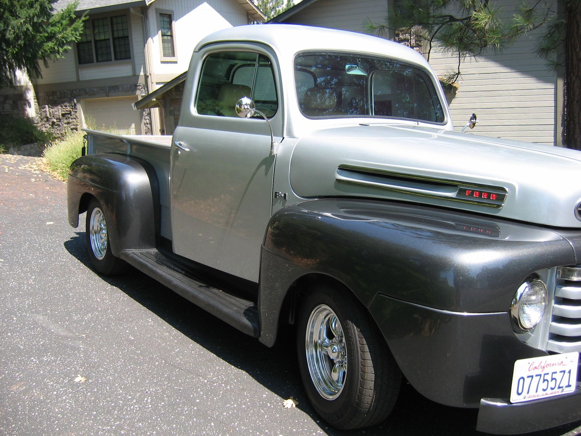

I used ppg paint what my local shop sells bought most stuff from them big $$$ all the stuff they sell works together other painters on here have better info than i

Schoo is being modest. His truck turned out to be a beautiful truck that any of us would be proud of. The paint is excellent. I have seen it up close and he has done a wonderful job.

49er and shoo both trucks look great. I’m encouraged.
