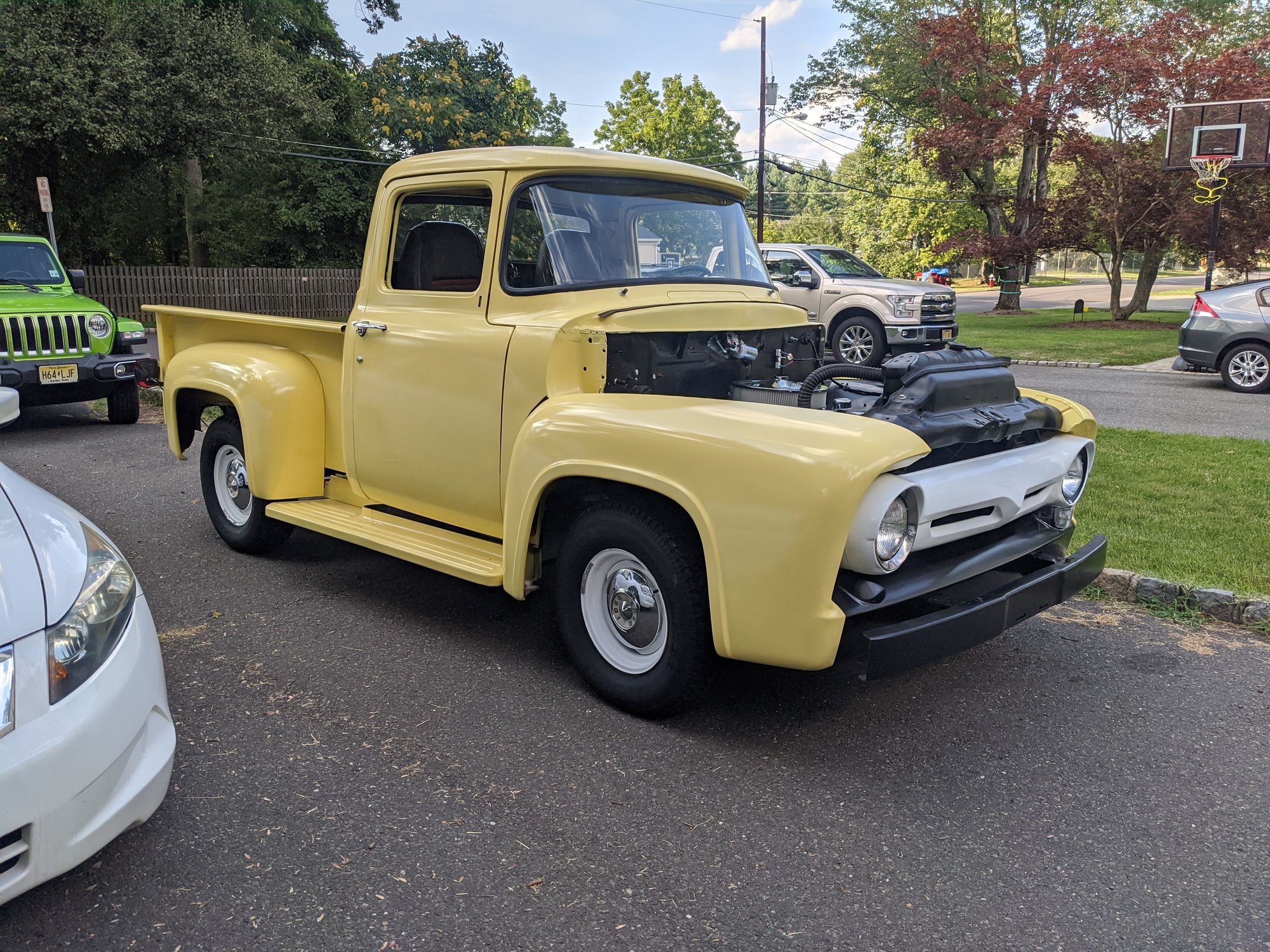

I agree with the guy saying to use one manufacturers paint all the way through. I’ve had good success with PPG paints in the past but used Eastwood urethane this time around for cost savings and it worked out well. Epoxy primer over bare metal, then build with 2k primer, then topcoat and clear if you want more durability than single stage. Most of the work will be in the prep. If you put in the time with the metal work and filler then block sand the heck out of it you will get better results. Good luck!!!
I have a bit more paint work to do but its almost there.
I painted it in my driveway over the course of several days at dawn. Less bugs and wind if painting before 8am in my area.

beautiful job Rick. Where in NJ are you? I’m in Somerset county.

that makes sense on the color. They have some that match up with certain Ford and gm paints of the ‘60’s but otherwise you have to see if they have something close. In your case I would look into the ppg paints. I got lucky and the buttercream paint at Eastwood was pretty close to the original yellow on my truck.
Im in Morris county in florham park.
