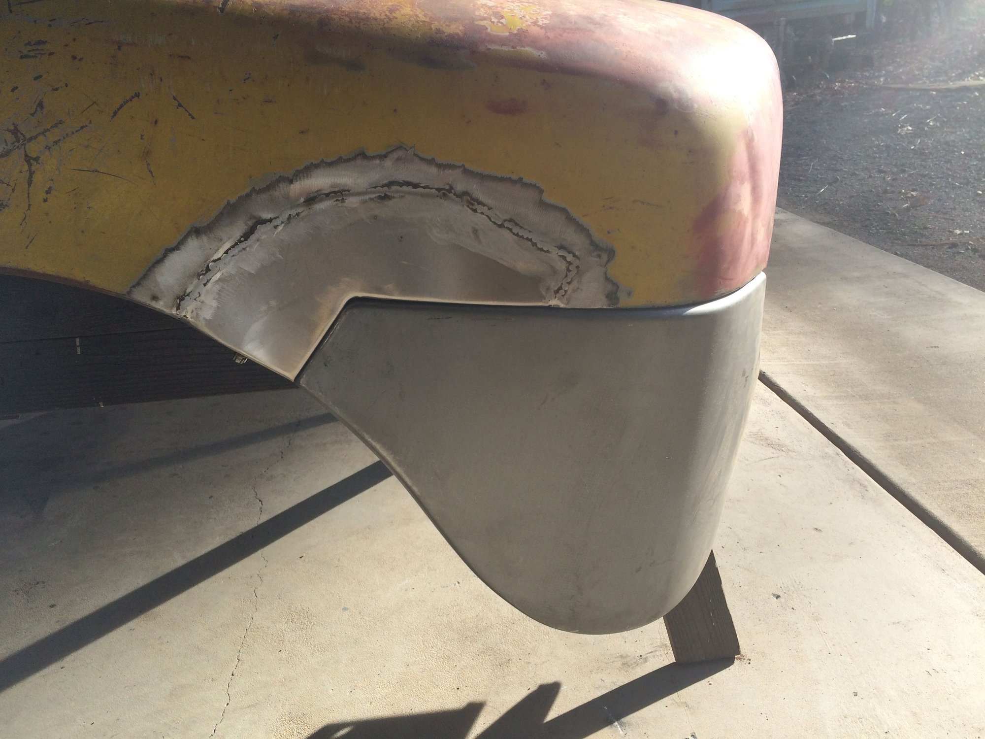

schoo, did you make the patch for the point of the fender?
yes with the help of axracer tutorials search his name they should come up

pic of patch i have a shrinker/stretcher made it easer i made 2 things at each fender the other was a backer made from 14 gauge if remember correct
Patch

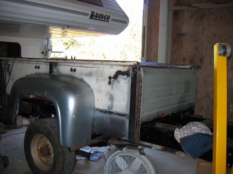

the problem with making patches or other things is you use soooo much time i spent almost a whole summer building a bed for another truck some things are not on the repop market and have too make yourself
bed step
