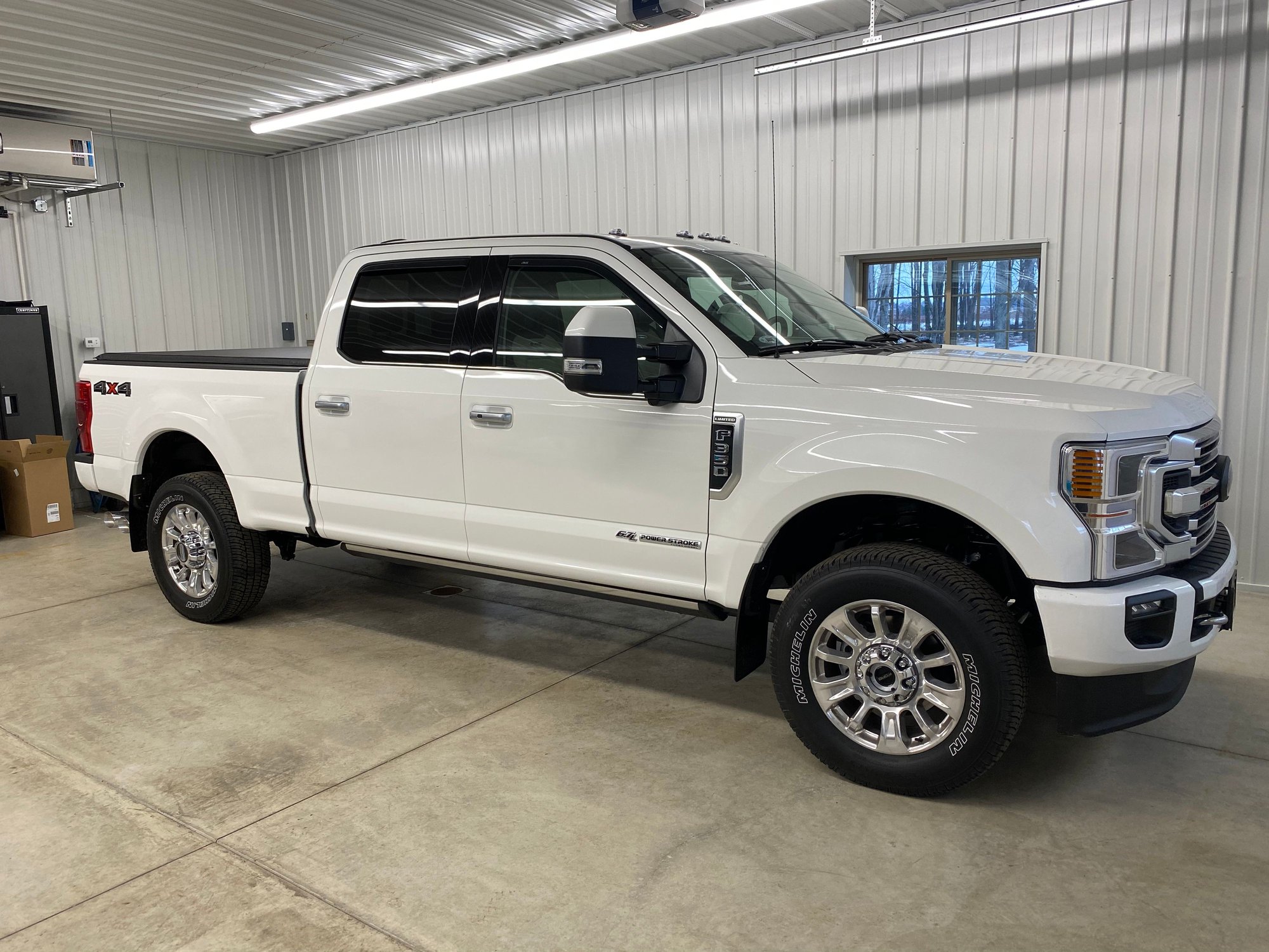

My 2020 F350 SRW came from the factory level. With the snowplow prep and camper package it raises the front and with the 2” rear leaf spring blocks makes the level some people are looking for.
Front
Back
That’s great if that’s what you’re looking for. Now I have to spend money to make it back into a working truck. Not that big of deal, I make improvements to the functionality of the truck for intended use all the time. Just seems backwards to me.
Maybe in the future they would let you option proper rake for intended use.
For those wanting this look with factory height and don’t mind the ride, this would be an option.
