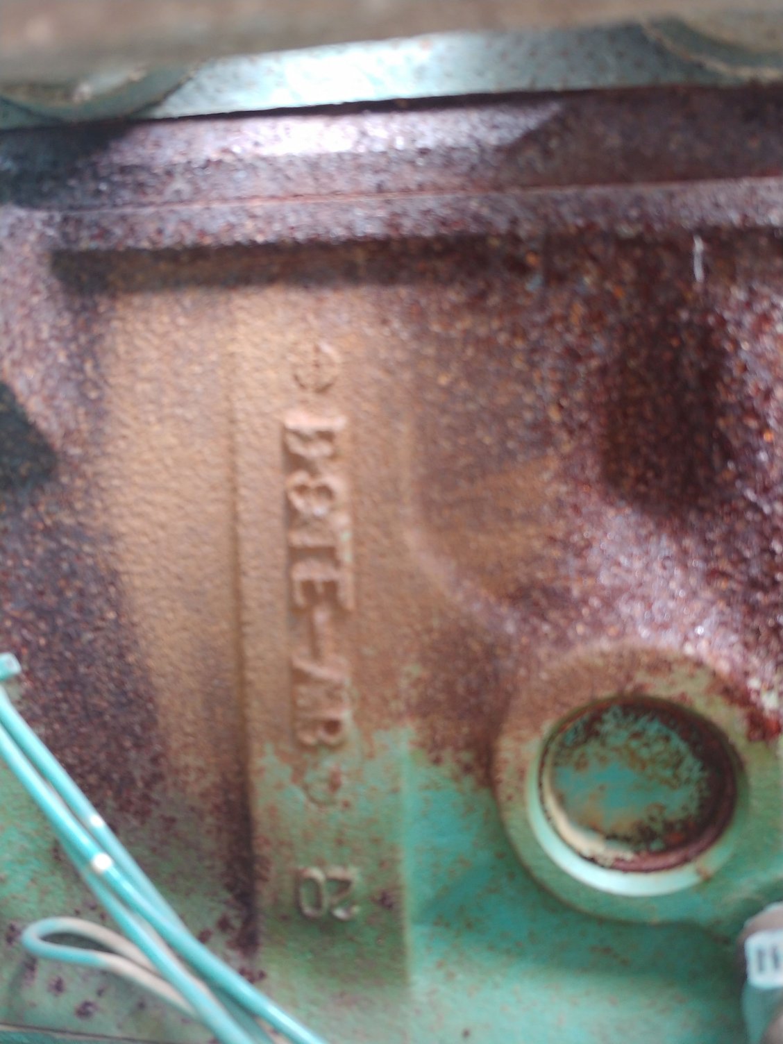

HI,
I know this may not be the right forum. But it seems there is a lot of good info here. I'm having trouble finding generator related forums dealing with the genset. I just bougth a Onan 70.0 Kw genset with a 7.5 L engine and a single barrel gasoline carb. I think it was built in 1983. It has 153 hours on the meter, I hope that is correct. It's hard to read the block number, I think it's D9TE-AB. Are the parts the same for the industrial (if that is what this is?) and the truck engines? I'm getting ready to tear it down for a cleaning and don't want buy the wrong parts to put it back together. Any help would be great.

460s were only installed in cars and pickups. In medium trucks, Ford used a heavier version of the 429, with different heads, crank etc.
It is possible you have a pickup type engine there.
Single barrel carb? You sure it's not a NG or propane setup?

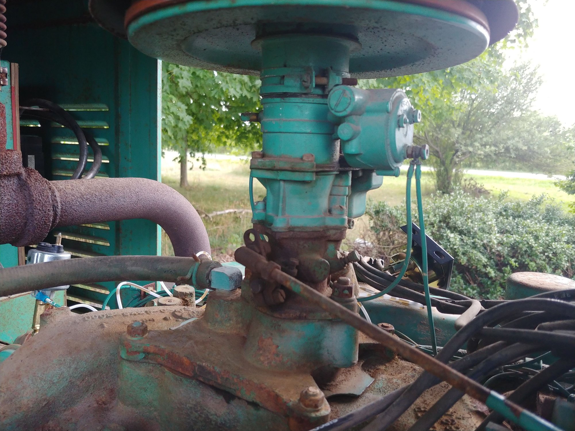

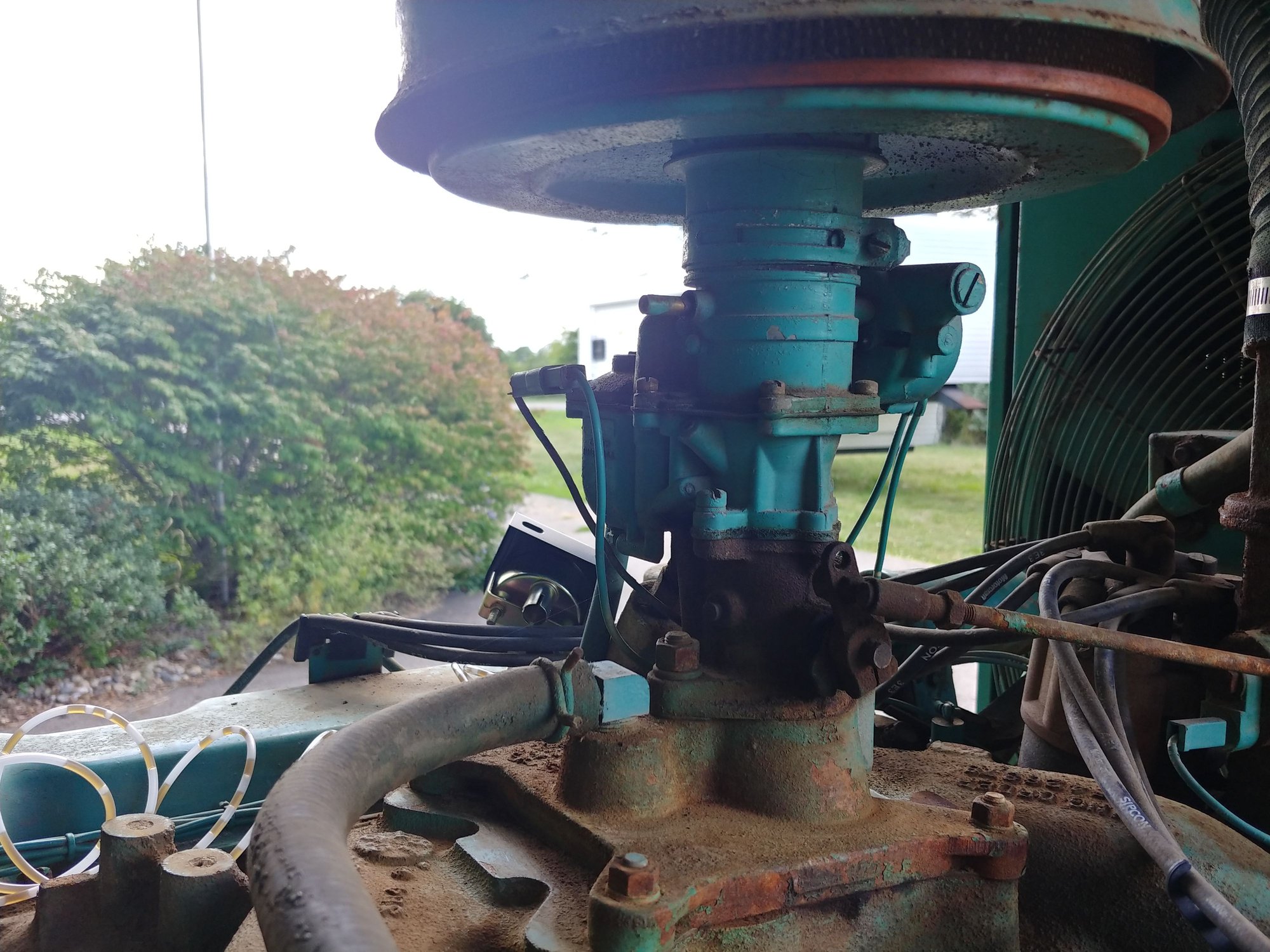

sold lots of those 460's over the years as standby engines for water pumps. they are the same engine as used in the trucks and Vans from 79 to 86ish. before they went to the fuel injected engines. they used better valves and valve seats meant for propane and natural gas applications as this was the way the majority of them were configured. so parts are plentiful at all parts stores. they have a 4 barrel intake with square bore (holley pattern). the carb you are probably looking at is probably a propane or natural gas mixer bolted to the manifold. not the same engine as used in medium duty trucks.
great engines, ran for ever. lots used on remote pump jacks here in Alberta that ran 24/7/365.

I can't find the model number on the carb. Here are some more pictures hopefully someone knows what it is.

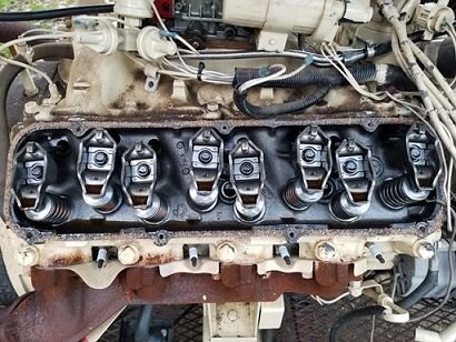

I thought your engine looked familiar. Here's a thread by @KubotaOrange76 . In his thread he bought a 460 powered generator and also did some research on it. Have a gander at his thread.

Since you say it runs on gasoline, it must have a fuel line and a tank. It would be a dual fuel model carb.

I have a 460 generator engine that ran on propane and was turbocharged. Yes, I still have the turbo and propane injection stuff. No, you don't want to try to run this turbo setup on any normal car or truck engine, it's sized to provide lots of torque at 1800 rpm, which is where a 4 pole generator making 60 Hz power runs. It looks like a turbo suitable for a lawnmower. Best thing about my engine, besides the fact that I saw it run and it's clean inside, is that it has flat top pistons.
