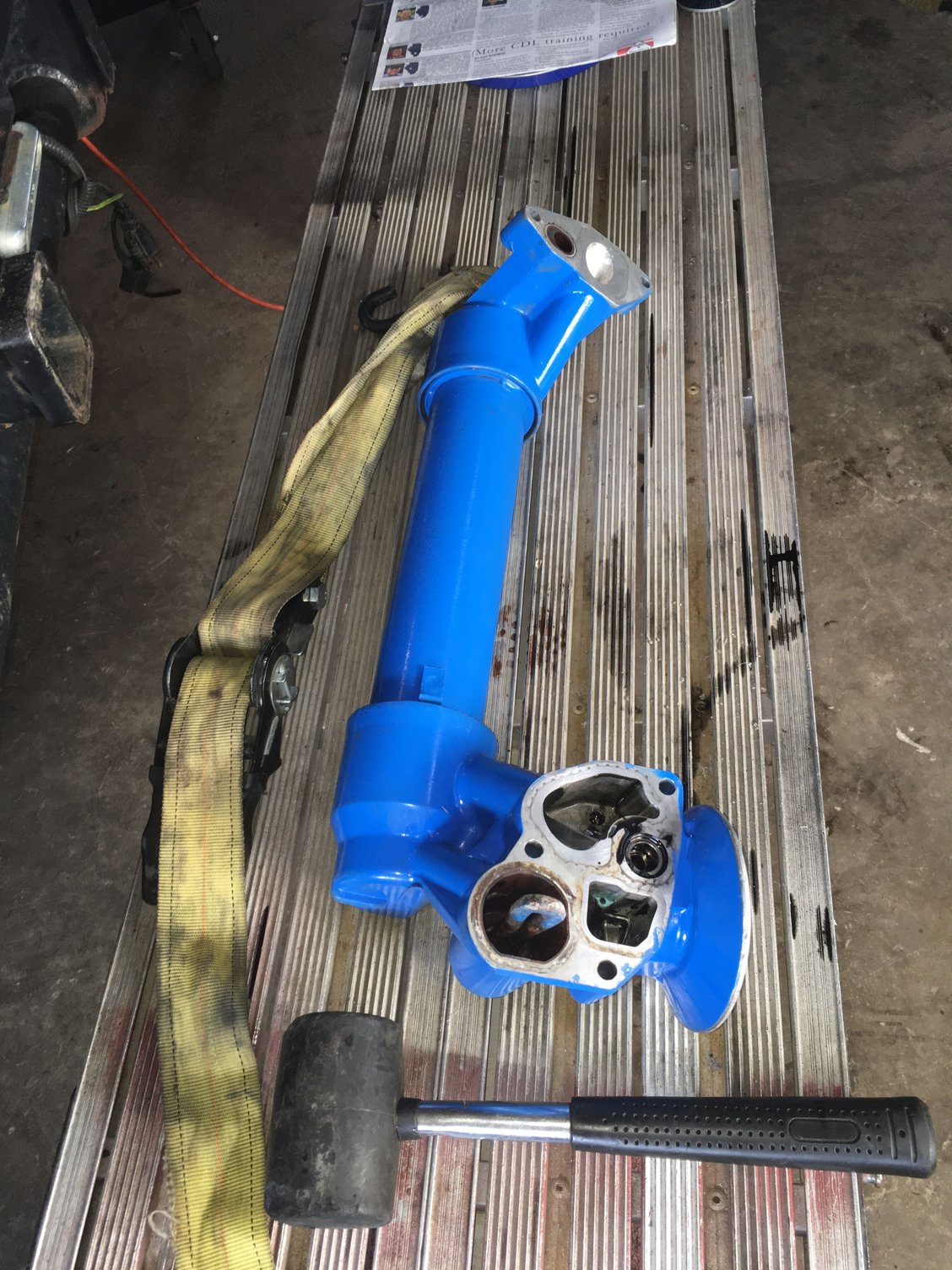

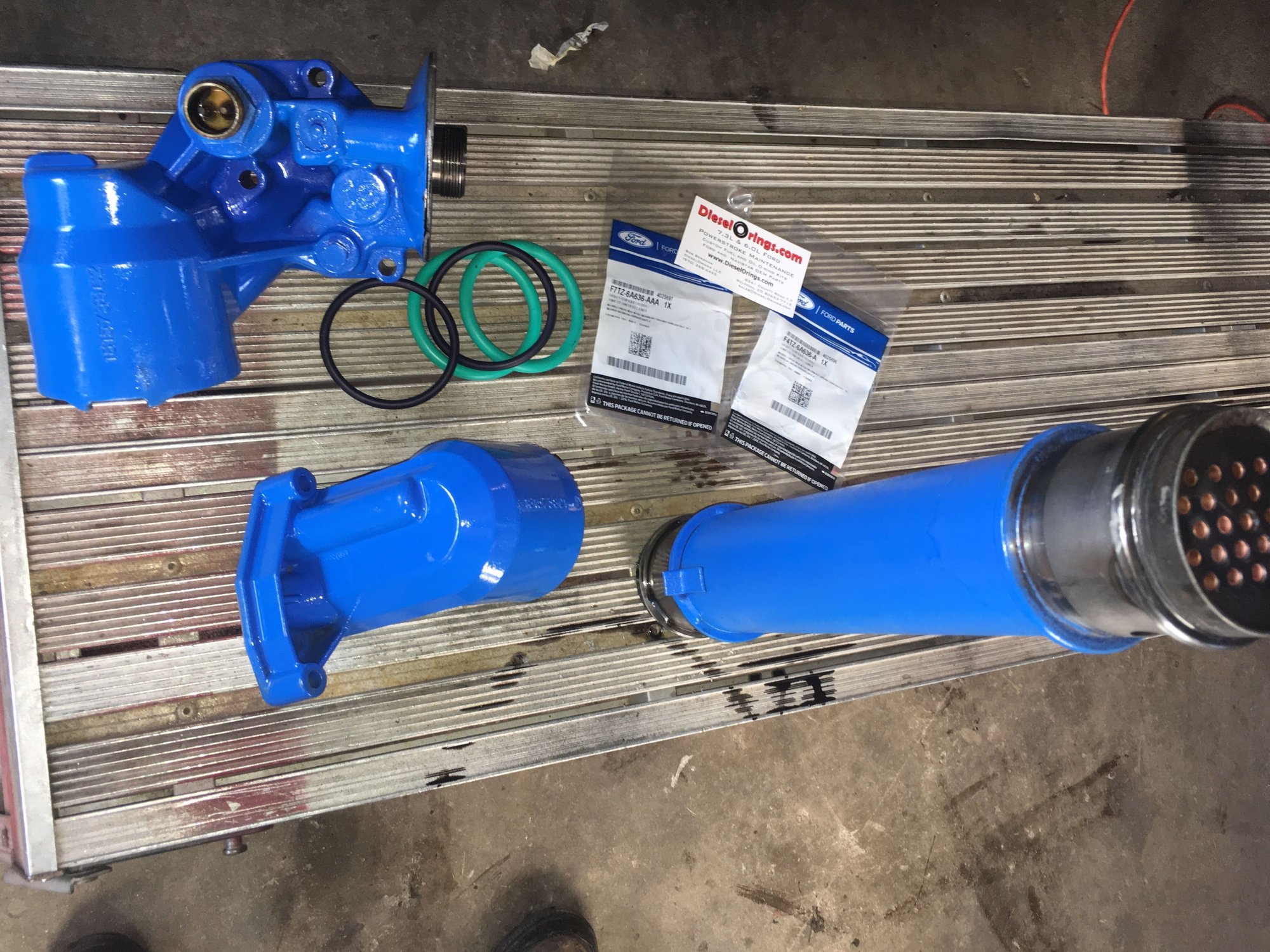

Consider rebuilding the oil cooler.

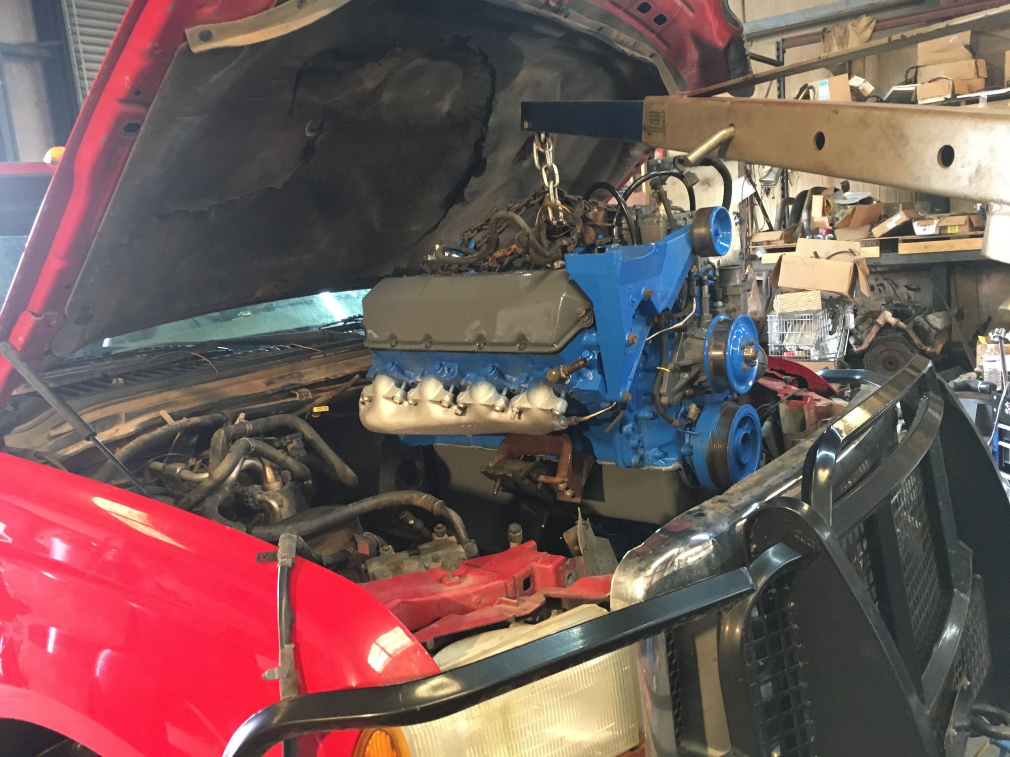

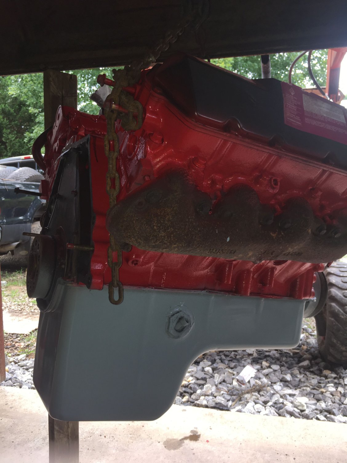

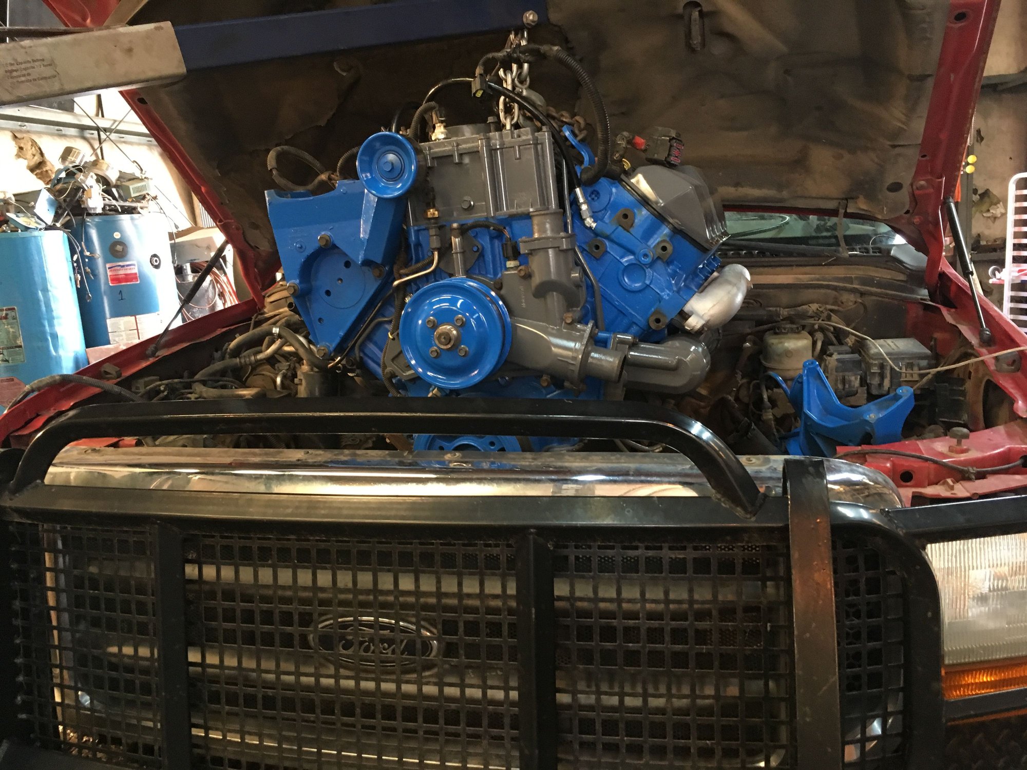

You don’t have to clean and paint the engine and engine bay/chassis. But I do. I can stop anytime I want.
