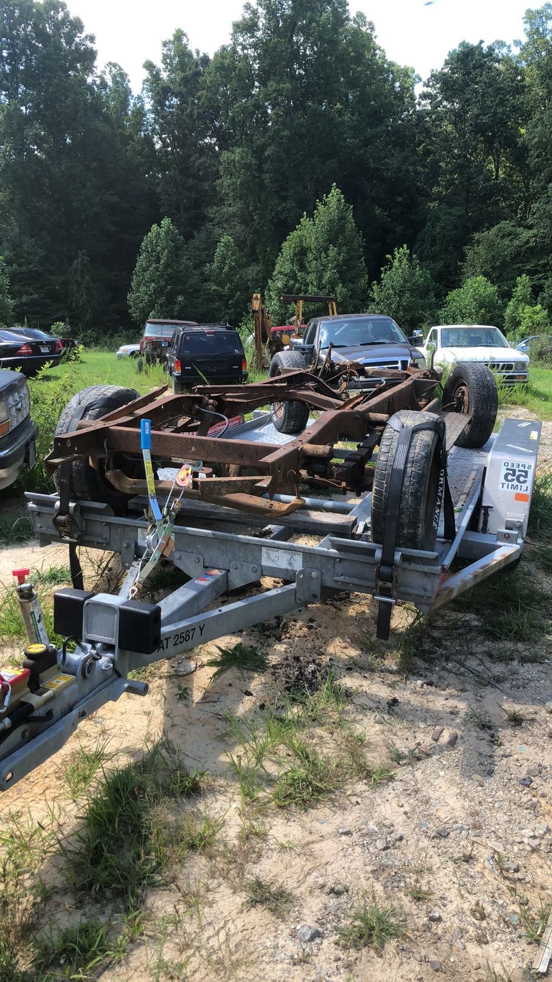

I picked up a 48 rolling chassis which I will use for spares. I have no need for the actual chassis so if you need one PM me. I’m in S.C.

[QUOTE=iburman;19431551]I picked up a 48 rolling chassis which I will use for spares. I have no need for the actual chassis so if you need one PM me. I’m in S.C.
iburman, i have sent you a pm. Thanks.
