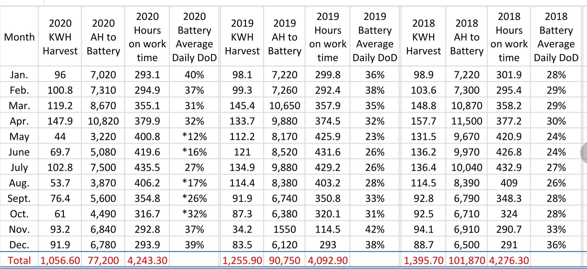

If you can.. over build some. The biggest factor when mounting on the roof will be shading from miscellaneous items up there. Summertime it's pretty easy to harvest lots of power even with shading, long sunny days and the arc is higher in the sky.
The challenge comes in the shoulder seasons and winter, shorter sunny days and the low arc of the sun. This is where shading comes in to play and can kill potential power production. If you don't mind dancing with panels throughout the day then portables can be a solution.
With my 1,280w flat mounted on the roof in a 2s4p configuration my daily production average in the winter in AZ is roughly 3kwh or 240ah +/- to the batteries and balance produced running my daily loads through the day. Having lfp batteries makes it much easier than dealing with the limitations of lead batteries.
Here some totals from the previous years of the system (everyday use).

Jim I've been recording this now for almost 5 years and with that much time invested it's like I can't stop now.
Plus, I was curious when the end of life comes for the batteries how much power was actually used and restored in the bank, as of now roughly 443,000ah.
