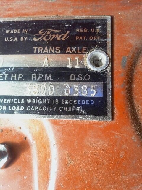

Thanks for your response and you are correct about the first part of the vin#. After that, its just the sequence number which I believe shows it was manufactured in October of 1961. The final line of the warranty plate shows the truck has a GVW of 5000 lbs. which is standard for an F100, 135 base horsepower at 3800 rpm, and a D.S.O. code of 0385. There is no other digits ahead of that, or after. Attached is a picture of the number. Let me know what your thoughts are.

Braidy: hmmm, looks like whoever was stamping was having an off day?? I'm sure Chad or some of the others will be along, and have comments about other warranty plates with mis-stampings & other anomalies

In 1961 and some 1962 the DSO was typically just the Domestic Special Order (D.S.O.) 4 digits and didn't always include the District Sales Office (also D.S.O.) two digits in front.

The warranty plate for my truck reads as follows:
F10CK22895
Based off the information I read from FORDification.info this code translates to: a F100 with a 292 and a 2 barrel carb. Its made in Kansas City and the assembly sequence is set somewhere around Oct, of 61.
122 JM F100 A 11
My understanding of this code is how it translates to a 122" wheelbase (which I believe an 8 ft. bed), J and M are paint codes for Rangoon red and Corinthian white. F100 equates to a 2 wheel drive 1/2 ton. A 3 speed manual transmission is designated by the A and a 3:70 gear ratio in the rear end is represented by the 11.
The final line reads:
G.V.W. B.H.P. R.P.M. D.S.O.
5000 135 3800 0385
F10CK222895 // WB: 122 / COLOR: JM / MODEL: F100 / TRANS: A / AXLE: 11 / MAX GVW LBS: 5000 / CERT NET HP: 135 / RPM: 3800 / DSO: 0385
F10 = F100 2WD
C = 292 2V
K = Kansas City MO Assembly Plant.
222985 = 1962, assembled October 1961.
122" Wheelbase.
JM: J = Rangoon Red / M = Corinthian White.
F100 2WD, 5000 lbs. GVWR
A = Ford 3 Speed Manual Transmission (non synchro 1st gear).
11 = Ford 9" Rear Axle / 3.70-1 / 3,300 lbs. Rear Axle Capacity.
5,000 lbs. Gross Vehicle Weight Rating.
135 net HP @ 3,800 RPM
0385 = Domestic Special Order number.
1948/62's do not have the first two digits of the DSO code listed. 1963 thru today: These codes refer to the specific FoMoCo district sales office where the dealer ordered the truck.

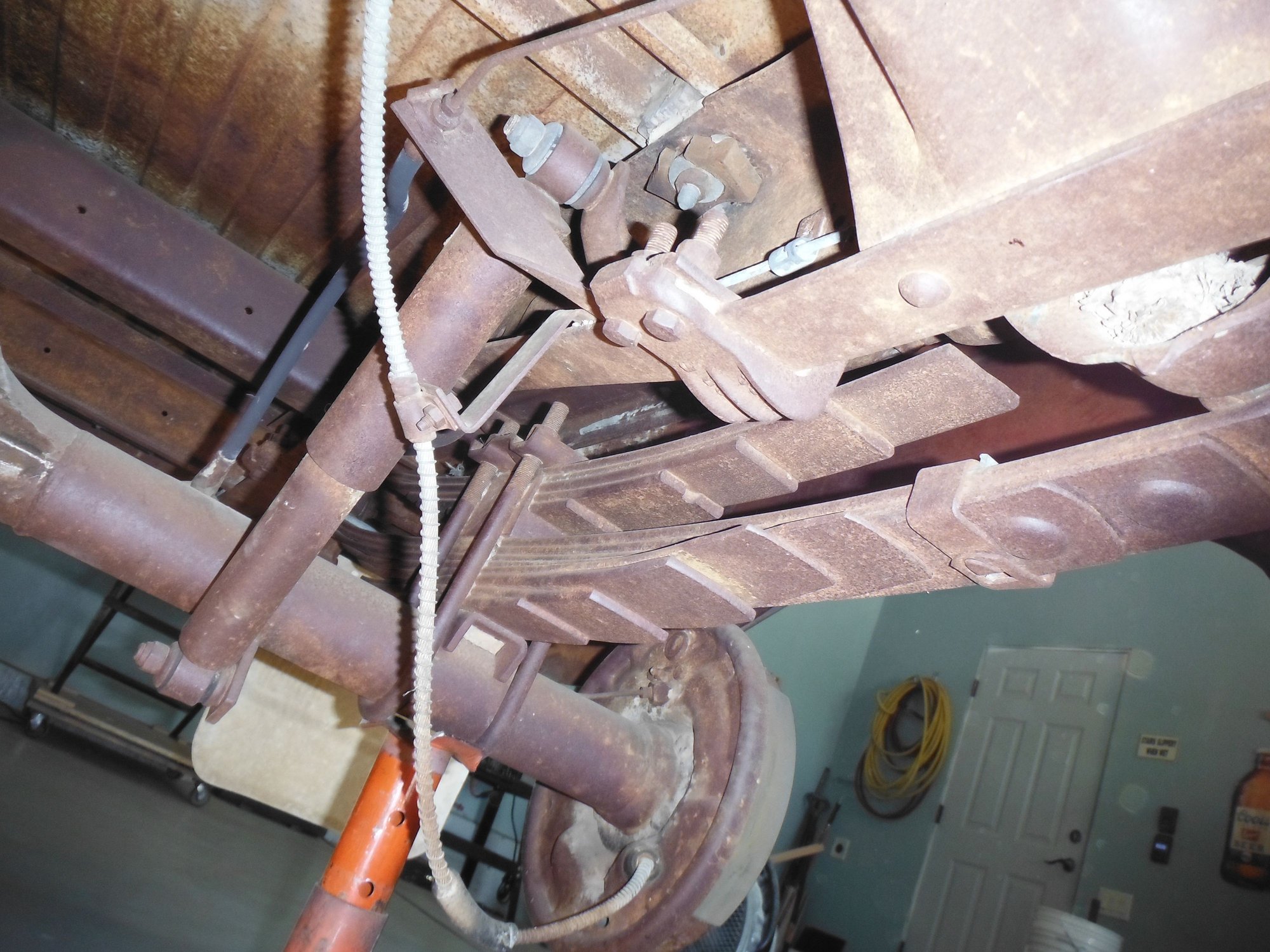

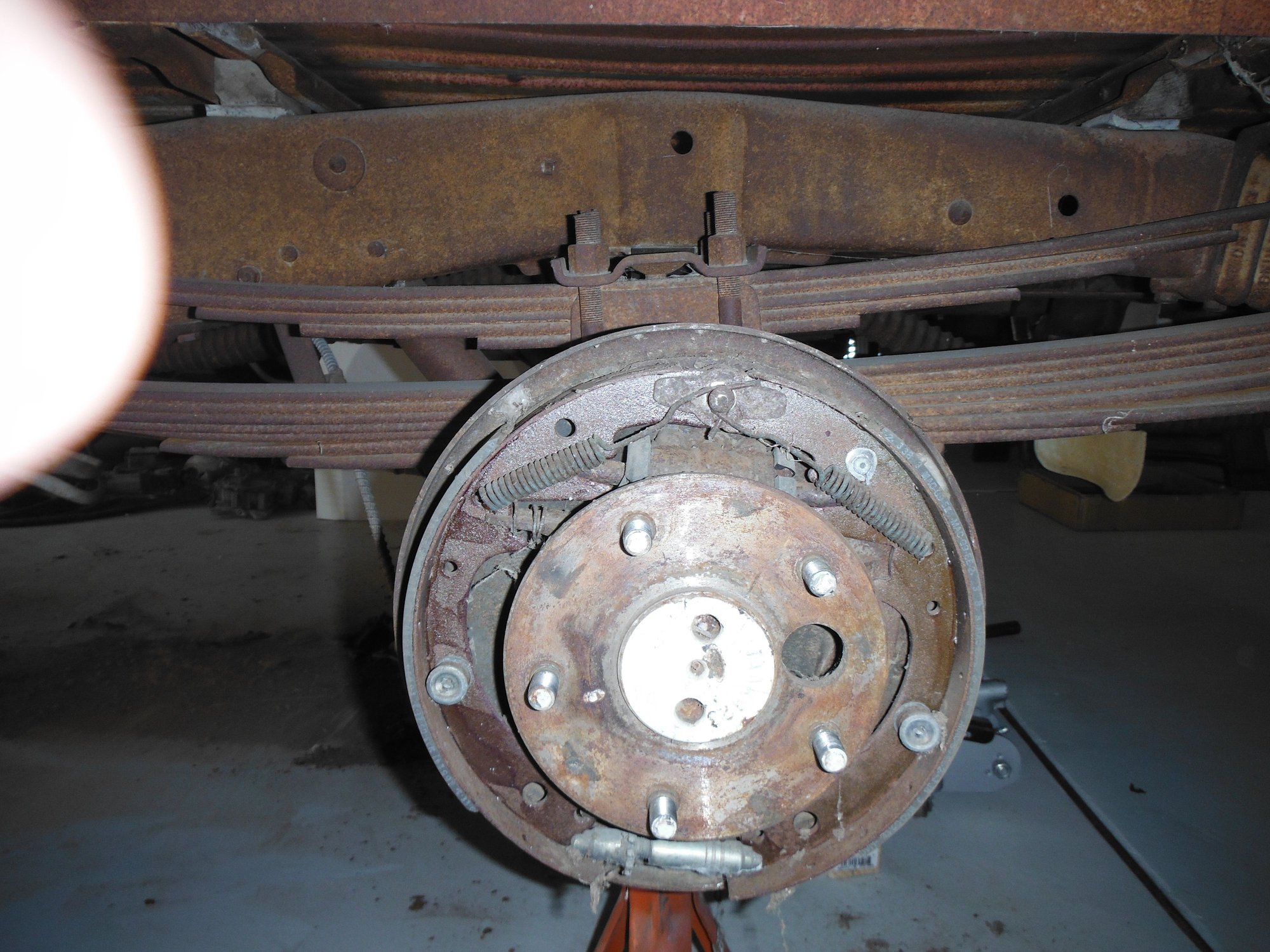

I appreciate your feedback. One of the things that baffles me about this truck is the fact it has a set of load leaf springs mounted above the larger, stock set. At this point, I'm under the impression this may be where my D.S.O. generated from since the truck is a half ton. However, since the G.V.W. rating on the warranty plate is still 5000 lbs., does this mean these trucks come that way typically?

Look on the main leaf for a Ford ID engineering number.
Cool, I will. Will that number then need to be translated like the warranty plate? Also, what will that number tell me?
The ID number for the springs can be cross referenced to the part number if they're genuine Ford. There won't be a number if they're aftermarket.
The number will be near the eye bolt at the center of the leaf. Will probably be rusty, so it will be hard to read.
