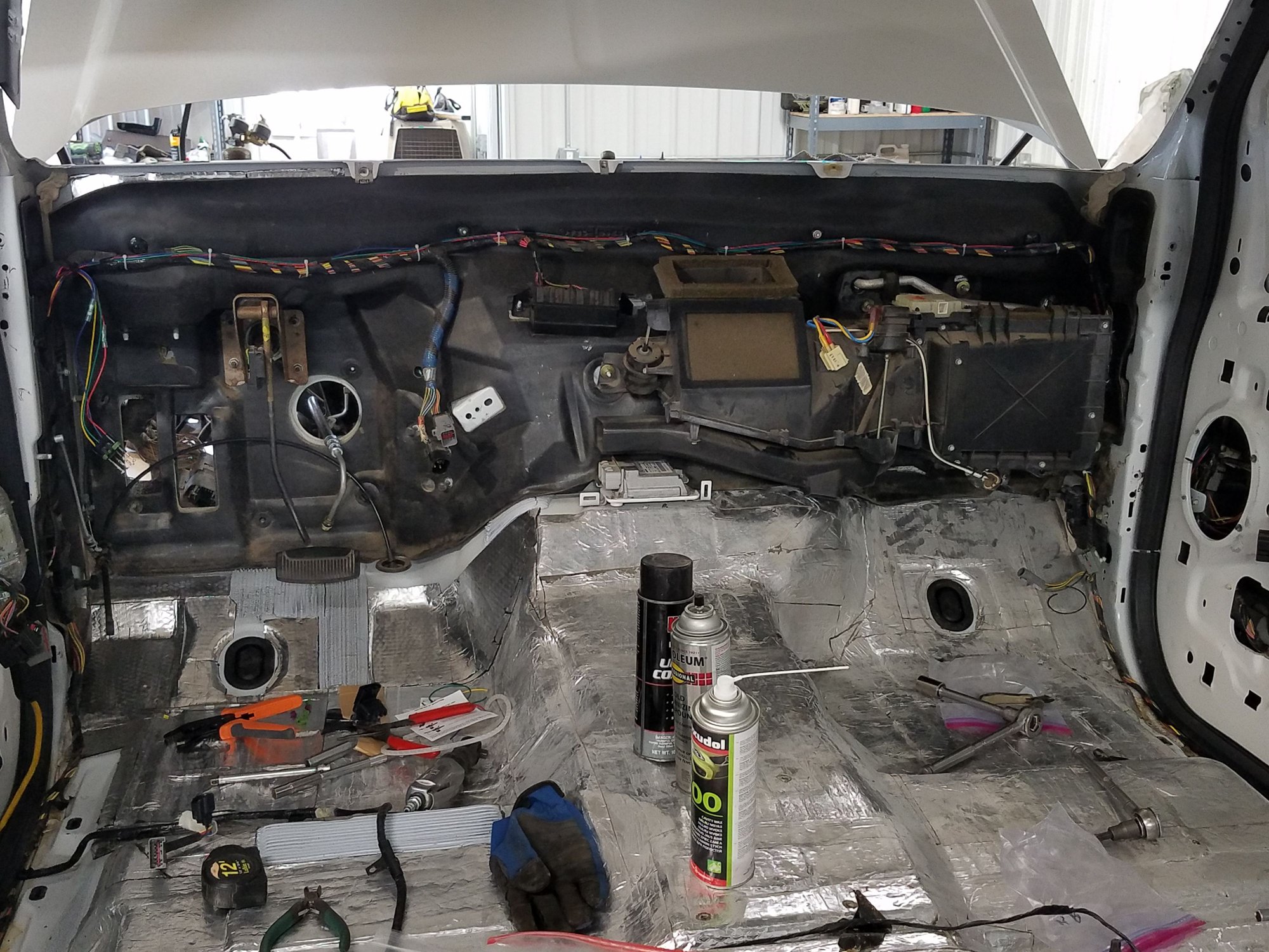

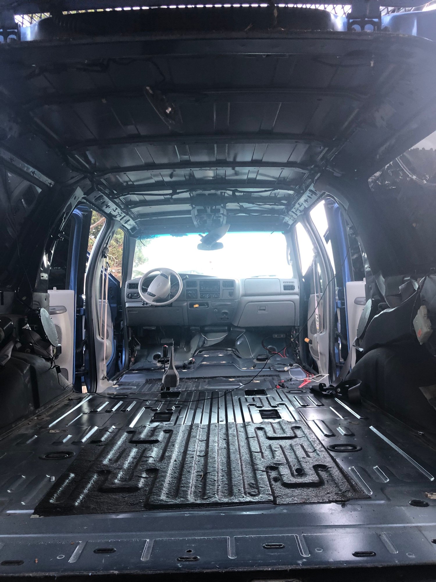

My '00 7.3L Excursion interior sound is extremely loud. I measured the level at highway speed using several different apps and they all came in at 92dB. I've already had enough hearing loss so I have started tackling the Dynamat installation project. Now I am confronted with the question of whether to try to remove the entire dash and lay Dynamat along the firewall. I realize that much of the noise in the cabin area is coming from the engine compartment, which would lead to me remove the dash. On the other hand, from what videos I have seen of the dash removal, it looks like a massive undertaking and I am wondering about the cost/benefit analysis. My impression is that removal and reinstallation of the dash could add a couple of days to the project. If doing such would significantly decrease the cabin noise level then I am all for it but if the results are negligible then I will forego the effort.
I will be putting down a layer of Dynamat throughout the vehicle, to include the ceiling, and then a layer of Dynapad in at least the cabin area. I already have installed the Dynamat Hoodliner.
I am sure that someone on this forum has tried the dash removal and sound damping installation. Was it worth the effort?
One Gutted Excursion
Laying the Dynamat Xtreme
Thanks,
Scotty
