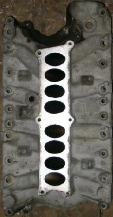

I see over and over that the truck EFI intake manifold set is a good one for general purpose light performance. I was wondering if that assessment includes the 1986 set up which occurred only on that model. Why would Ford ditch it after just one year? I don't know that this setup ever appeared on any other Ford engine.

Ford used the same upper/lower on the pickups from 1986 to 1996 on the 5.0's. Holley used to make a HP upper to fit that lower you pictured. And one other vender did as well.
I guess I posted without double checking. My cousin's '87 had a plenum with staggered round holes in it. Must have not been the original. Thanks for the enlightenment. This answers my question too.

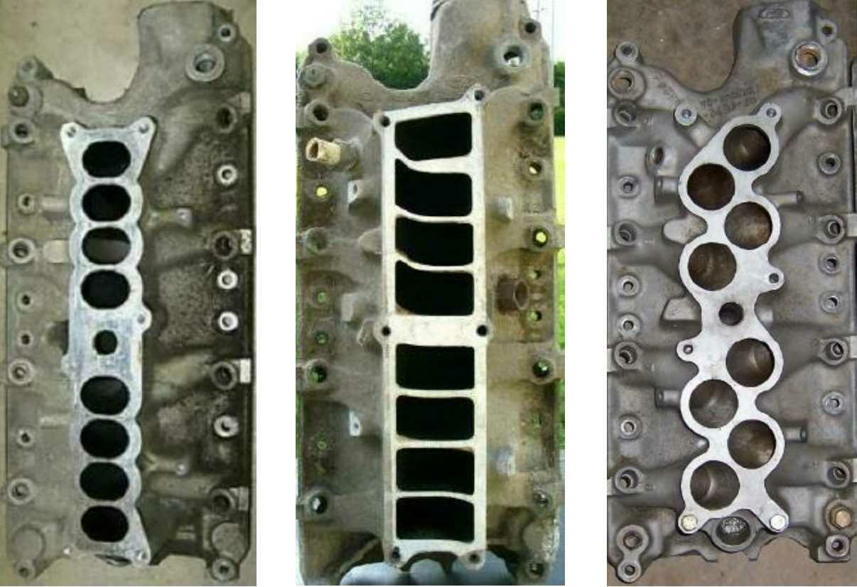

I have not posted this in a while. Here are 3 of the lower 5.0 EFI intake sections, left is the Mustang 5.0, middle is the truck 5.0, right is the GT40/Explorer 5.0
And yeah... the 5.8 EFI intake(below) is different again. LOL.. Why Ford, why so many?

The Crown Vic, Marquis & Lincoln used one similar to the Mustang lower.
