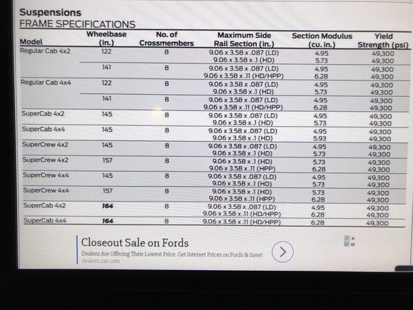

See the pictures below. My frame sticker says it is HD frame.
The axle sticker says it is 9.75B. What does it mean? is it a heavy duty axle?
Hypothetically, if I need to upgrade a few parts make my truck a HDPP to carry 300 extra pounds.
Other than the sticker, what parts do I need to upgrade/ swap?

Well quick observation, that truck wasn't optioned with 20" wheels. It also got the standard frame instead of the HPP. There is some difference overall but as you are finding the trucks lack payload. The HPP gives you more GVWR but Ford rates it for less towing. Ford uses a unicorn to advertise the 13,200. That truck is a STX 4x2 with max tow and zero other options. That gives you the required 20" wheels and all the frame upgrades along with max springs in a non HPP truck.

That is correct, no 20's means no upgrades. Just the "max tow package" it gets you what Ford calls HD Mini 145 frame. You also can't get max spring upgrades on a 145 wb regardless if 20" wheels are selected. Ford only does max spring upgrade to HPP frames. I will say there is a substantial difference in front sway bar size. You can change your order just fine if the vin hasn't been assigned.
Thanks 390 - We have a VIN and build is supposed to be 8/14, so no changing. The springs weren't a concern for us as we've already done a test with a friend's F150 and found a 2" drop draw bar makes for a level trailer and still some rake back to front on the truck. However, I would have liked the Upgraded sway bar and steering box (whatever that may be) - Always like to have more than I need! I should have considered just ordering the 20s and either up sizing the tires on them or swapping them with someone that has the 18s. Live and learn...

Reading between the lines here, does that mean there's a "regular" 145 frame and than the HD Mini 145 frame?
I know my weights really well, and between family, gear in the bed, and trailer tongue weight I'm never over 1800lbs, and usually around 1650 or so. I have seen some payload stickers in the 2000 lbs area, and that sounds ideal to me for sure. I know thousands of people are over payload rating, but I'd prefer to be a little under.
Old Aug 8, 2020 | 01:14 PM
ford390gashog's Avatar
ford390gashog
Joined: Jan 2004
Posts: 26,007
Likes: 575
From: Brentwood,CA
Only 2 frames available, Ford tags the frames 145 LD or 145 HD Mini.
