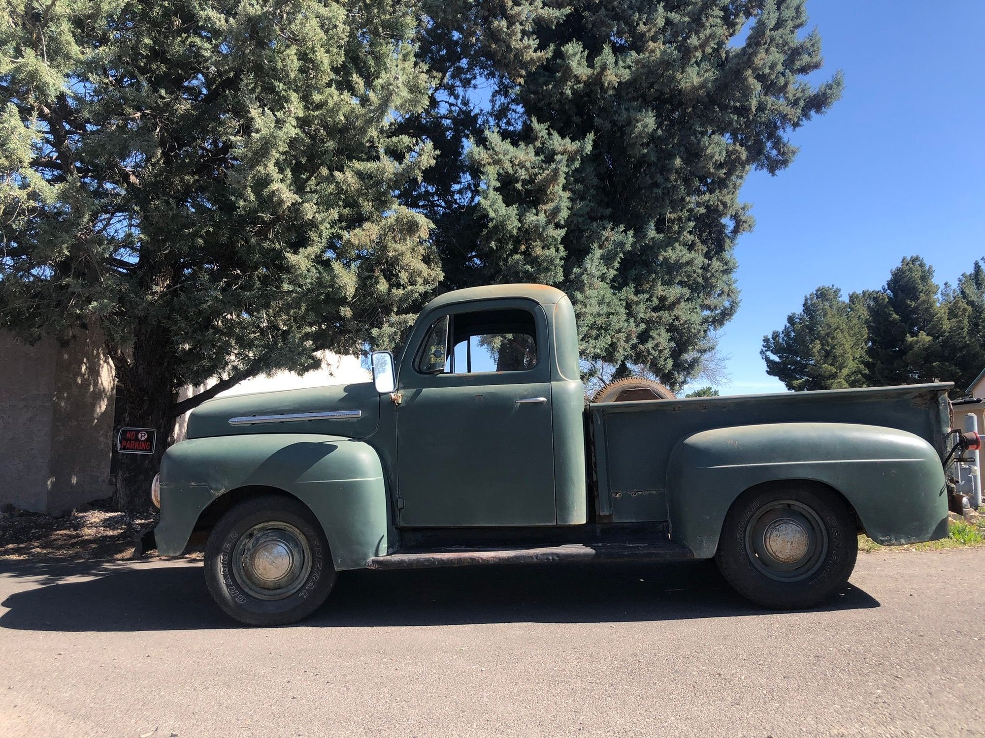

Hello everyone
Have put on about 1000 miles on my 1951 has received a motor out of a donor one town away
It was leaking a little fuel at the pump. When a mechanic cleaned up the fuel pump and tightened everything down and said it’s good to go
It drove two miles and it stopped running. I asked a friend to get some gas thinking maybe it stuck the fuel gas gauge or something
Poured in some gas and it was full within 3 gallons
However, being full already, it started and seemed to work fine and got home
Just asking that anyone can recommend something to look for as to what might have happened because it 108 degrees.
Its downright dangerous and I really would be into info
thanks so very much to all

Love your truck by the way. Anyway, assuming good fuel delivery.... Hot weather and a bit of elevation in Sedona and starts back up after a rest. Vapor lock?

Thank you very much on the truck
fuel delivery is so strong till this last issue and I go to Jerome at 5000’ just under an hour. Flagstaff is 7000 at the same just under an hours
this trucks gets driven almost everyday and is just slowed being driven since it came over 100 degrees here
would agree that vapor lock is could the leader possibly

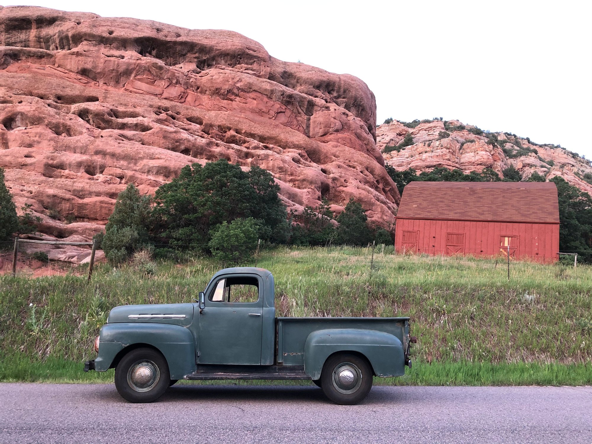

The shop and had it down to the carburetor as the issue, which was rebuilt and everything is back to reliable and solid
Thanks all for the help!

Thanks for the update and another picture. But remember some thought it might have been vapor Lock..... But wherever you are now, it's not 108° like it was when you first reported this problem. Where are you located anyhow?
