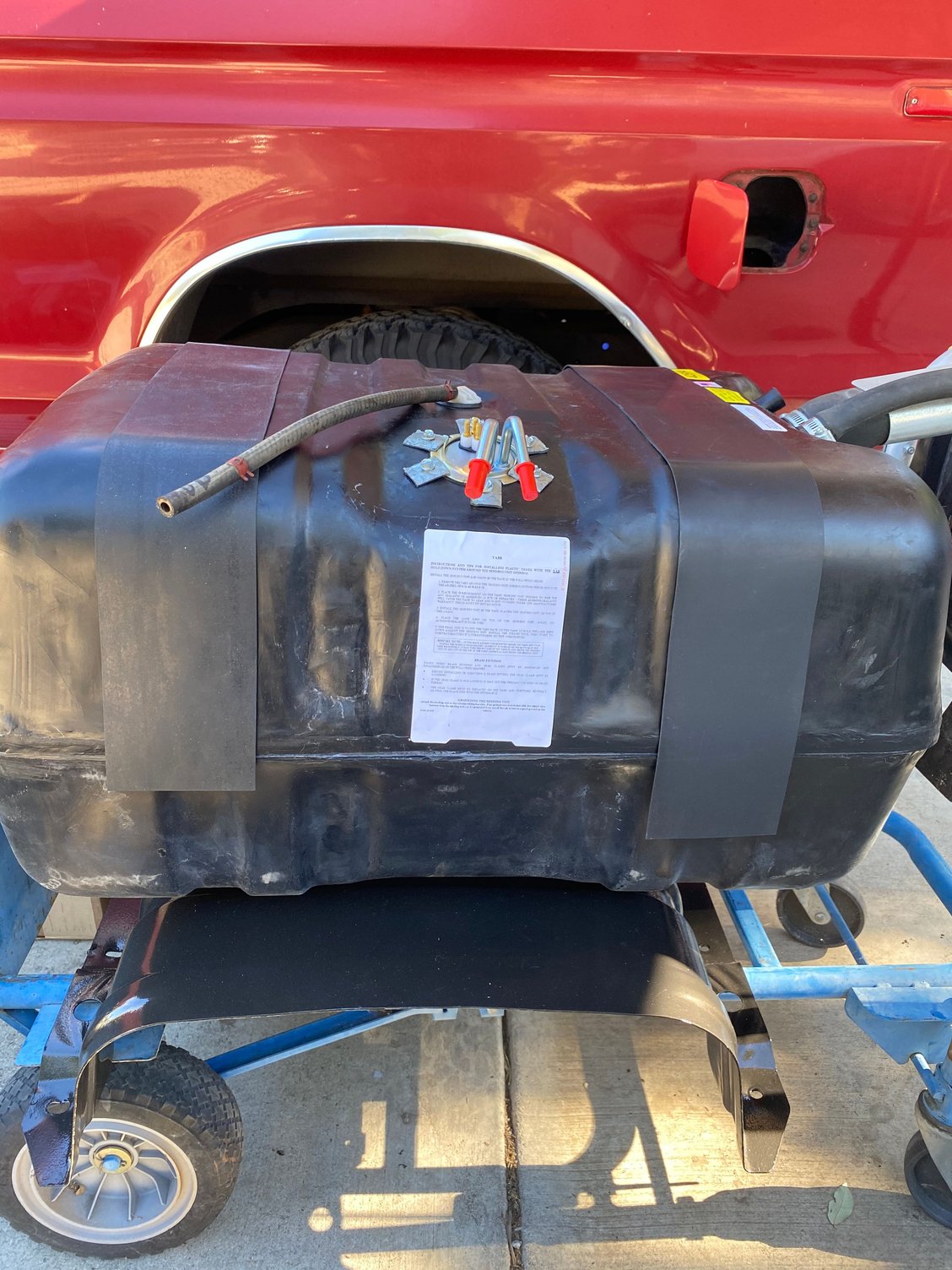

Pictures
33 gallon old sending unit and new sending unit with pump and return line. both 2" diameter mounting
New plastic 33 gallon tank with sending unit/pump installed.

Plumbing is all done, just need to do the electrical
The new tank is in.
