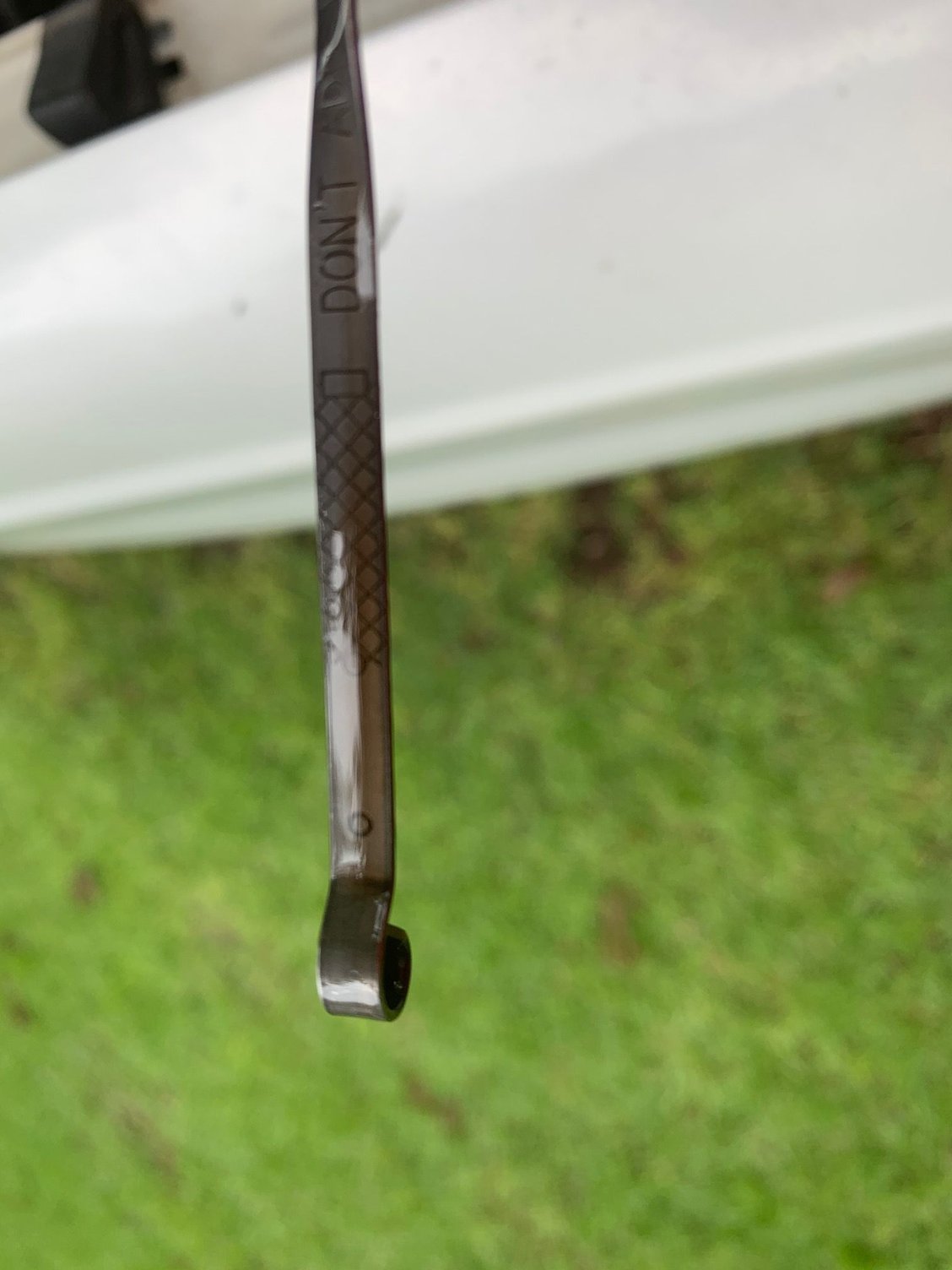

Old Jul 29, 2020 | 09:54 AM
Aviator_1's Avatar
Aviator_1
Joined: May 2020
Posts: 14
Attached is a picture of the transmission dipstick. A bit hard to see, but the fluid is pink and has a slight hydraulic smell.
At these miles, it would seem that someone has serviced the transmission.
Thanks,
Dave
Old Jul 29, 2020 | 07:38 PM
Djosbun's Avatar
Djosbun
Joined: Oct 2017
Posts: 1,704
Likes: 164
From: Southwest Ohio
I change my transmission fluid and filters once a year because I commute 100 miles a day. That's probably why I hold on to vehicles for 275,000+ miles, because they run reliably. Many people ignore the service intervals in their owners manual because they think it's unnecessary, or maybe they're just careless.
-- Dave
