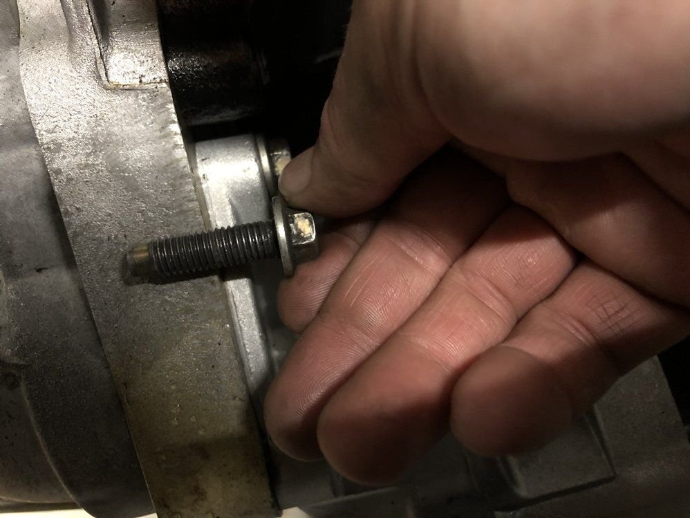

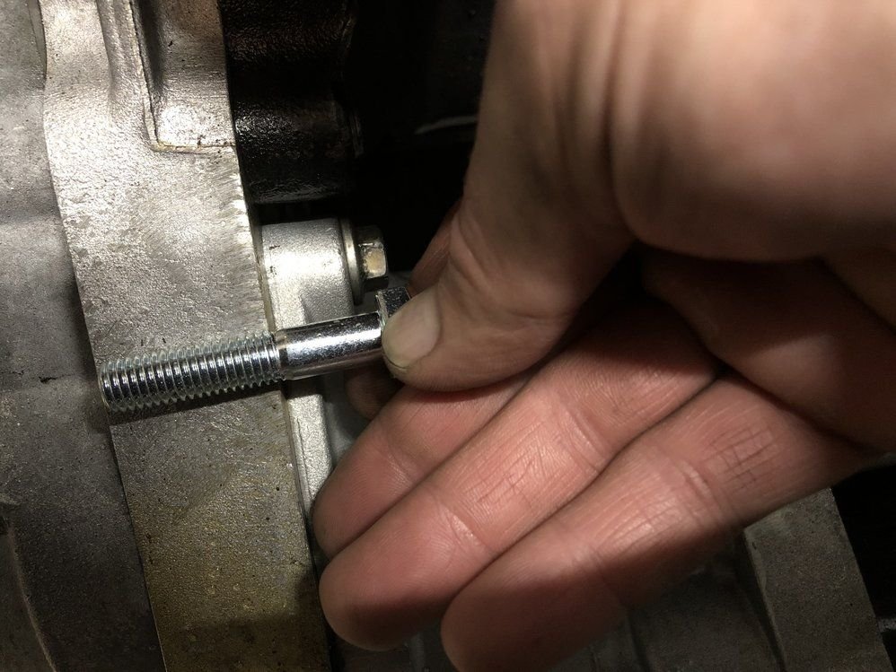

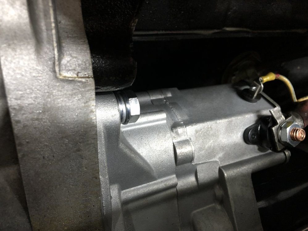

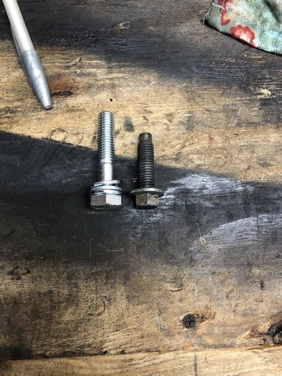

Youl have to flatten out and slightly moon shape the power terminal to the starter, and put a 90 in the control wire terminal.
buy m10x1.5 45(if you can find) or 50mm bolts and washers including lock washer. Its heavier and more of a pain than factory size starter but def worth it. It wont look like its going to fit but it does.

Pics from my 2003 thread
