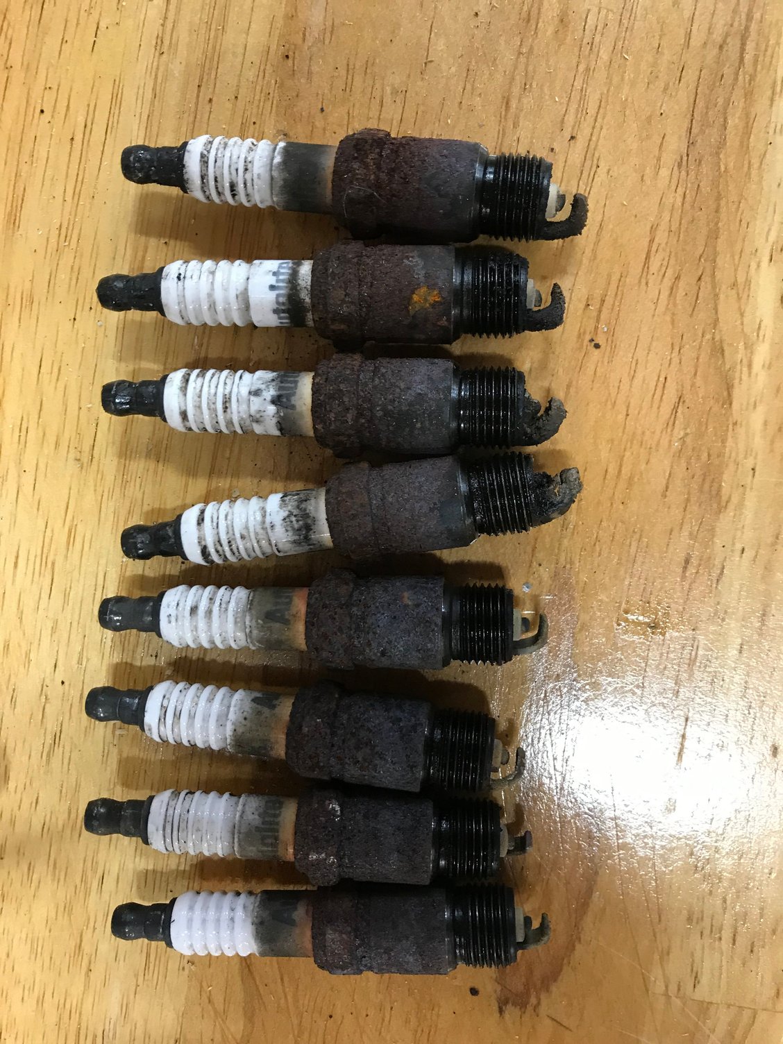

I changed the plugs on the truck yesterday and I am concerned with what I found. My thought is blown head gasket, but I'm not sure. All four plugs on the driver's side have a build up on them while the passenger side looked like your typical worn out plugs. The part that makes me think head gasket is the coolant was about a 1/2 gallon low. Are there other causes that would make the plugs on one cylinder head all have a build up while the other bank looks fine? Thanks all.

Top four are the driver's side. Bottom four are passenger's side.

There are lots of places coolant could leak out and to me those deposits look more like EGR or PVC deposits or maybe a bit of both. What holes were the two worst looking plugs from.. the rear cylinders right where the PCV is attached?

The PCV is on the passenger side, right? The bad plugs were from the driver's side. I don't recall which cylinders were the worst offenders.

The pcv valve is on the right side but it dumps the vapor into the rear of the intake manifold.

I have found that coolant leaks usually steam clean a spark plug. This looks more like fuel, oil, of EGR deposits.

did the truck smoke a lot when you started it up, after plug change, or do you still have a miss, with 2 being that bad

It runs great now. There is no smoke and no stumble either.
