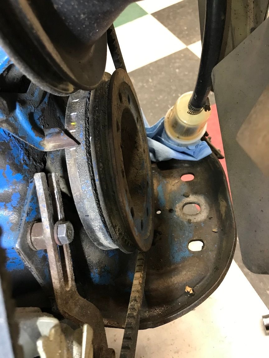

1) Use the "thumb method" as described above to the motor at #1 top-dead-center on compression.
My Y-block is currently out if the truck so I went and took pictures
Y-block at #1 TDC

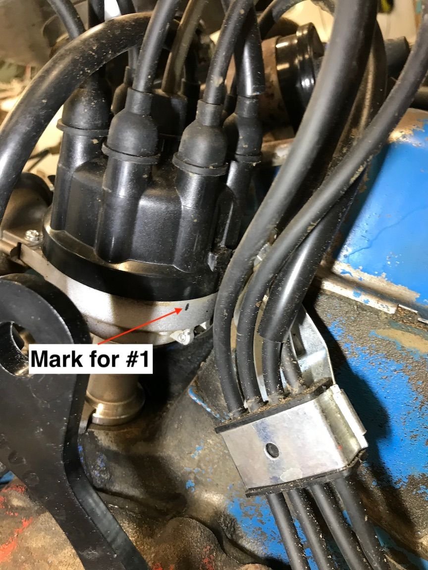

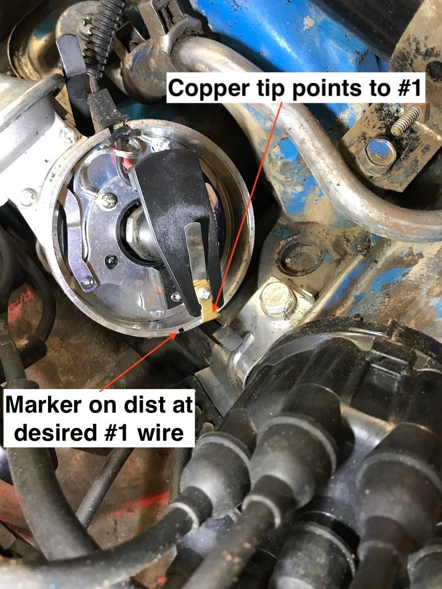

2) Pull the distributor cap and set the rotor pointing at your desired #1 plug wire location. On my truck I used a Sharpie Marker to show where the #1 wire on the cap lines up with the lower metal shell.
Rotor at #1 TDC on compression
3) Remove all the plug wires from the distributor cap and install the cap
( I say this to wipe the slate clean and get a fresh start)
4) Put the #1 plug wire in the designated #1 position which is lined up with the copper tip on the rotor
Cap in place, Rotor inside is pointed at the mark
5) attach the remaining plug wires following the firing order.

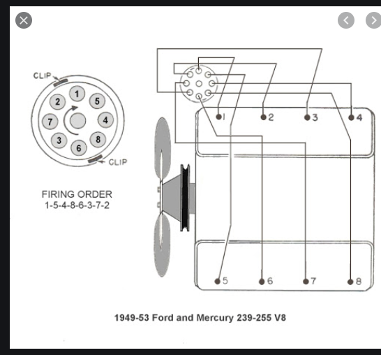

CAUTION: It looks like flathead distributors rotate CW whereas my Y-block rotates CCW !!
I THINK the picture below is correct but you need to double check.
1949-53 flathead firing order and distributor rotation
