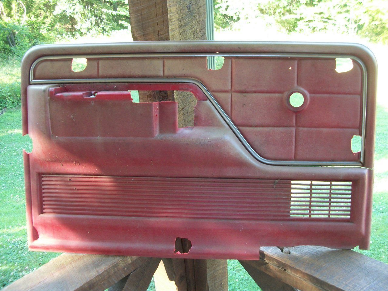

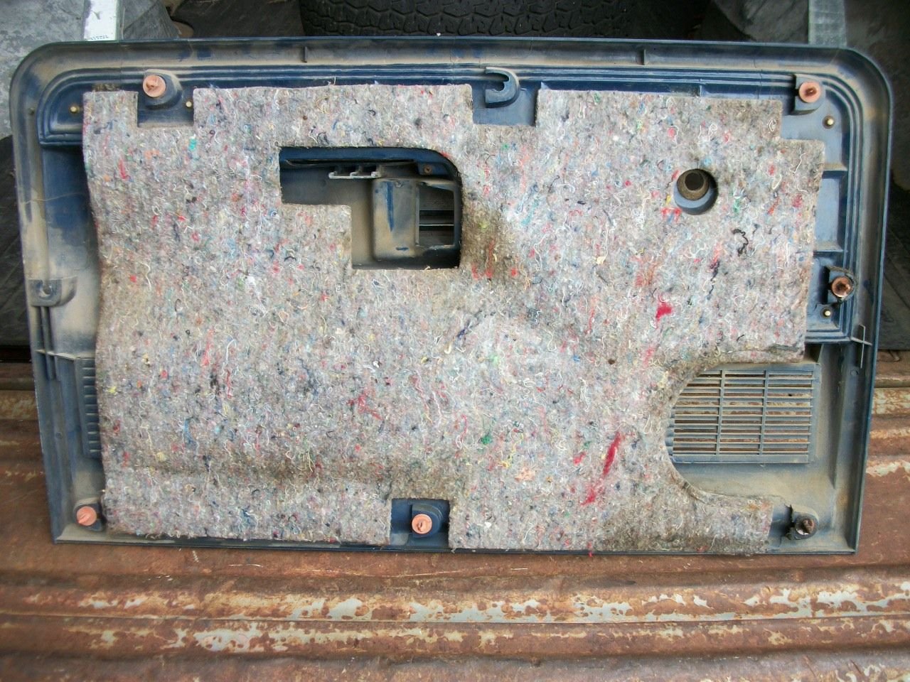

XLT trucks get the one with the faux wood grain vinyl overlay. Is your outer chrome piece plastic or metal? Yes those door panels have been hammered on with lots of none OEM screws to attach them to the door. I see BOTH arm rest pads are there. And yes the dvrs side is missing the vinyl overlay. See all the holes for the vinyl overlay mount studs?
X2 on door panels WITH the vinyl insert are NOT reproduced. The vinyl insert itself is NOT reproduced either. They are held on by a number of very fragile plastic studs that goes thru the door panel, and then a star washer is pressed on that.
When removing the star washer (even cutting it with a Dremel) to attempt to remove and save the vinyl overlay (to reuse) the studs can break very easy. Especially when you try to reinstall them on the new door panel even if you use a new star washer.
Now some door panels have just a metal trim ring (see red panel) like the plastic one used with the wood grain (and those are reproduced) and they are held on with a metal bendable tab on the back side. Maybe an option for you?
Here you can see the small washer/stud (the white piece by the main mount buttons) and the metal trim and tab.

Try using a dremel to cut the washer off. Double sided 3M tape to help make it stay? There are a couple of FTE members that repop them on their own. I'll try to locate their username's. You will not find the plastic chrome strip reproduced anywhere. So ebay or FTE classifieds is it. Like I said, the metal one is reproduced.
