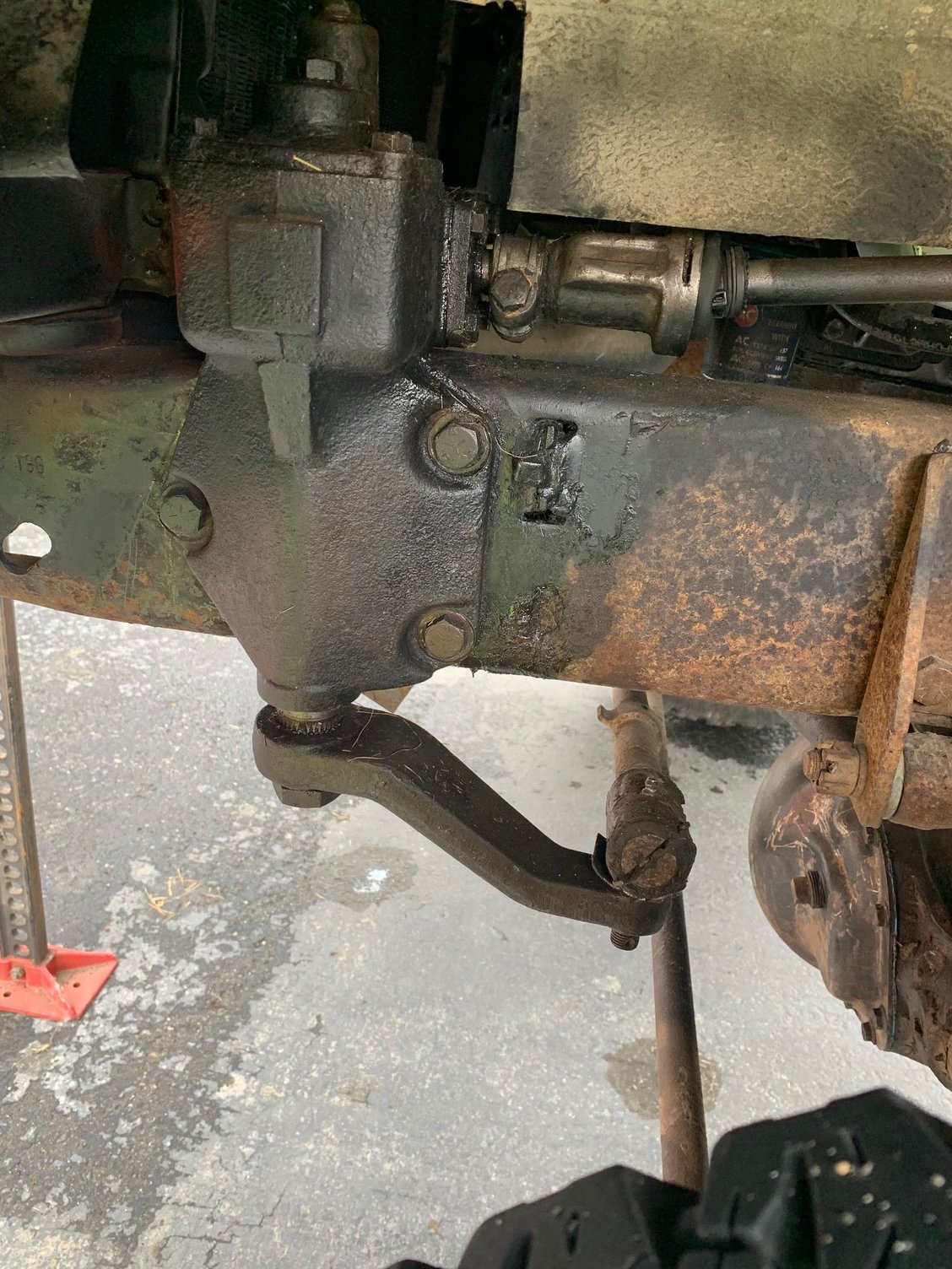

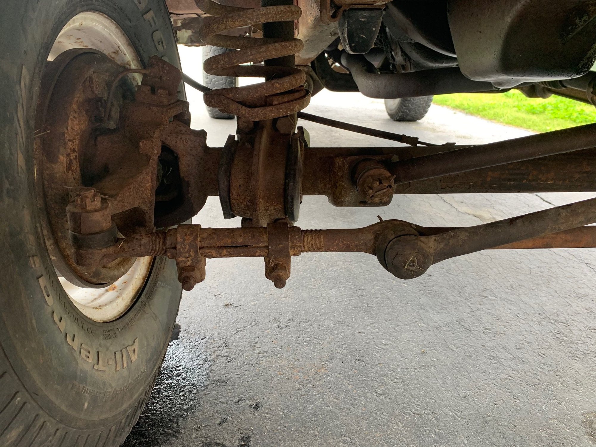

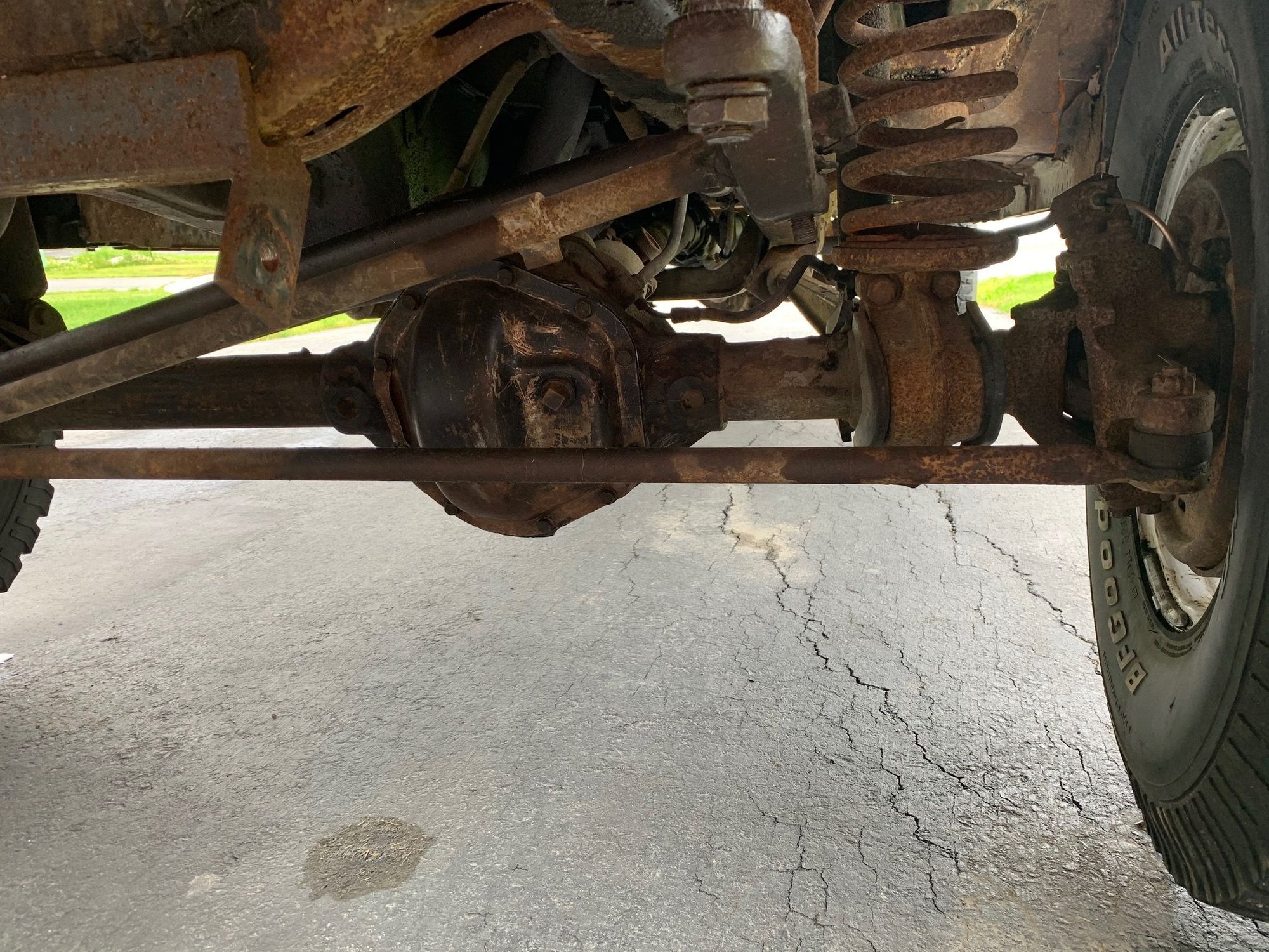

So I've been researching parts/repair for a truck that I was told is a 71 F100 4WD, but as I dig deeper it seems like it may be a 250... Per the VIN it has a 360 in it, it has a 390 sticker on the valve cover, so I know it's a 360/390. My issue is finding parts for the manual steering, the F100 steering box shows a tall thin structure, whereas the 250 shows the flatter, shorter one
Steering box
Passenger side
Drivers side
. I will try to attach pictures to maybe get some help. Every part with a grease fitting, I need to replace, I just need help finding out what exactly those parts are. I have rebuilt engines before, but have little experience with steering/suspension.

Your vin is correct. You do have an F-100 as they have a coil sprung front axle. The steering box outputs under the frame rail. An F-250 has a leaf sprung axle and the steering box outputs horizontally through the side of the frame rail. A good place for axle and transfer case parts is Torque King.

That’s no F-250. Stock steering box for a 67-77.5 F-250 4x4 is nothing like what you have pictured.
Other clues show a coil spring front axle, an open knuckle Dana 44 and crossover steering. Seems to be all correct for a F-100.
