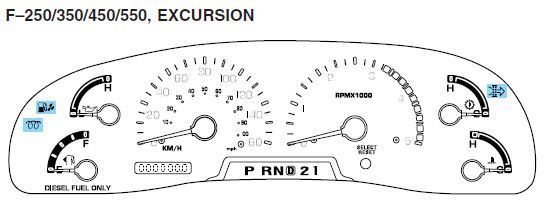

New to this group and the diesel world so redirect me if there’s already a thread on this. But I have a 2003 f250 with the 7.3 do these have a wait to start light? Mine doesn’t have one at all not even when I turn the ignition to start position. I have just been waiting and kind of guessing everytime I start it.

Hello Austin and welcome to FTE.
Is this what your dash looks like? I think the wait to start indicator is labelled 26 on this diagram.
I looked and I do have that symbol it goes off almost instantly after I turn the key to the start position.
