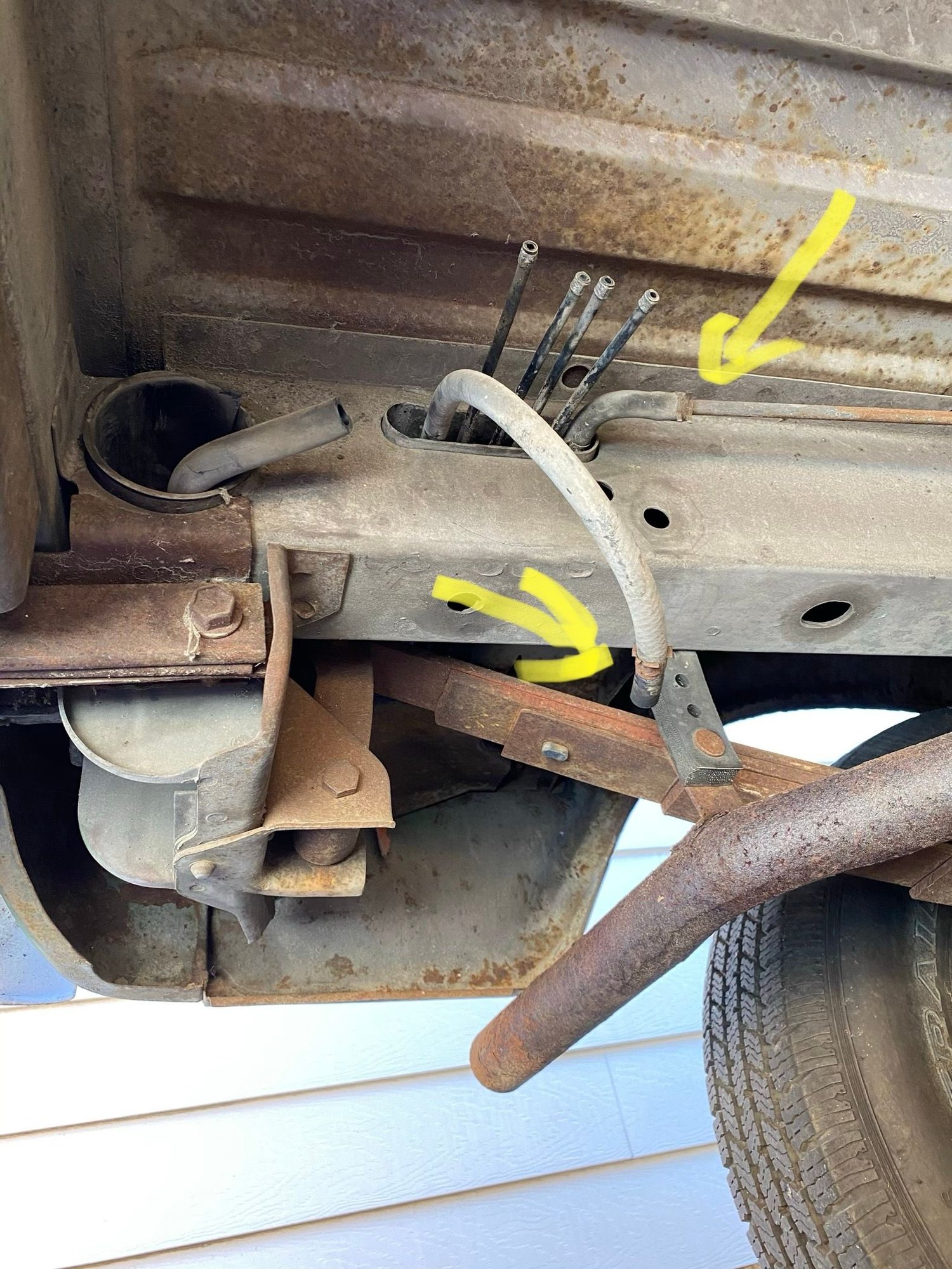

Does anyone know what these two extra lines are
Does anyone know what these two extra lines are? This is in the back of the van on the driver side, above the gas tank. The four lines are the emissions lines that go into the gas tank, but I don’t know what the other two are for. I assume one is to send vapors to the charcoal canister, but what is the other one for? Anyone? thanks

Might be filler overflow?

Don’t think that will make a difference in this case, but it’s a 1970 ford e100 econoline w CA emissions system

I would think it could be one line to the charcoal can and one line from the charcoal can to atmosphere.

where are the other ends of the lines you ask about?

Can’t see where the lines lead... behind a metal plate

Did you happen to take any pictures of the gas tank after you removed it from the van? Perhaps it has some connectors that would be helpful in someone identifying where the lines go.
None of those lines run straight through that steel channel/frame?
Do all of the lines run forward towards the front of the van, inside of the channel/frame?
They have to exit somewhere.
Again some more pictures backed away from the hoses would be good so we can get a better idea of the area. Some pictures on both sides along that whole metal frame would be great
