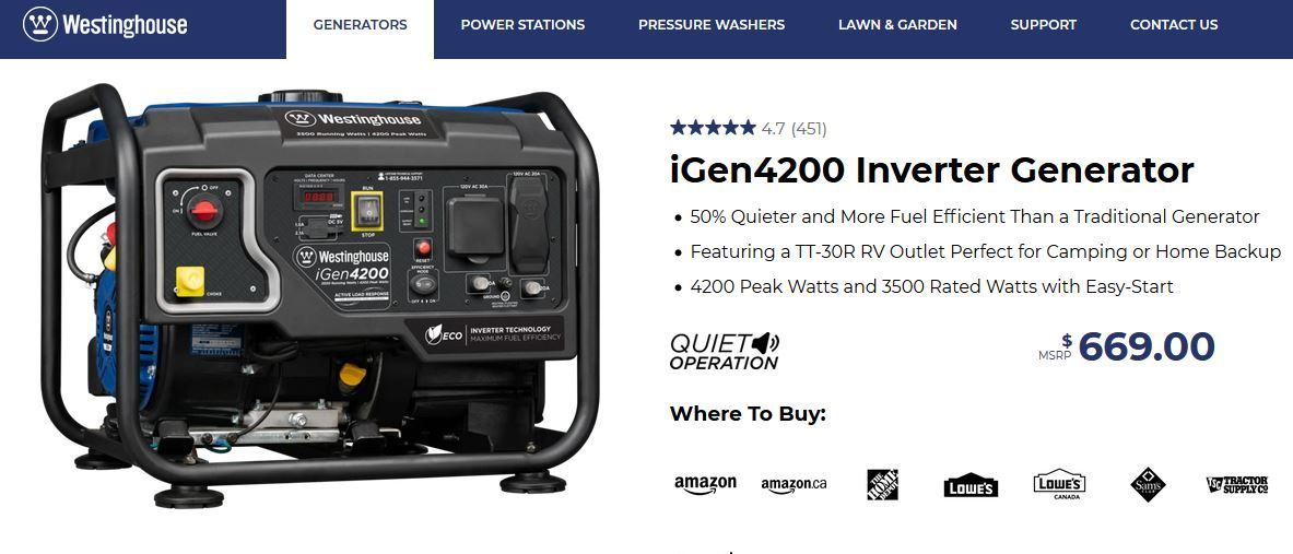

I have been using this Westinghouse iGen4200 Inverter Generator. It's pretty quiet by my standards and runs my camper without any issue.
