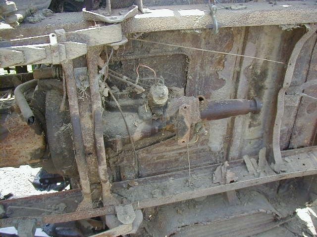

I took one out of a 60 truck with a 223. I got the truck from the original owner who said he bought it that way. Mine also had that spot for a cross member but didn't. Here is a pic of the day I got it.
