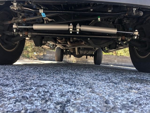

Pmf dual stabilizers with the cheap bilsteins. Everything fit well, easy install, two hours max and that's if you're super careful. I put another brand on my 2011 when I developed death wobble, solved the problem. This time I went PMF, even a better quality install, Price is right, I'll never get death wobble on my 2018 as long as I keep fresh stabilizer shocks on it. And once you start getting death wobble it stretches and wears the crap out of everything super fast.

Old Jul 14, 2020 | 03:30 PM
