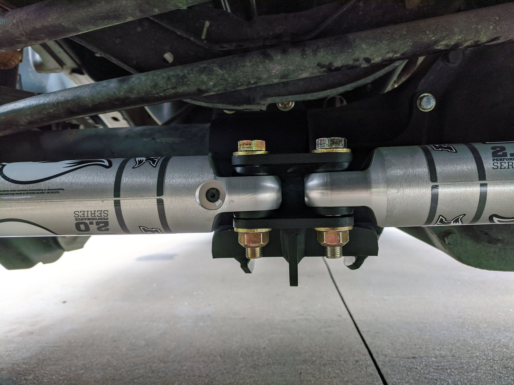

Here’s a few pics. Had the wife turn from stop to stop a few times while I watched for any binding or clearance issues but it’s all good. Took about 3 hours but that’s with a 3 yr old helping. If I was alone I figure maybe about half that time. Hard to get anything done with a constant Dad......Dad......Dad......Dad.....Dad......Dad... ...Dad...... going on!

I wonder why some are using the spacer as mine lined up just fine without it and I used the stock bolts to attach it as per the directions.

It’s been a few days and no leakage. The length of the bolts in the kit were just about the same as the originals plus the thickness of the bracket and spacer so they are perfect.
It’s gotta be axle related. If I hadn’t used the spacer, the clamp would have been cocked off at an angle on the axle housing. Using the spacer made it fit nice and flat. Don’t know which axle comes in which config but mine is an F250, 6.2.

I spoke too soon in that last post. Noticed a hanging drop under the diff this morning. Pulled the bolts out, top one was dry, bottom one was wet. Blew out both holes and gave the bolts a dose of RTV gasket maker and torqued to 45 lb-ft. We’ll see how it goes! Other than that, still super happy. Truck drives better than it did when I drove it off the lot.

I finally got around to installing my Kelderman bracket and Fox stabilizers.
yeah the directions or the lack of clear installation instructions is really poor. I appreciate those that took time to post pictures in this thread. Helped me a lot!
in particular, I was a little concerned by the brackets for the outer shock mounts. Whatever that bar is, it rotates when installing the outer mounts. I took a level and put it on top of the center bracket over to the outer brackets and tightened them down. Drove the truck and it handled and rode fine.
I have not had any death wobble, but I’ve definitely noticed a lot of bump steer. Only have 3000 miles on the truck so it’s hard for me to really notice a huge difference. But I will say even the bump steer is improved. I don’t think the stock stabilizer was totally shot. I am glad I have preemptively installed this kit, it is impressive and a quality part. I did remove the stock steering stabilizer.
