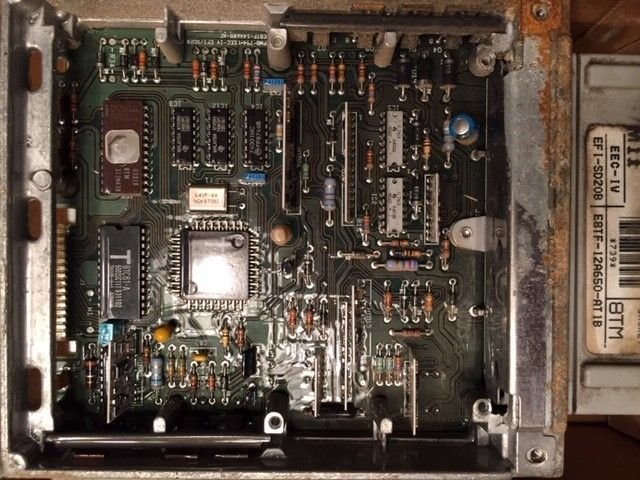

Pulled the ecu and here is a picture. Looks clean to me, and the blue capacitor doesn't appear to be bulged on top, but I'm no expert. Can you detect anything out of sorts? My tranny is the ZF 5, so code 98 might be a hard ecu fault?

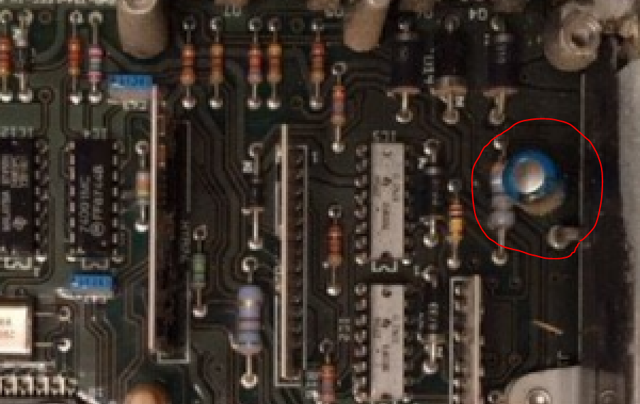

The Blue capacitor looks suspicious. I can't enlarge the picture enough to see the fuzzy white stuff under and surrounding it.

Does it look more like this?

Scndsin....Ewwww

Yeah, whole cascade of crap started with those damn things.

I have access to a 1990 F350 (460 V8) free of charge, is it worth the trouble to substitute it for the '88 ecu to help determine if it is bad? I understand that I have to take it to the dealer to get the VIN written to it (assuming I can find a dealer who will do it)?

That 1990 PCM will work as a suitable test/replacement as long as it has the same transmission as yours. There is no programming for this vintage PCM. The VIN is not tied to the PCM in any shape or form.
