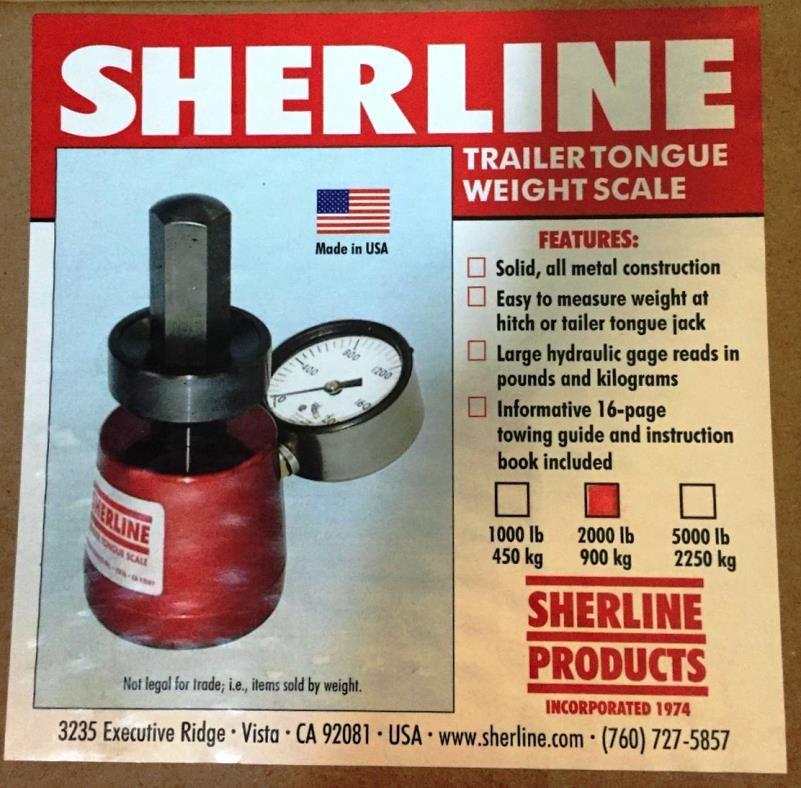

I find a tongue weight scale is quite convenient. A clever machinist solved the problem of determining trailer tongue weight a couple of decades ago by inventing the Sherline scale, which is a small hand hold able hydraulic device that has a piston surface area that is exactly 1 square inch, along with a 0 to 2000 psi gauge. Place the device under the trailer coupler, and read the pounds per square inch on the gauge, and voila, tongue weight. Actual tongue weight, not some 10% assumption... which can be grossly inaccurate once a trailer is loaded with personal belongings.

Anyway... consider getting a tongue weight scale. One doesn't have to get a Weight Safe brand hitch to get a good handle on knowing (not guessing) tongue weight.
