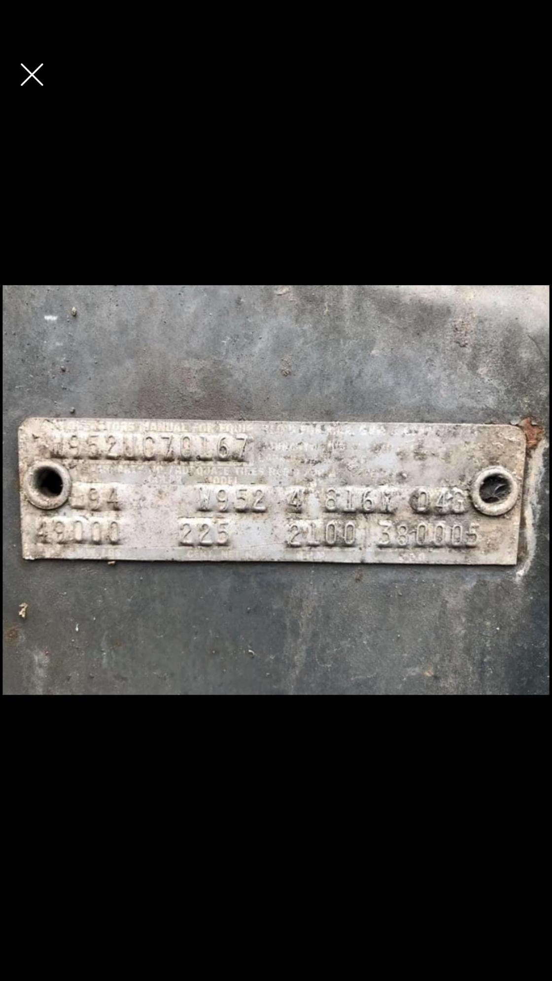

IF the last 6 digits of the VIN are C70167, this is a 1967, not a 1968. Warranty Plate is filthy, very hard to read.
194
W952
816W (W?)
D4G
49000
225
2100
38005

Originally Posted by Mexibilly
I just bought my first NT950 and have been trying to decode the Warranty Plate.
W95 = NT950 Diesel. The T refers to tandem axles.
2 = Detroit model 6-71N 6 Cylinder 426 cid Diesel.
U = Louisville KY Assembly Plant.
C70167 = 1967.
194" Wheelbase.
COLOR code = Blank, truck painted a non standard color, making it a Domestic Special Order.
W952 = NT950 Diesel, 49,000 lbs. GVWR
4 81 (6W is the TRANS code) // 4 = Medium Beige Crush Vinyl & Medium Beige Wicker Pattern Vinyl // 81 = 81A Standard Cab.
6W = Dana/Spicer model 6352-B 5 Speed Direct.
D4G:
D4 = Timken model SQHDA Forward Rear & Timken model SQHDR Rear Rear / 5.29-1 / 38,000 lbs. Axle Capacity.
G = Rockwell/Timken model FF-903 12,000 lbs. Capacity Front Axle without Center Point Steering.
49,000 lbs. Gross Vehicle Weight Rating.
225 net HP @ 2,100 RPM
380005:
38 = Pittsburgh PA Ford District Sales Office, where the original selling dealer ordered the truck from.
0005 = Domestic Special Order number, truck special ordered by the original purchaser, not "bought off the lot."
Post #22: Thanks for the help, Ed. One can blow the pic up, but when one has nearly 76 year old eyes, that may not help.

Thank you so much. I really do appreciate your help.
